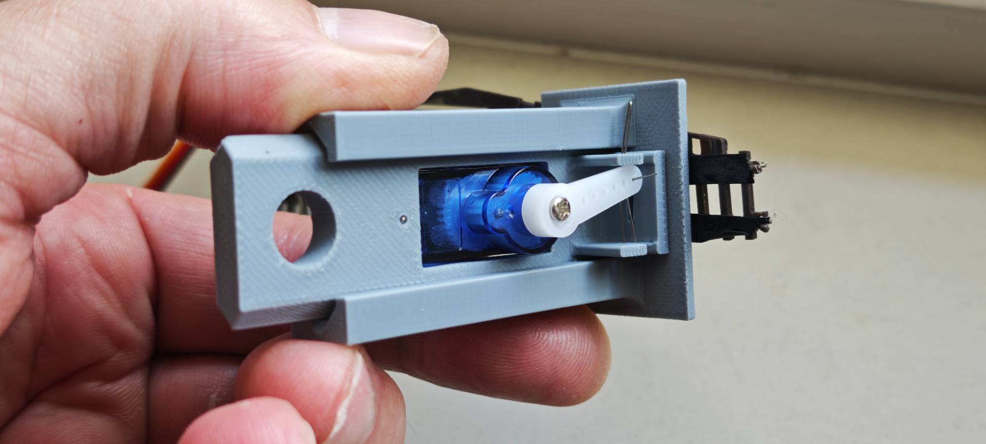

For those that want to remove the horrible black block from Märklin turnouts there are several options to mount servos.
This is my take on the subject. I like the servos placed on a drawer that slides into a bracket fixed on the layout. This simplifies maintenance and replacement of the servo unit.
The latest version of this concept is now presented.

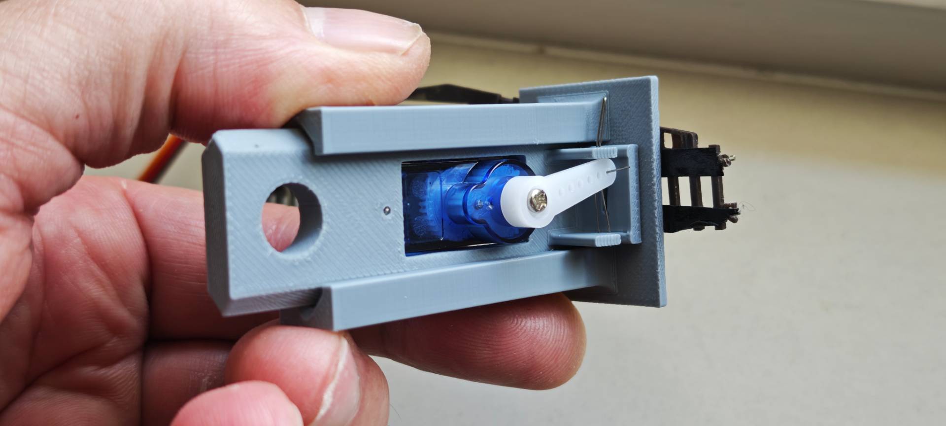

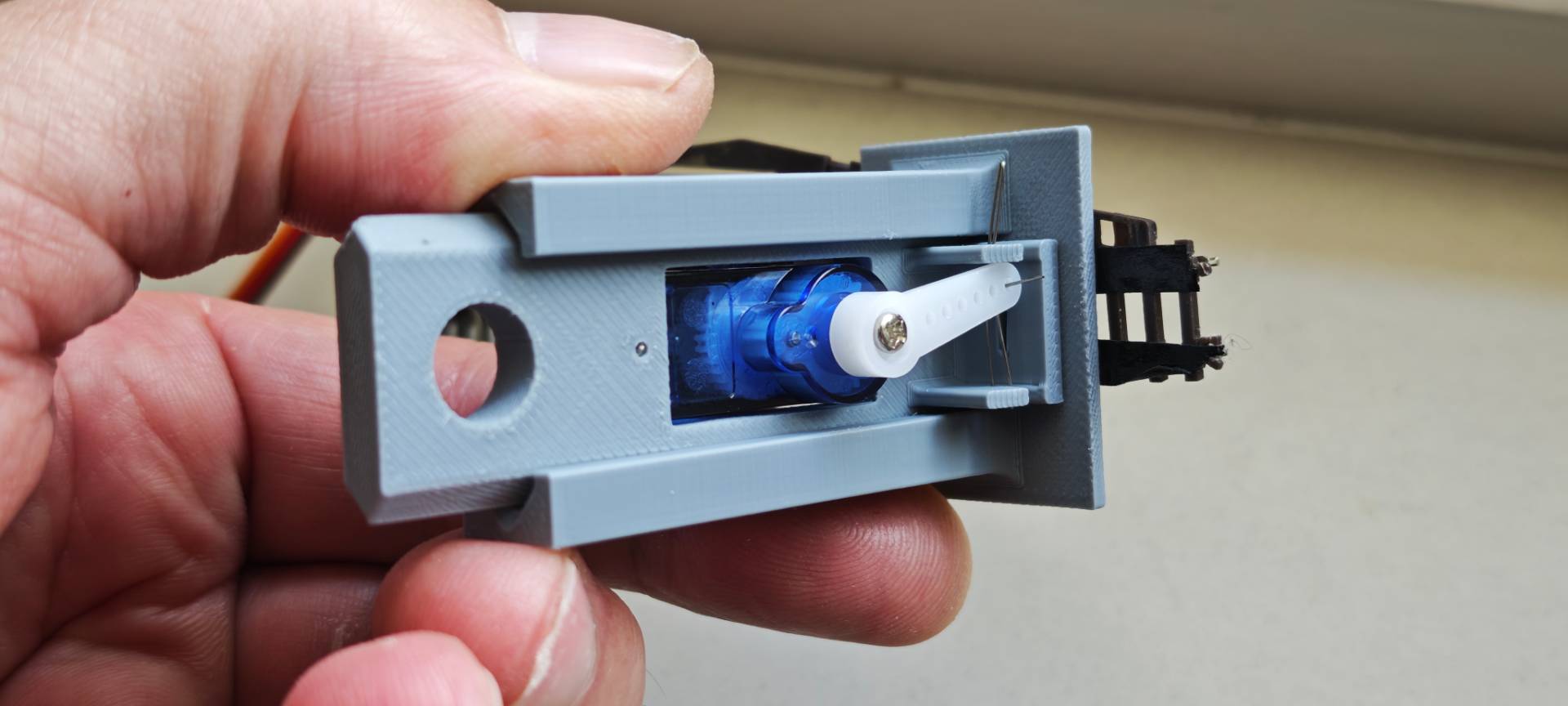

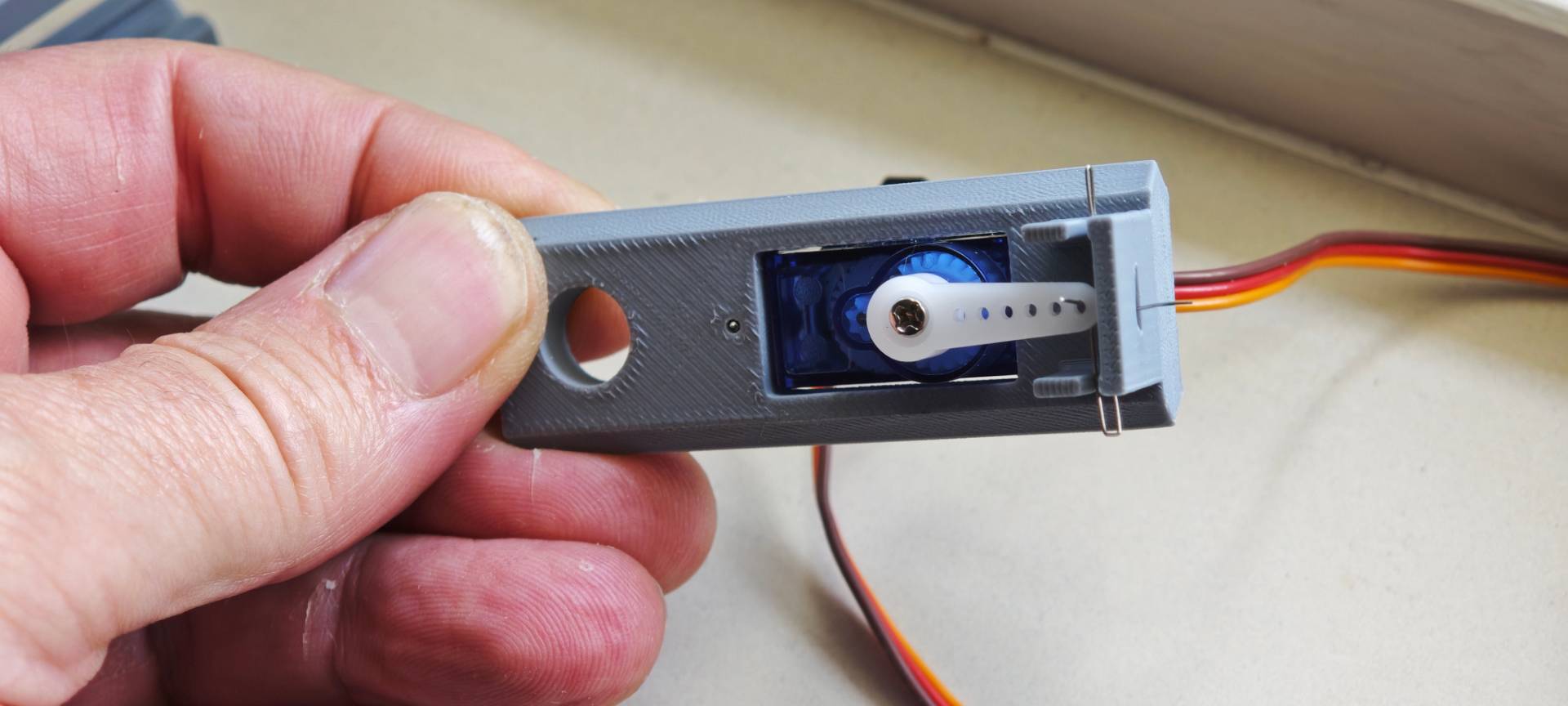

Servo and springy element inserted in drawer

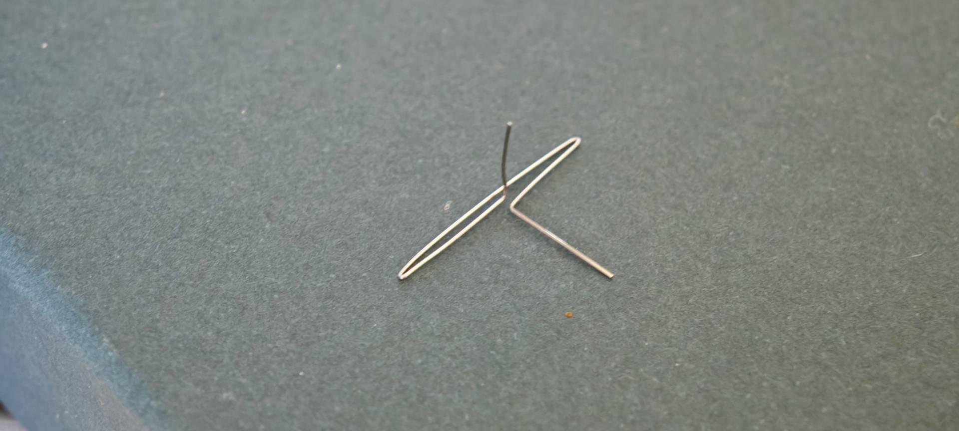

The servo is bolted to the drawer. A springy element inserted in the drawer, the tip that will engage the turnout bar goes in top slot, the two arms go into the parallel slots and the remaining tip goes in the servo arm

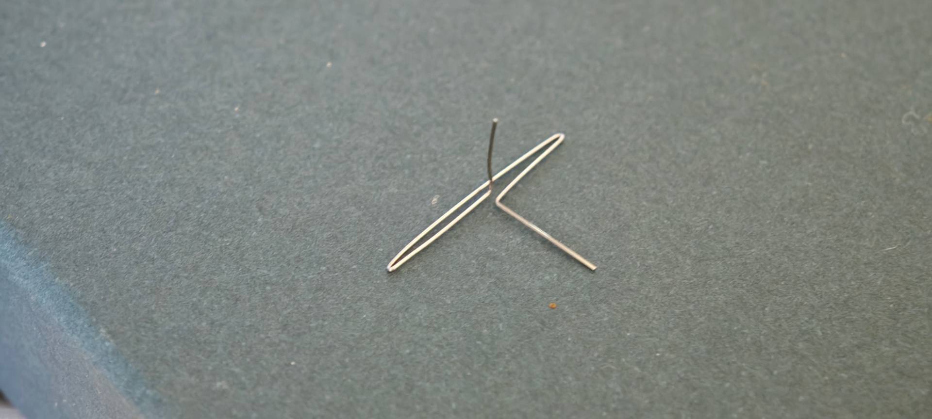

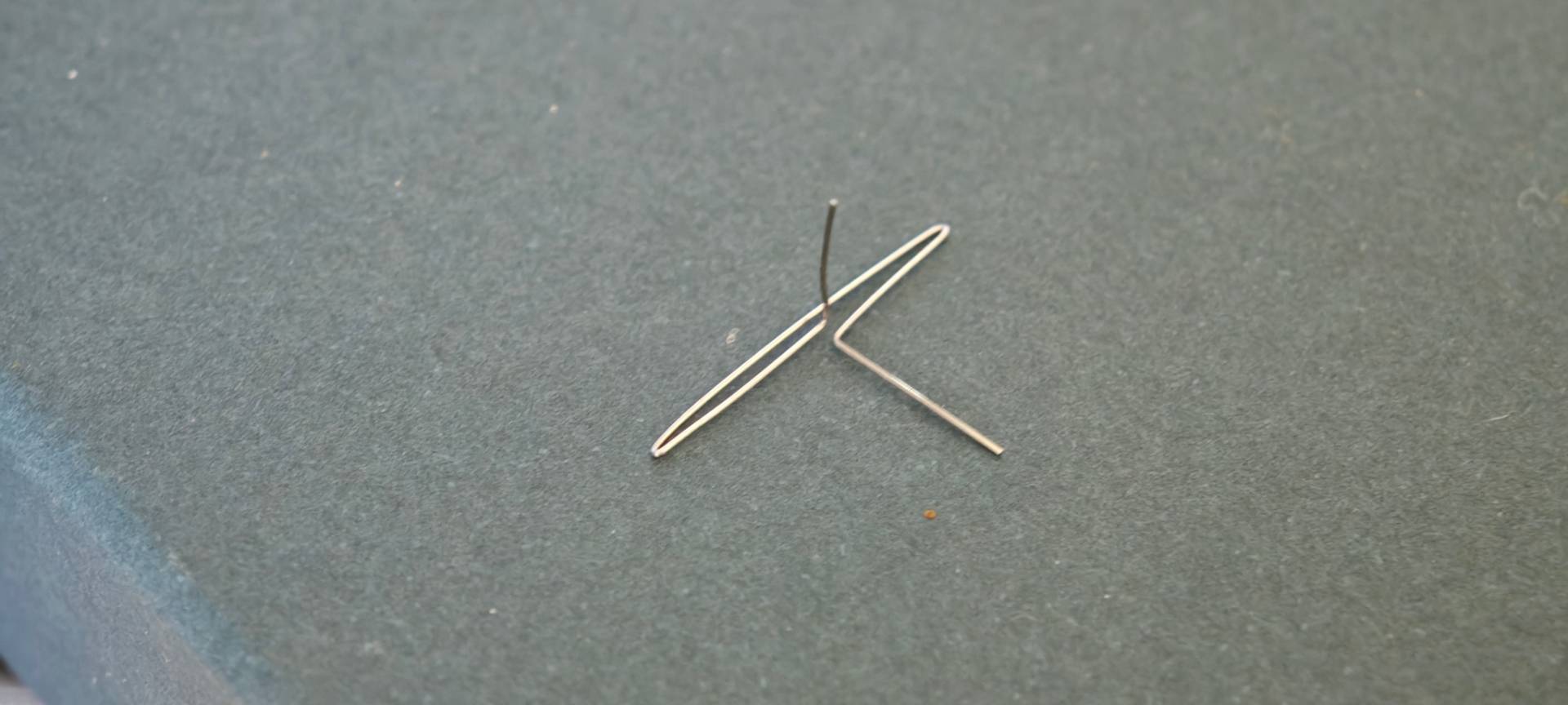

Wire folded in a springy element
The springy element is just made of 0.3 steel wire folded in a T shape (starting from the vertical part) with the last fold of the wire sticking out of the plane at 90 degrees

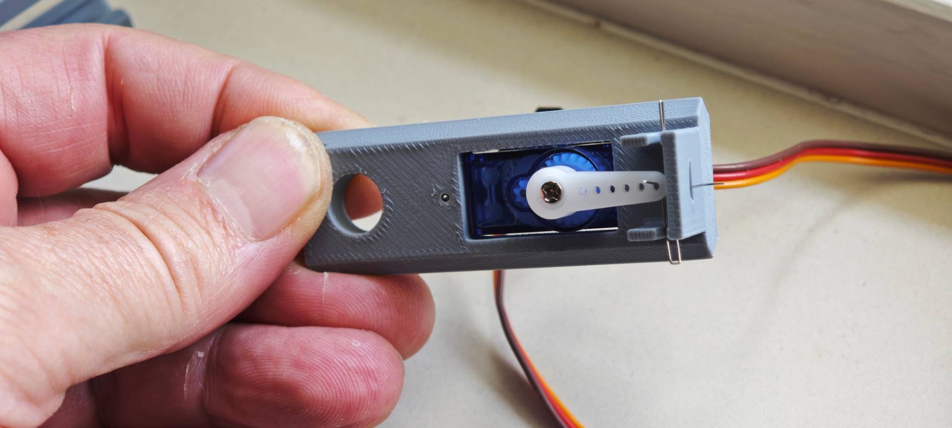

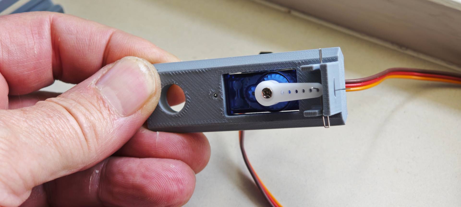

drawer inserted in the bracket
The drawer can be slid in and out of the bracket
Here is how it works, with a Märklin turnout that had a 0.5mm hole drilled in the throwbar and a 3 mm slot drilled under that hole
Drawer and bracket were printed in PLA filament with a 0.4mm extruder
