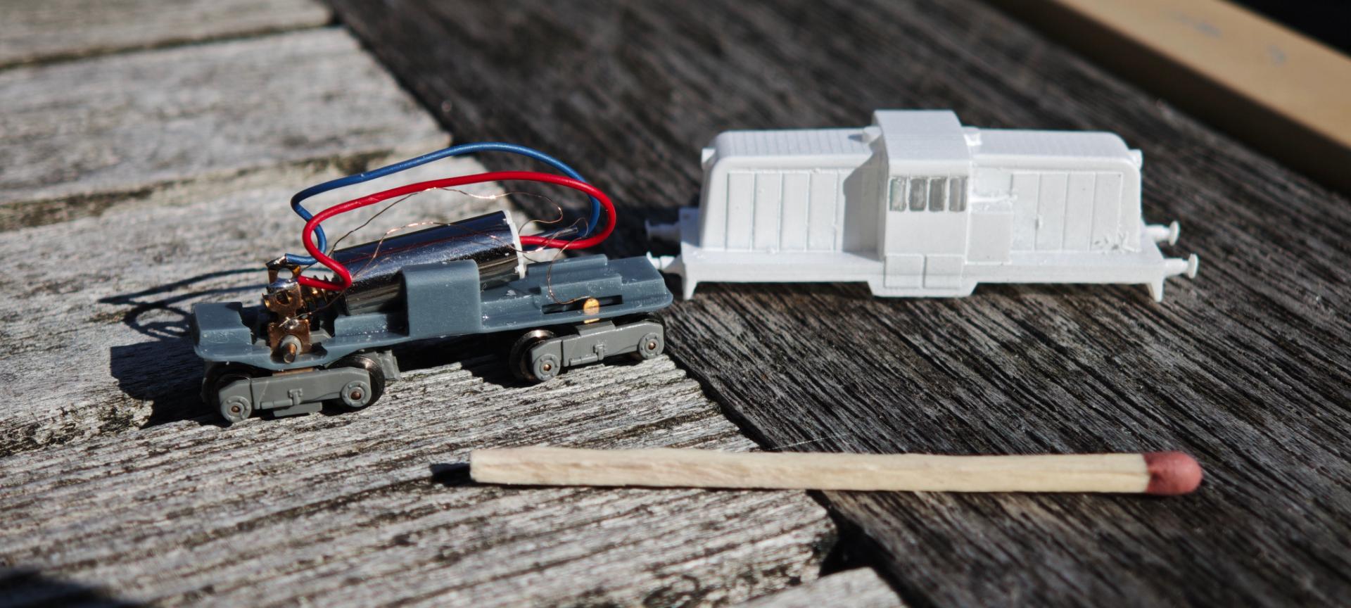

Part list:
B600
- 4 Märklin wagon wheelsets
- 2 M1 6mm countersunk screws
- 2 M1.2 0.5mm thick washers
Gklm
- 2 Märklin wagon wheelsets
1100
- 1 shorty motor unit (better the shinkansen type)
- 1 Micromotor.eu 615S. motor
- 1 08 id 1.0 od brass tube (Albion Alloys)
Building instructions:
B-600:
1) snap wheelsets into bogies, make sure they roll freely
2) screw bogies into chassis the chassis columns (washer between bogie and chassis column)
3) insert chassis into shell
Gklm
1) snap wheelsets into conical bearings
1100
1) remove all parts from shorty. Cut thin copper wires from PCB. Preserve thin copper wires connected to geared bogie
2) remove worm from motor with gear puller
3) fit brass tube to the worm, trim tube and insert worm into 615 motor
4) insert geared bogie into chassis
5) solder thin copper wires to ungeared bogie. Wires must go through cuts into the chassis, screw ungeared bogie to chassis
6) slide 615 motor into its craddle
7) solder motor wires to the top of the geared bogie pick-up, here is how is should look like 8) reuse shorty ballast brick by gluing 2 under the roof of the shell and 1 under the chassis belly.
9) insert chassis into shell (tight fit)
additionally, if you want to use the bogie sides:
3.1) file the bogie sides of the shorty so that they are completely flat
3.2) glue the resion bogie sides to the shorty bogies
B600
Gklm
1100
B-600:
Gklm
1100

Re: Small CP train of Allentejo
See message I was writing while you inquired. It uses most components from a shorty. Not the motor though as this last was too thick to fit into the correctly scaled hood.AnderTrains hat geschrieben: Do 13. Aug 2026, 13:19 Thanks for your work.
Is it designed to fit Rokuhan's shorty chasis?
Best regards
