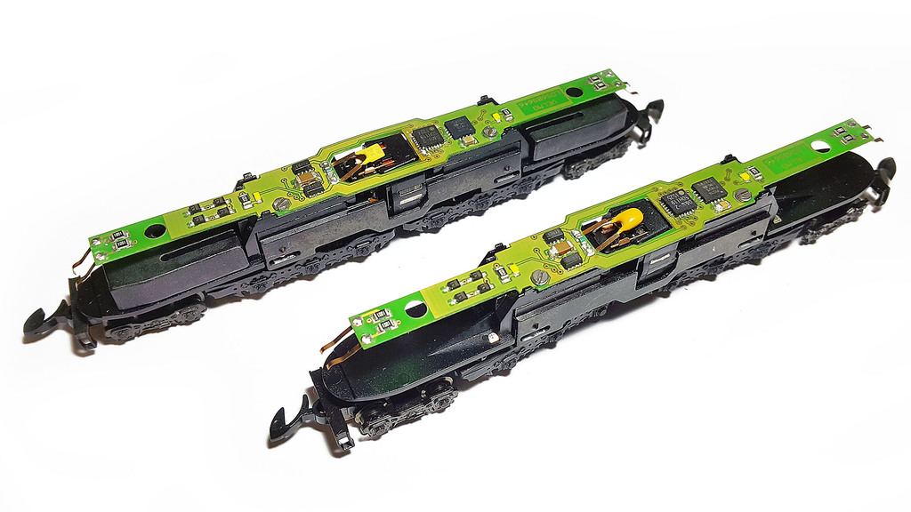

However these locomotives have a known weakness. Despite very big size and a lot of axles (6 powered), they have too low weight which leads to very poor towing capacity and unstable power pickup. Very specific construction of locomotive is also playing bad role - only part of total weight presses on driving wheels, because separately attached metal pilot trucks don't participate in this. Result is predictable: towing capability of GG1 is comparable with small 4-axle locomotives like SBB RE 4/4 IV and significantly lower than one of Märklin's big 6-axle locomotives like BR 151, BR 103 etc. Märklin refused to use advantages of big size of GG1 and made too small and light metal chassis with insufficient weight (see attached pictures). I decided to fix this and developed additional weight inserts for these locomotives.

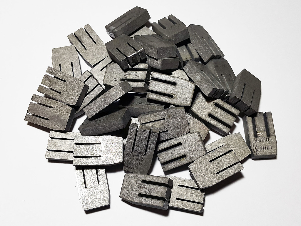

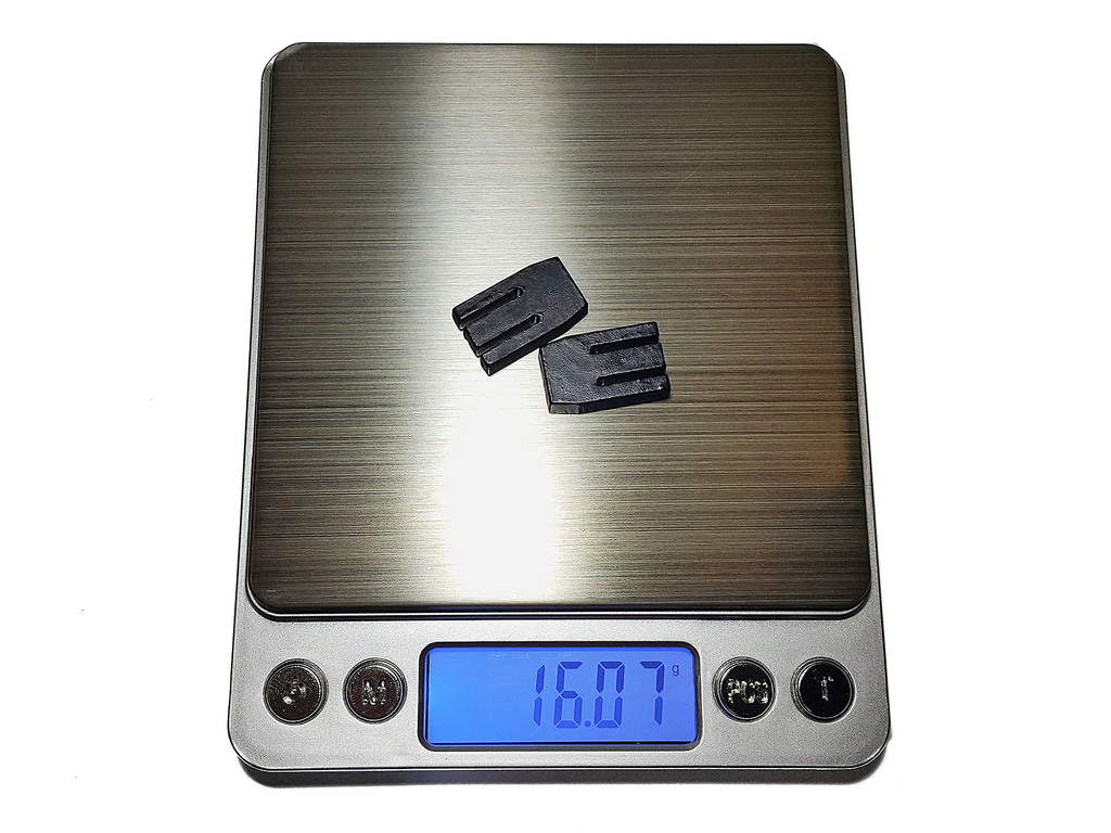

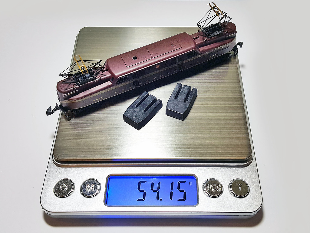

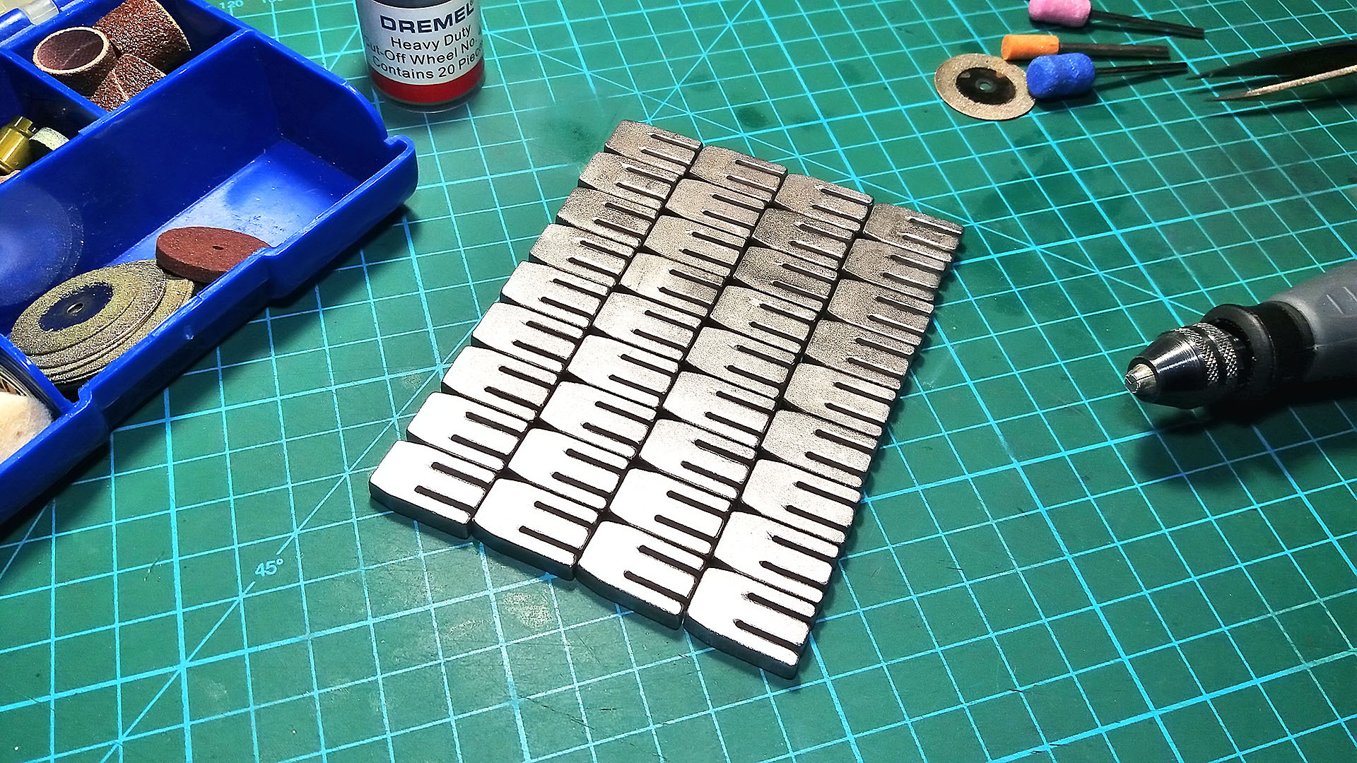

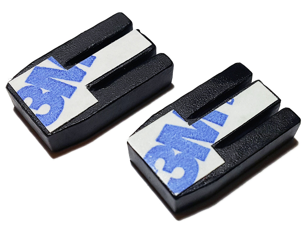

They made from 5 mm thick stainless steel sheets on industrial CNC laser cutting machine and painted with black paint for better look and electric insulation. For easy installation weight inserts have already applied adhesive tape on the bottom side. Each piece weights 8 grams; one GG1 needs two pieces which gives additional 16 grams. Single GG1 locomotive weights 38 grams, and total weight with two metal inserts rises up to 54 grams.

1. Unpainted weight inserts directly from cutting machine:
2. Some stages of production:

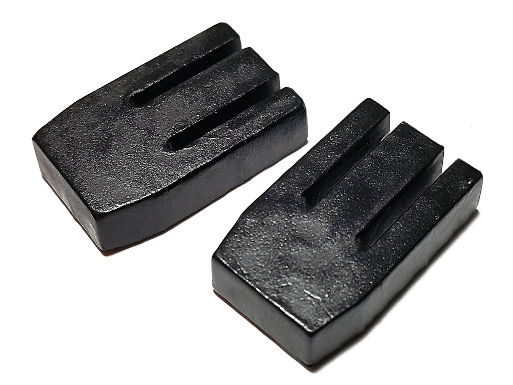

3. Painted pieces, top:
4. Painted pieces with double-sided adhesive tape on the bottom side:

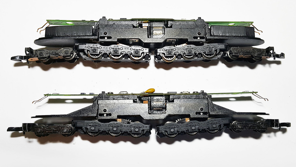

5. GG1 locomotive with (upper one) and without (lower one) weight inserts, side view:
6. GG1 locomotive with (upper one) and without (lower one) weight inserts, top view:
7. Pair of weight inserts on high precision scales:

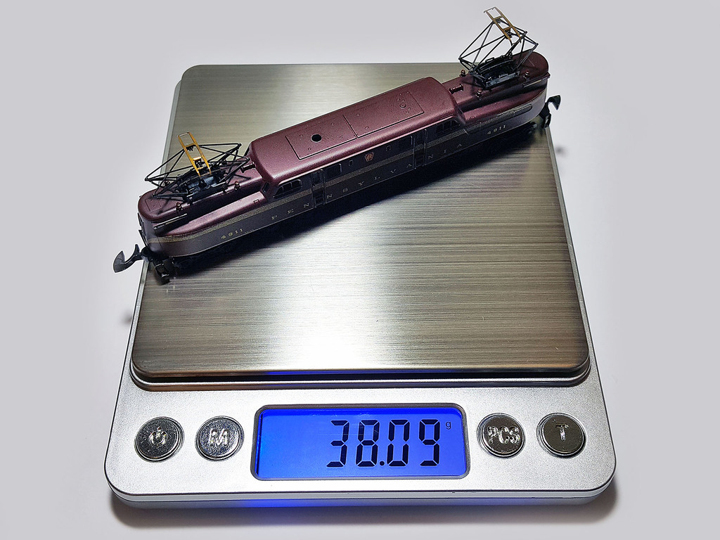

8. GG1 locomotive without additional weights on scales:
9. GG1 locomotive and pair of additional weights on scales:

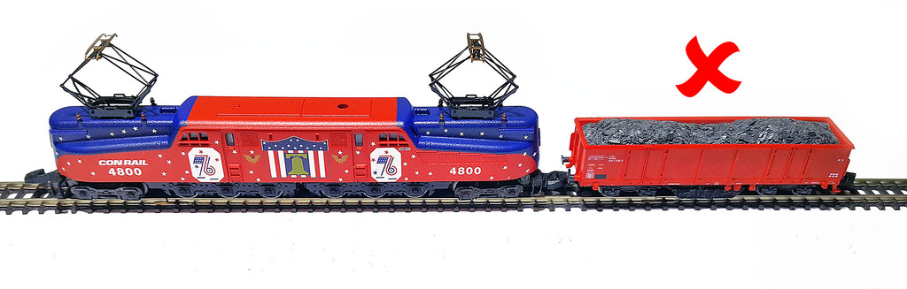

10. Pulling power without additional weights is insufficient to pull even single Märklin 86501 track cleaning car:

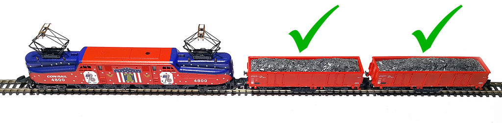

11. After installing of additional weights GG1 can easily pull even two Märklin 86501 track cleaning cars:
