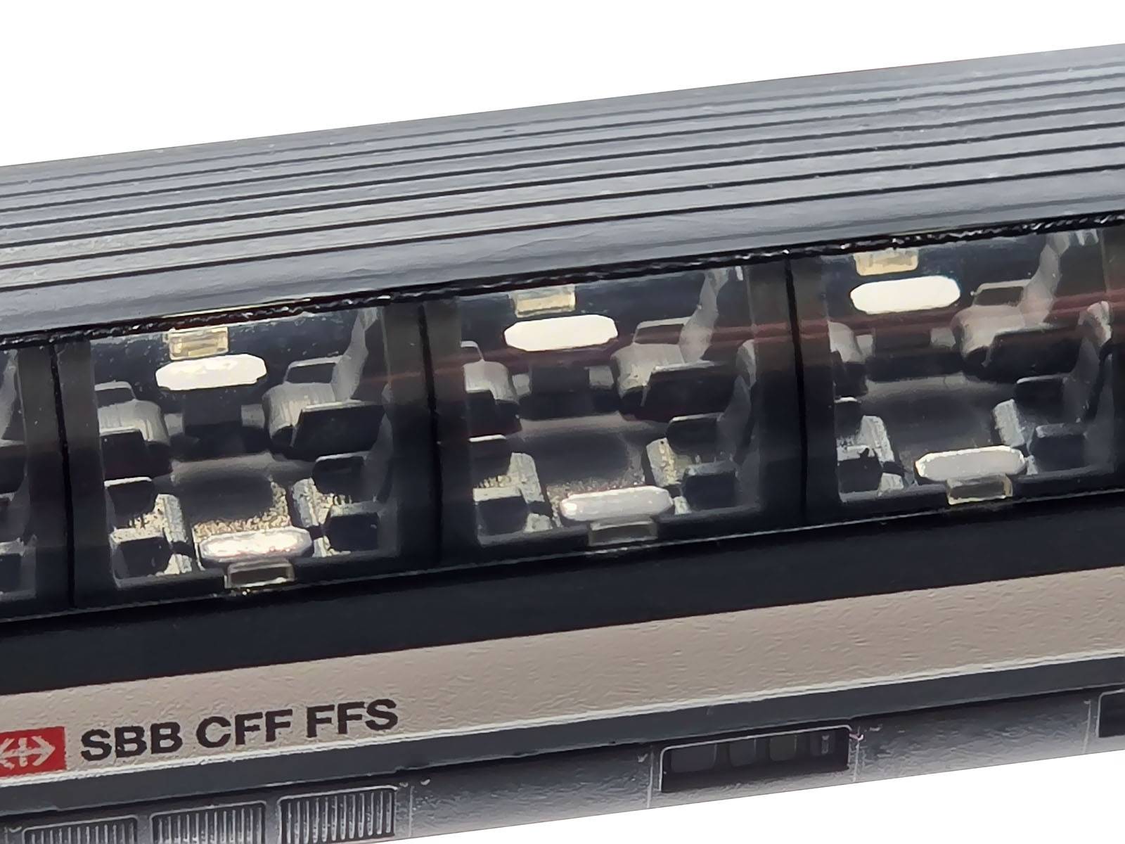

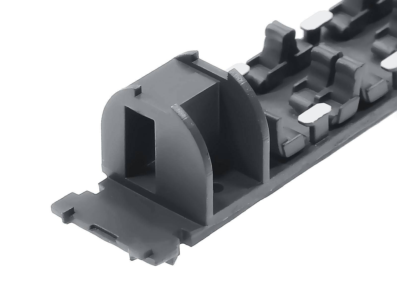

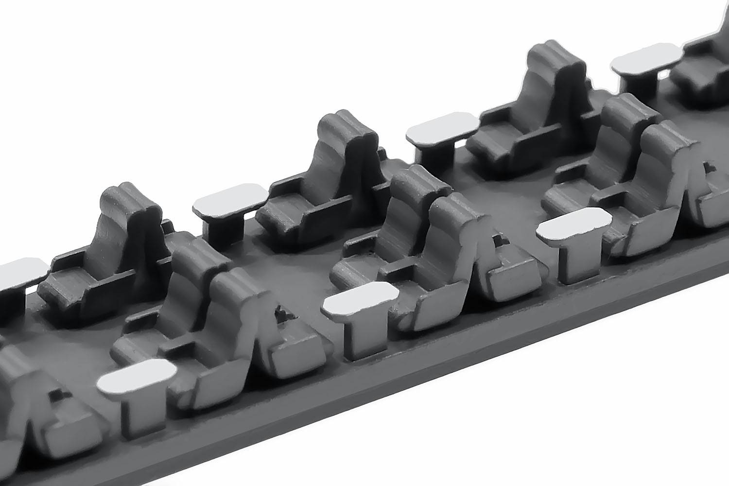

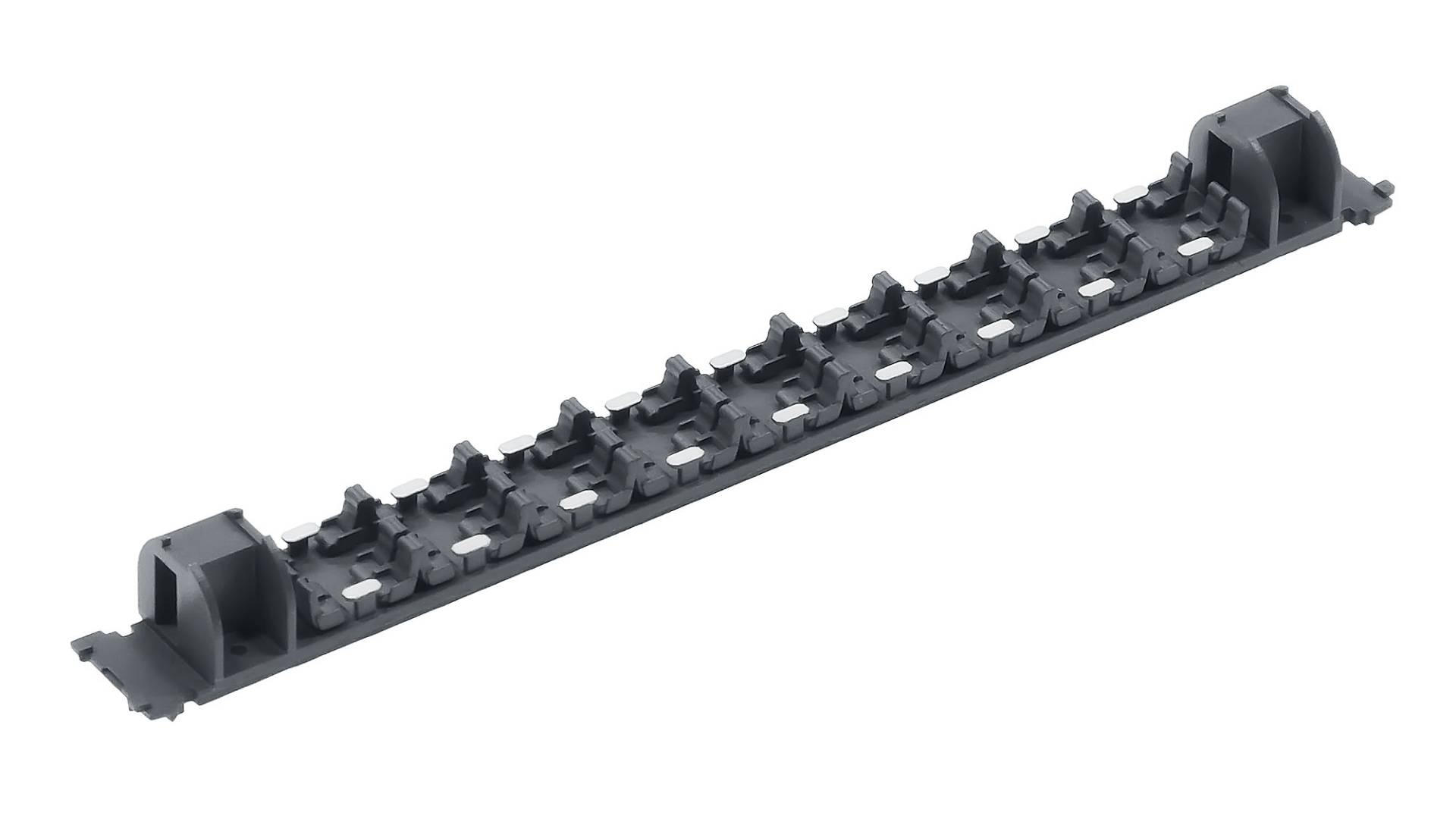

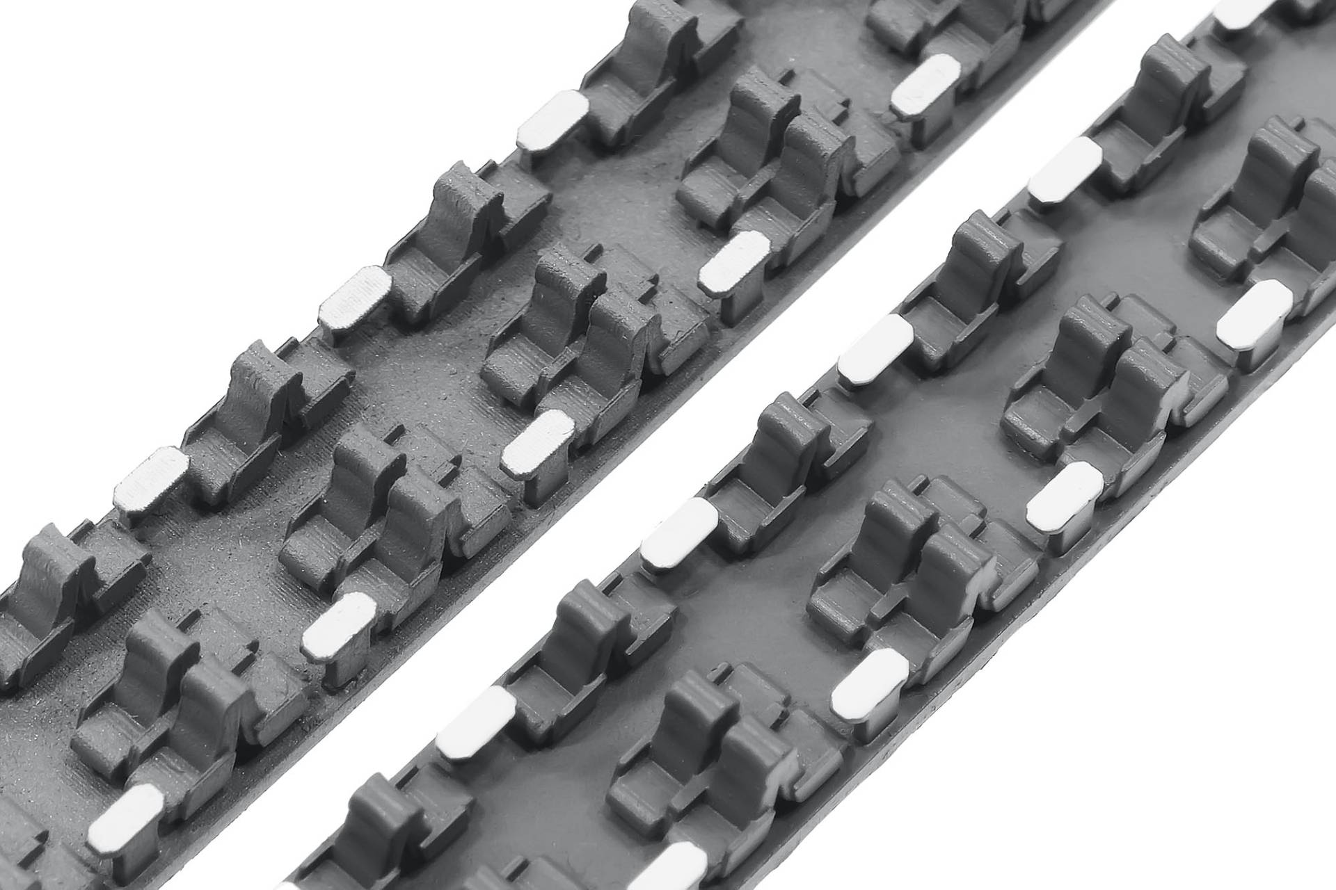

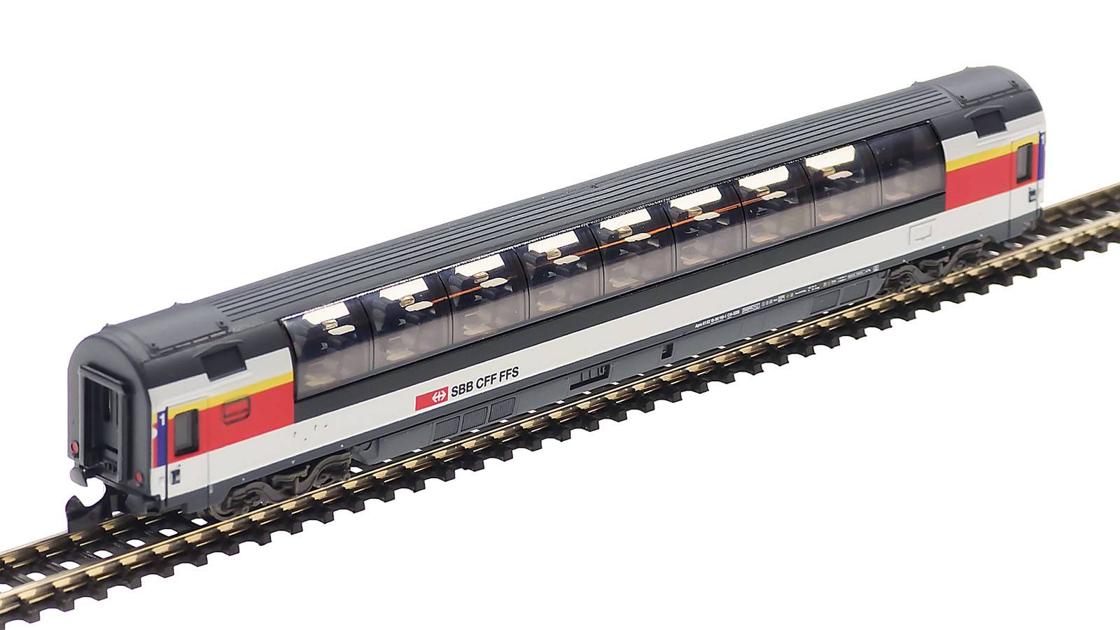

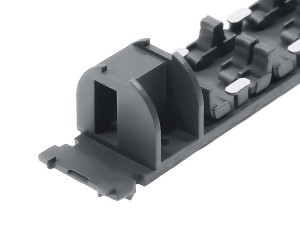

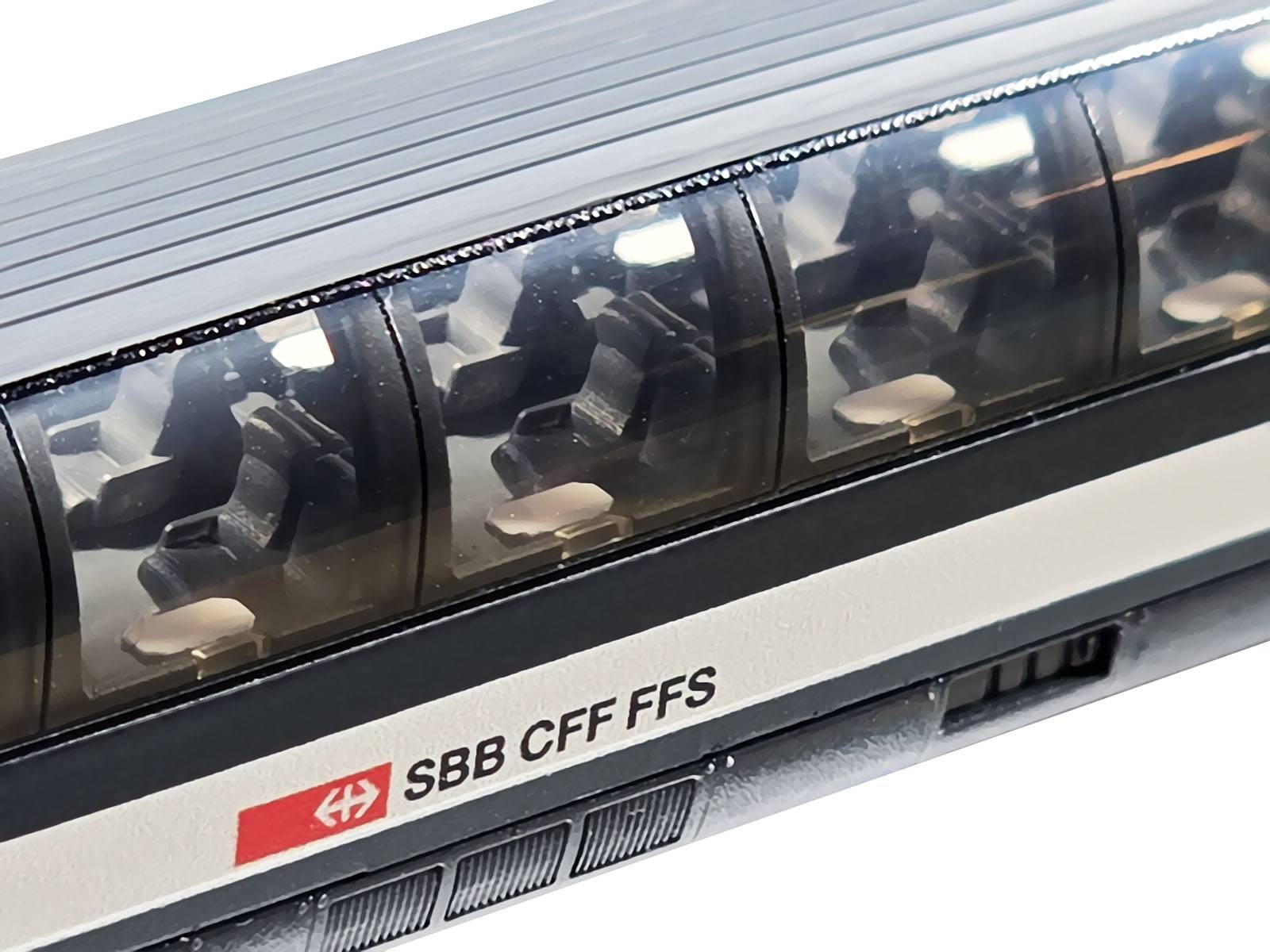

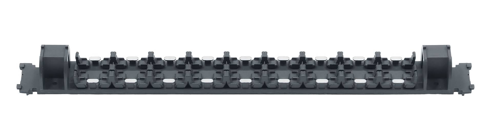

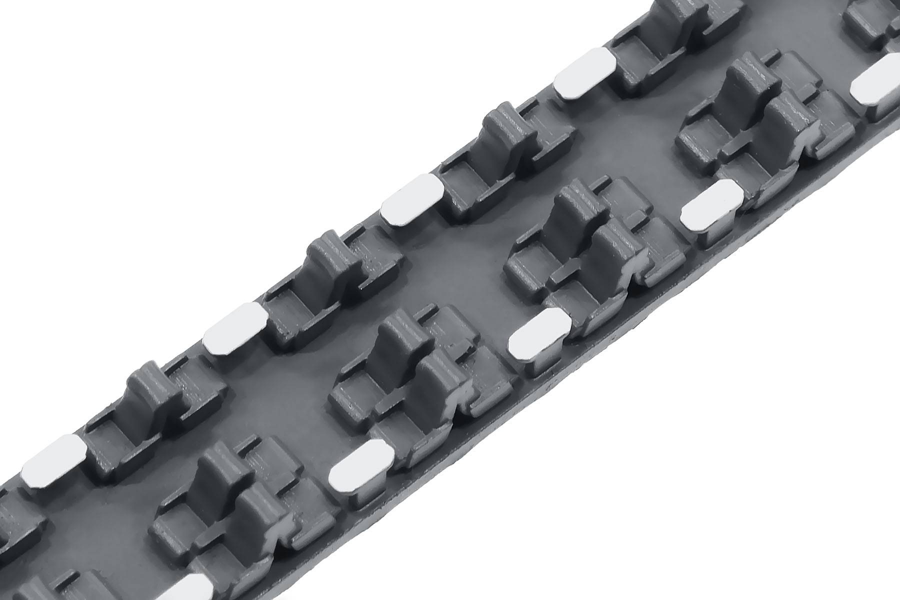

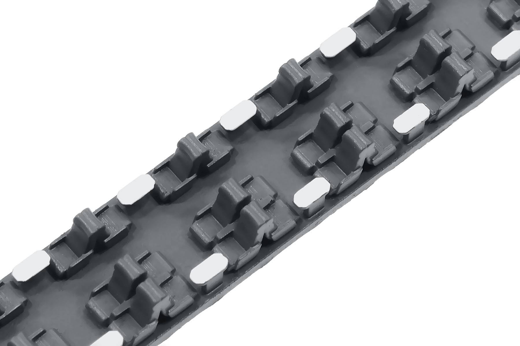

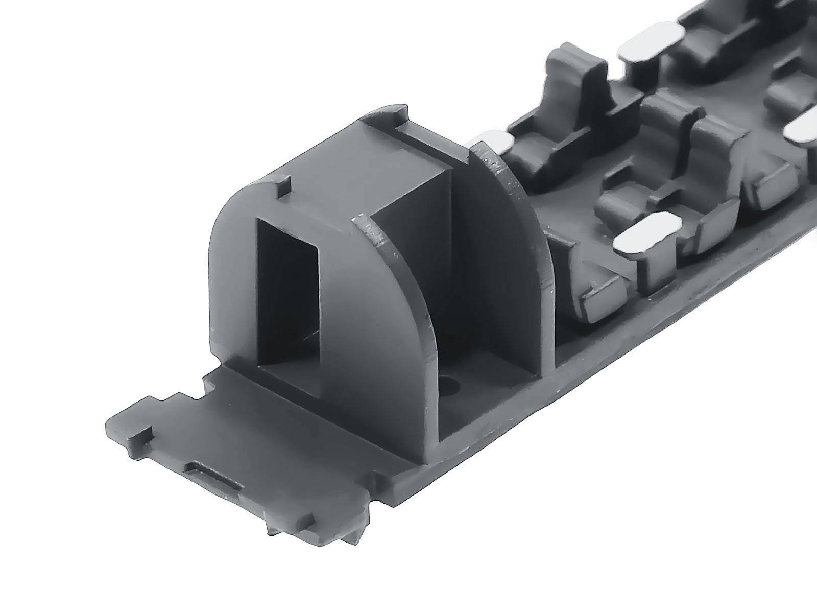

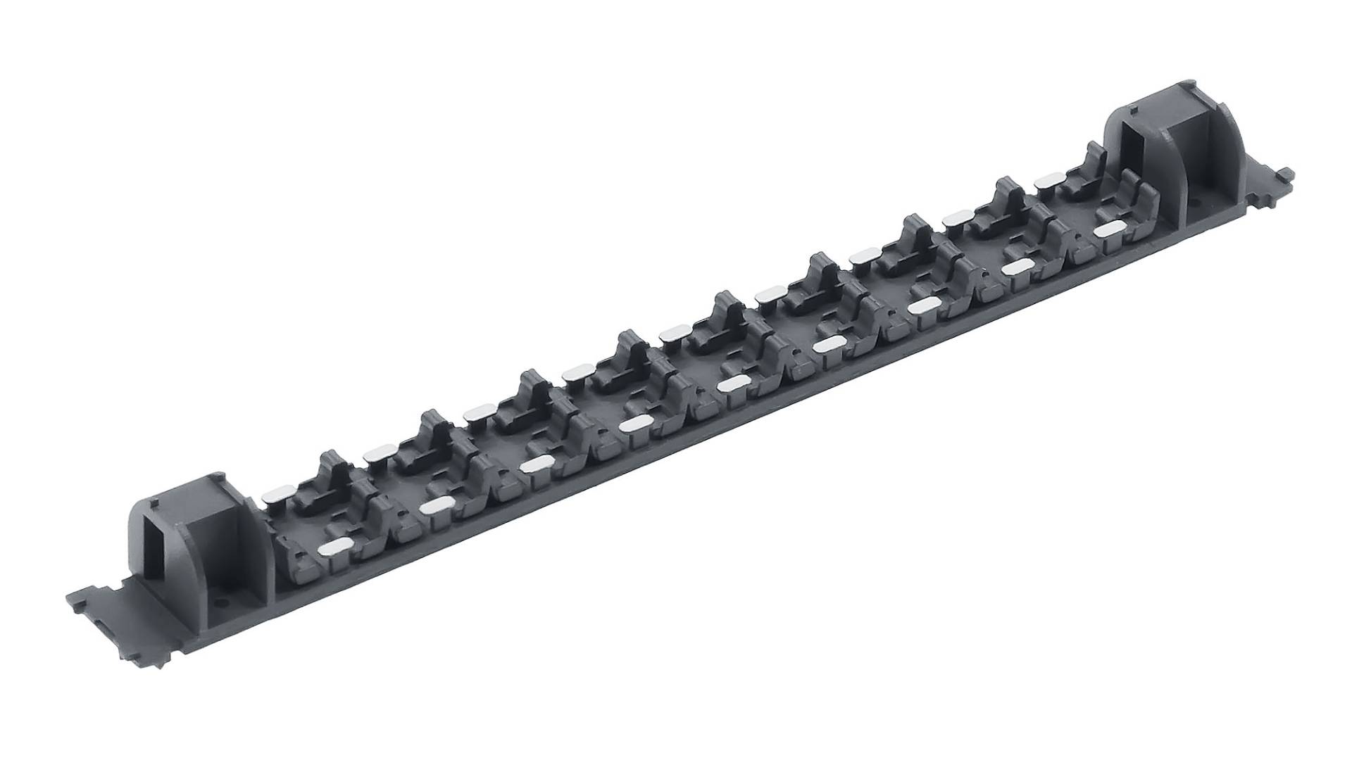

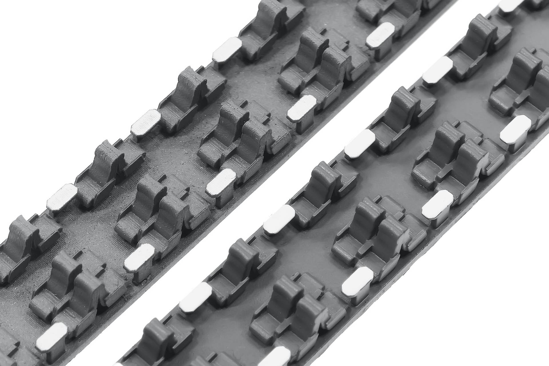

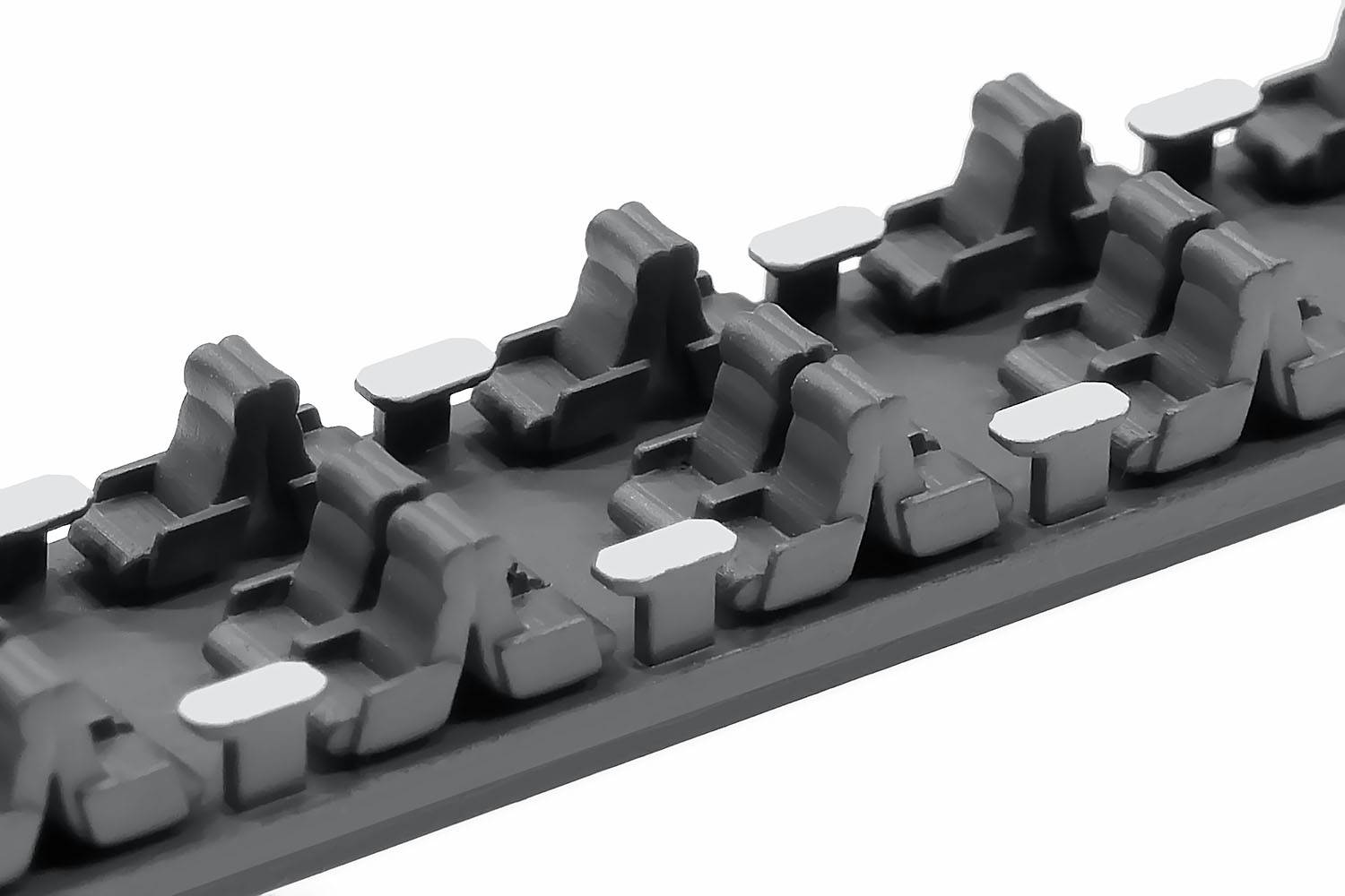

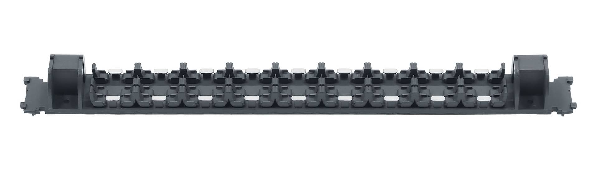

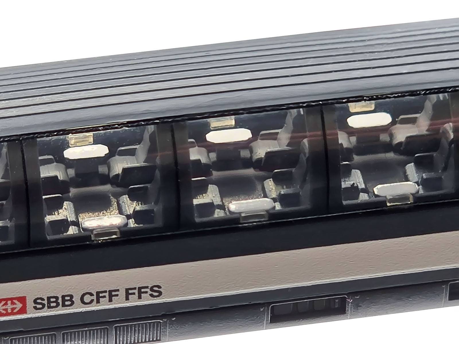

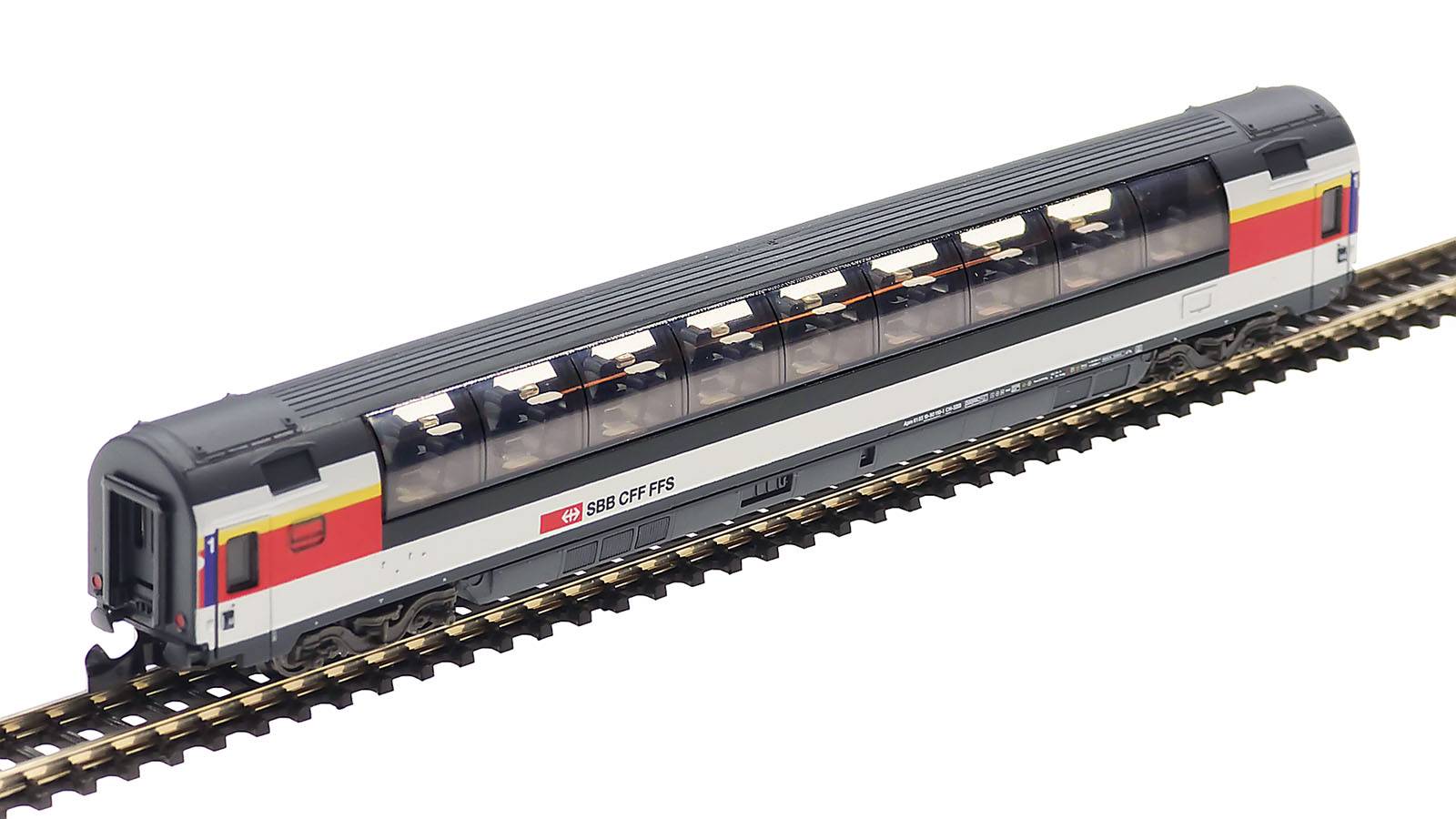

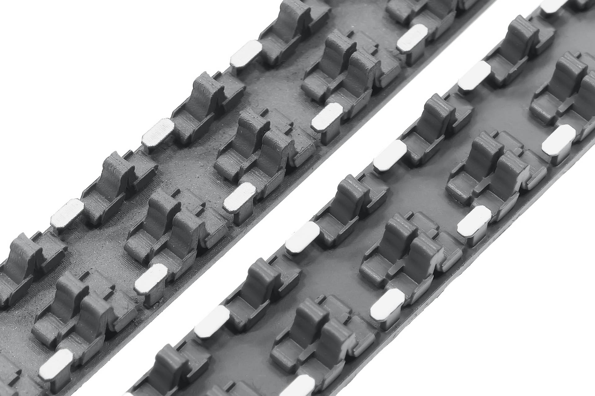

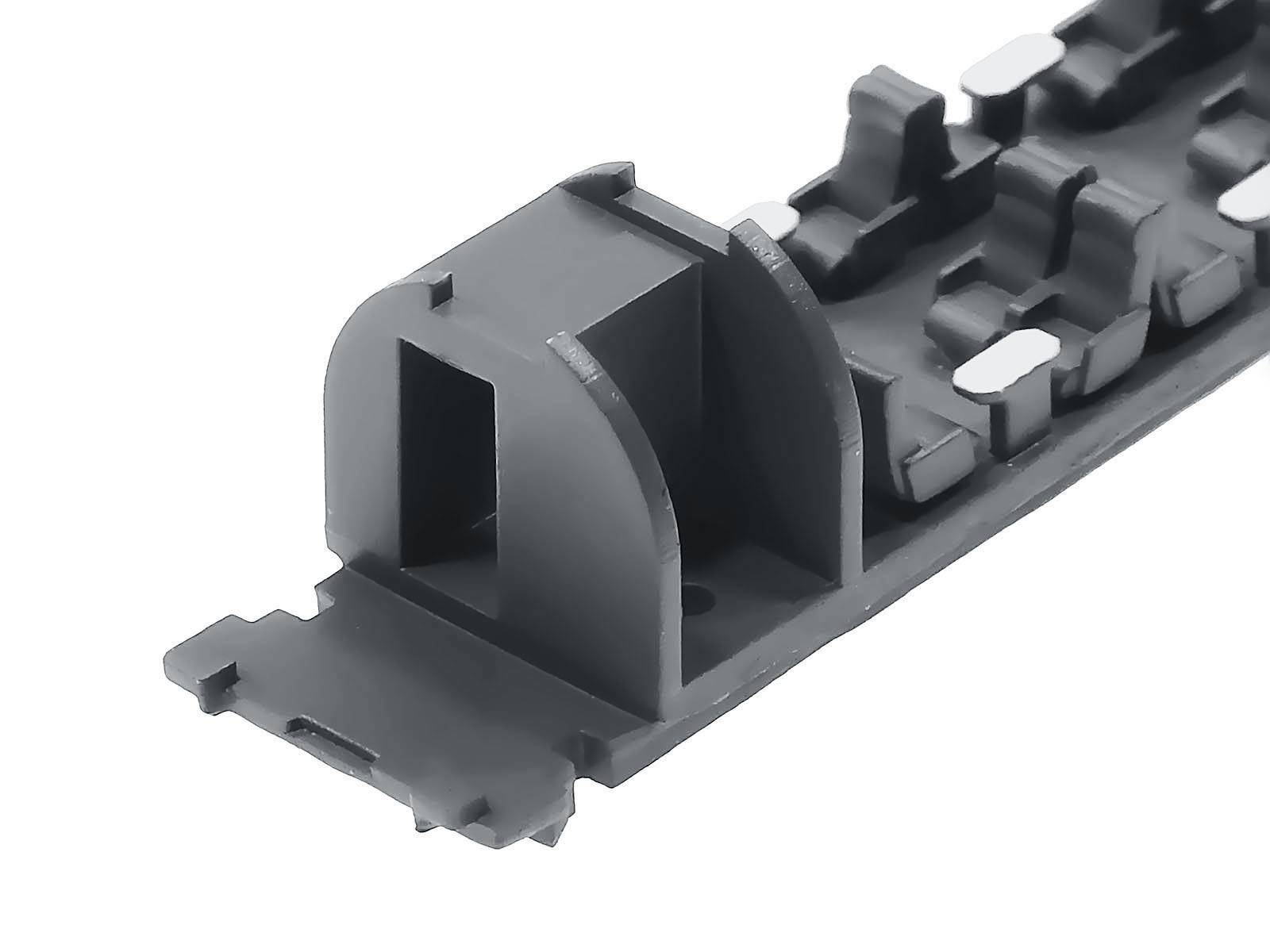

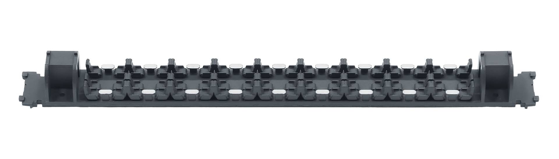

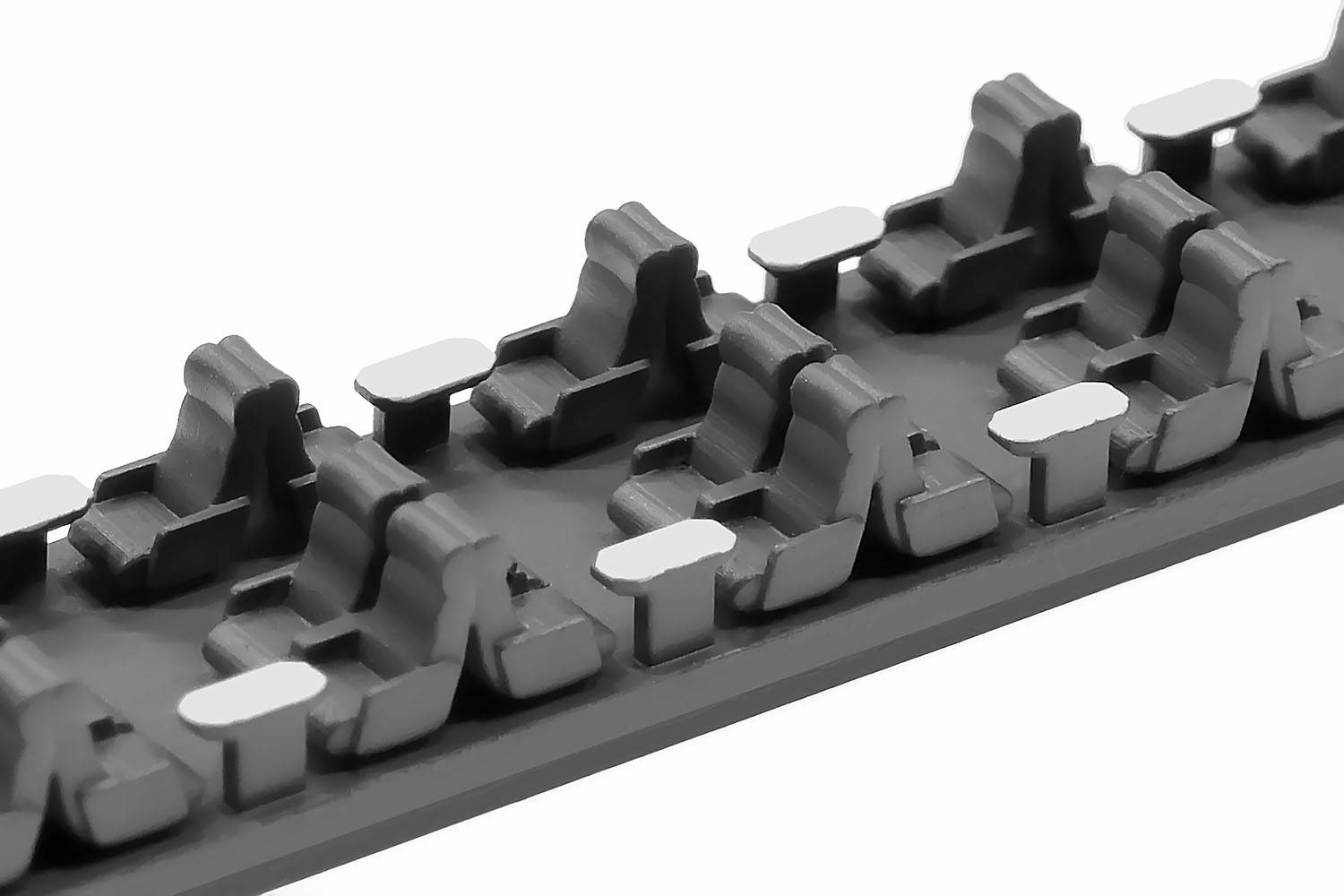

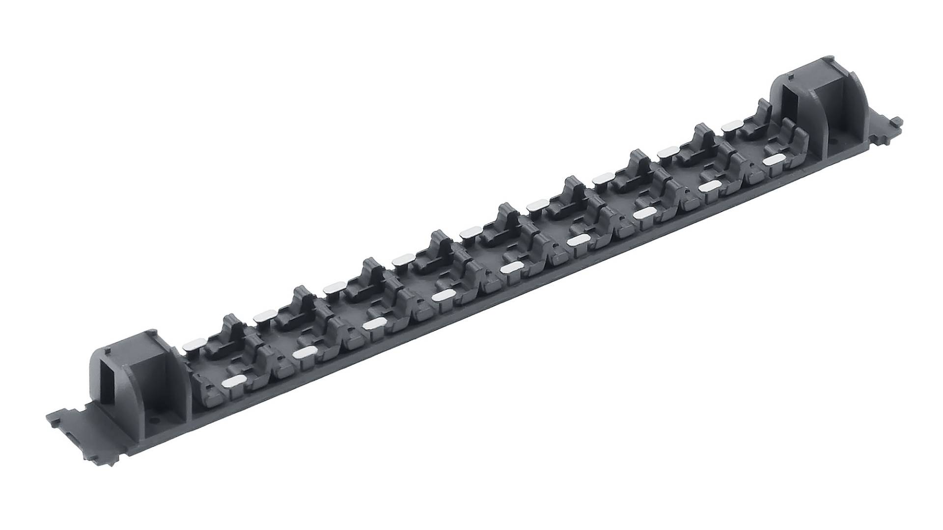

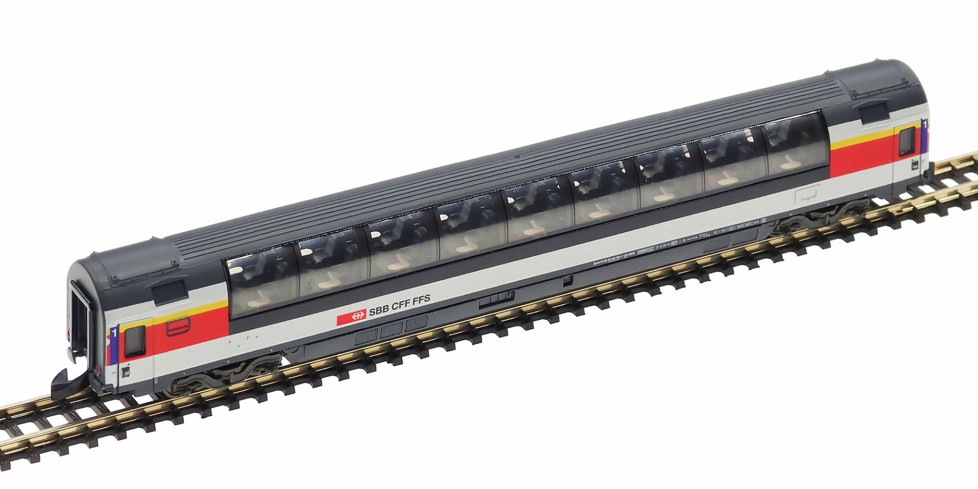

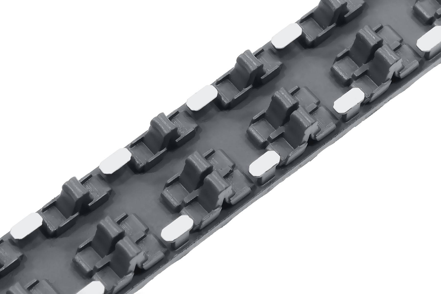

ZM-INT-APM – Interior details for SBB type APM panorama car
This product features the smallest details that is possible to create using SLA 3D printing technology – including tables between the seats and very detailed seats with separate headrests:
I would like to point out that the 3D printing technology developed significantly during last years – the parts I printed now offer even better quality than I achieved several years ago – almost invisible printing layers and noticeably smoother surface. Here is a comparison of the new and old parts:
The part is airbrushed with gray lacquer paint. I painted the tabletops manually with precise brush afterwards:
The toilet compartments have holes for the cables to allow making the wiring invisible from outside. The endings of the interiors are designed in a special way to be able accommodate the red taillights that can be optionally installed later:
The detailed report about my digital solution for APM panorama cars is here, I posted it six years ago:
viewtopic.php?p=187968

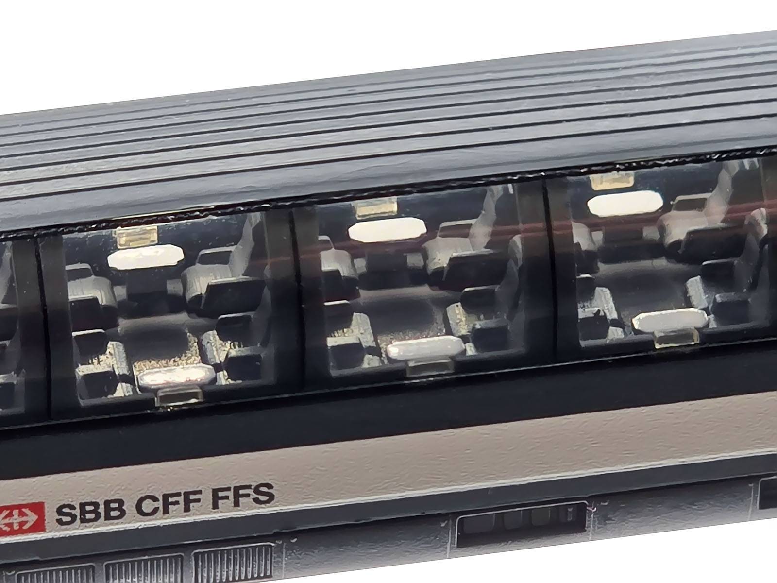

The updated version of the digital interior lighting kit for APM panorama car is already available. I will post a separate report about it soon.

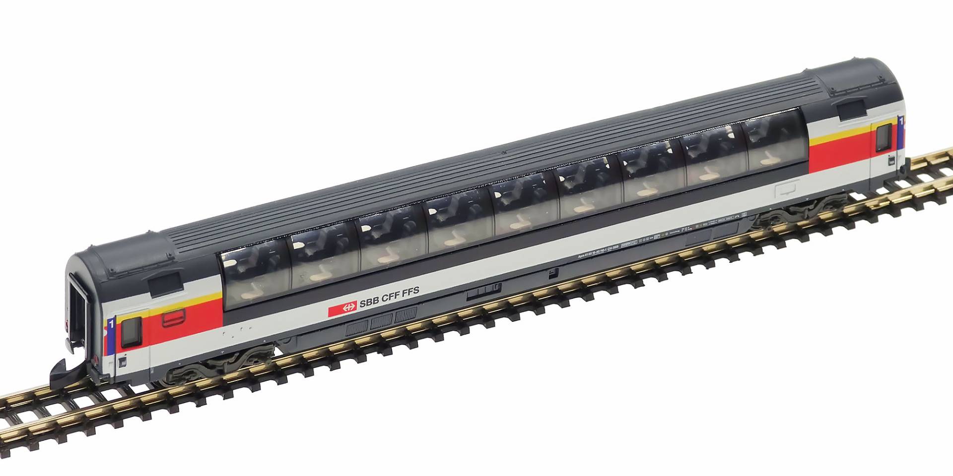

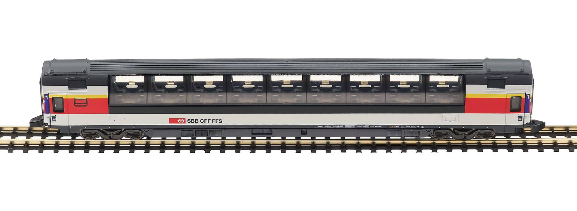

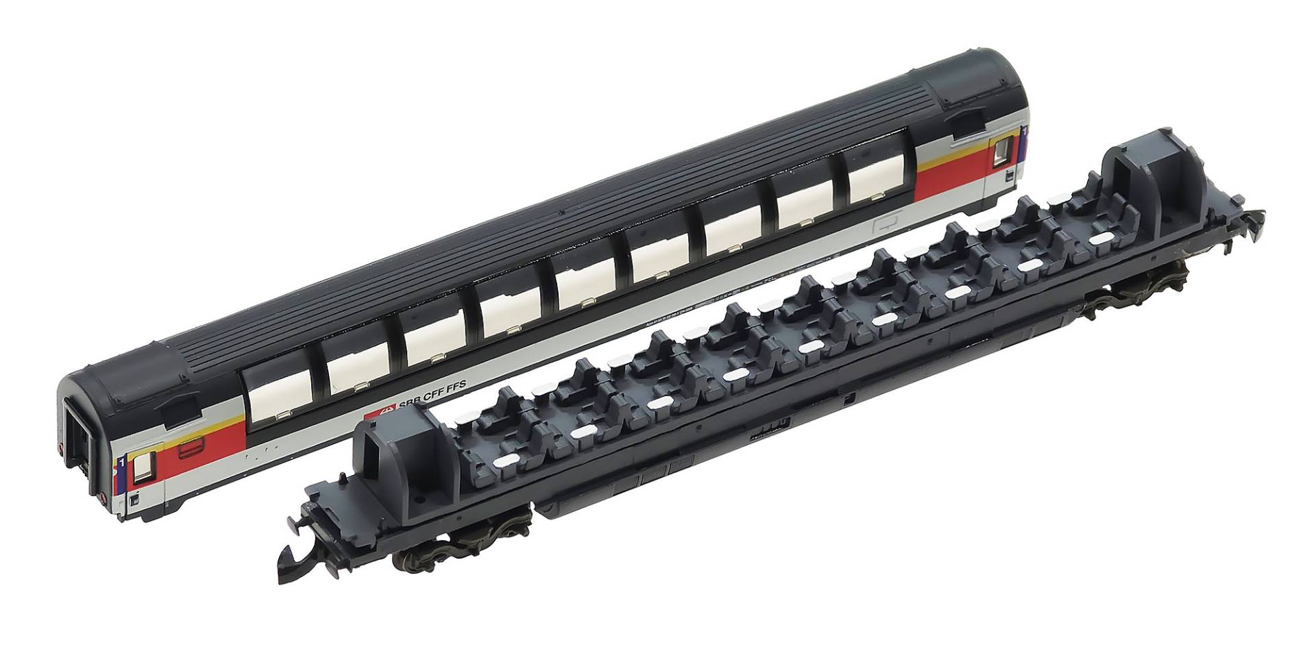

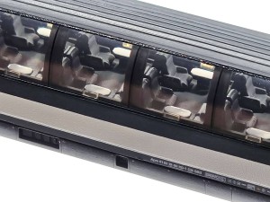

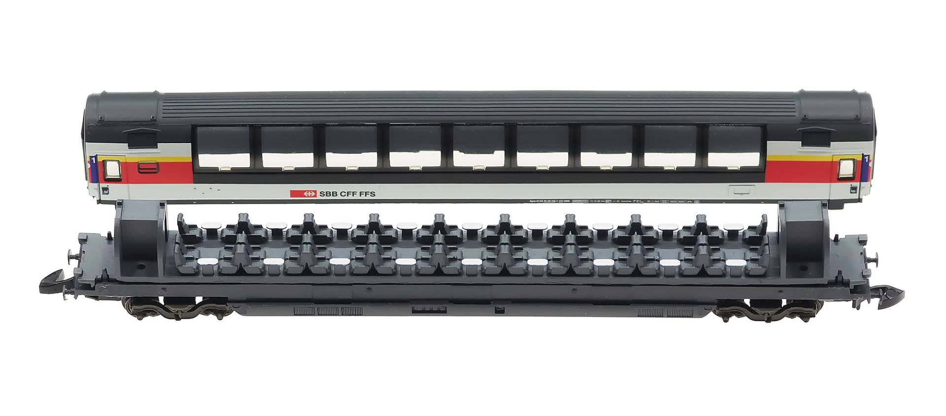

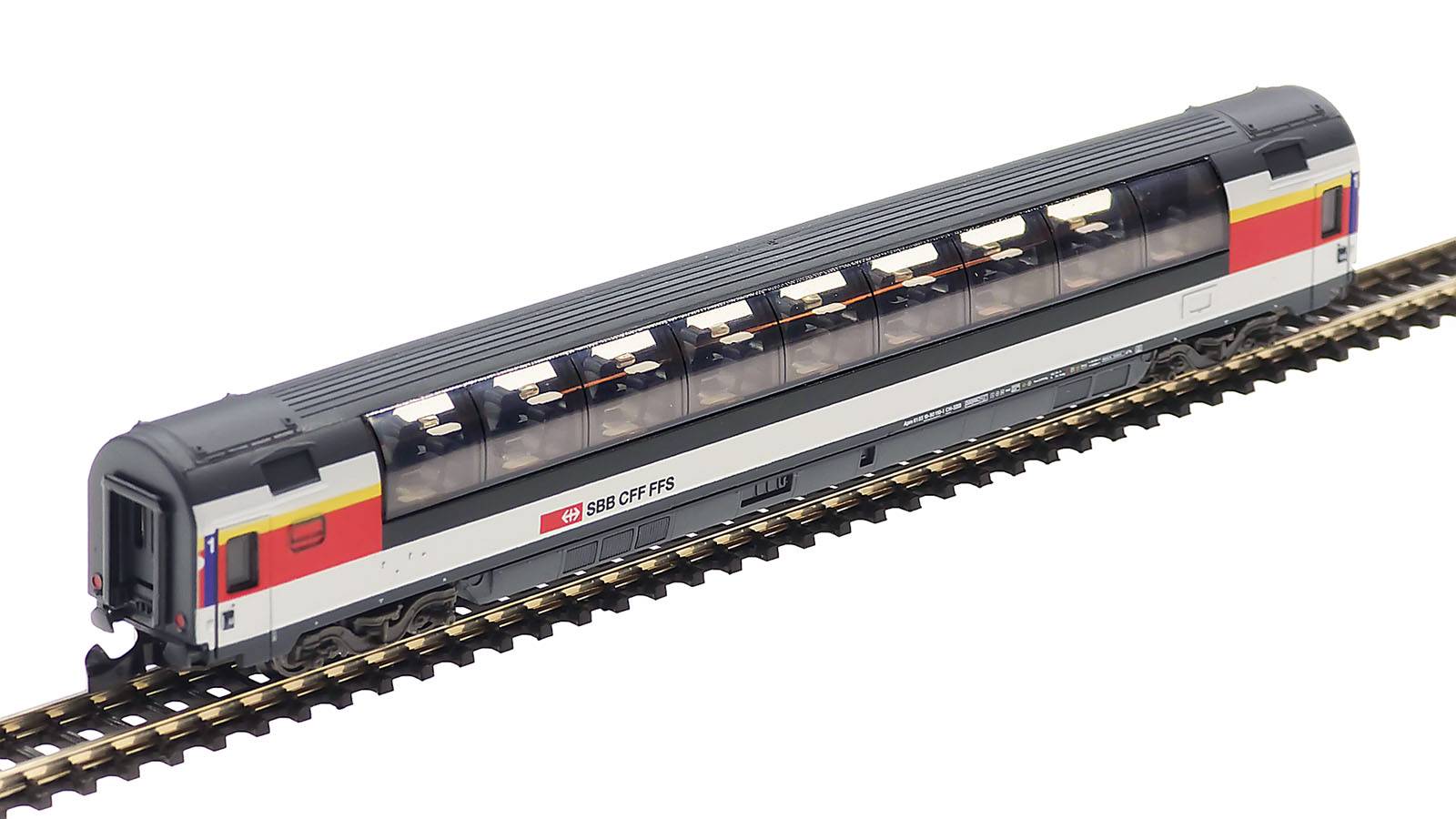

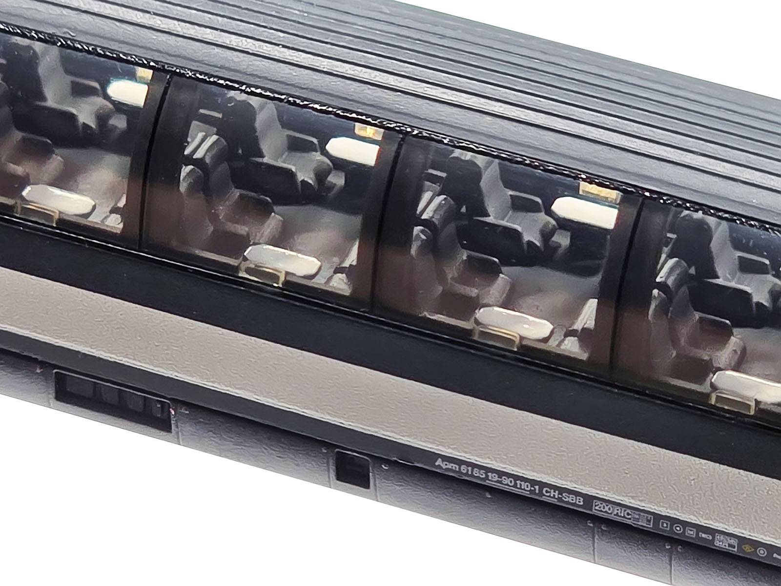

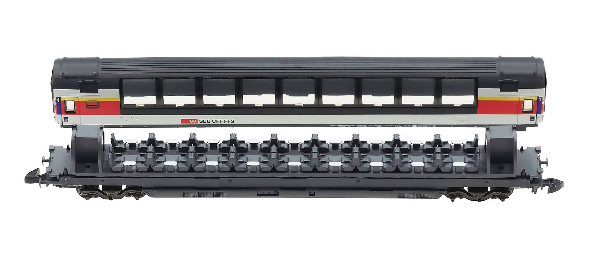

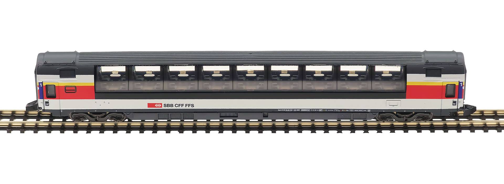

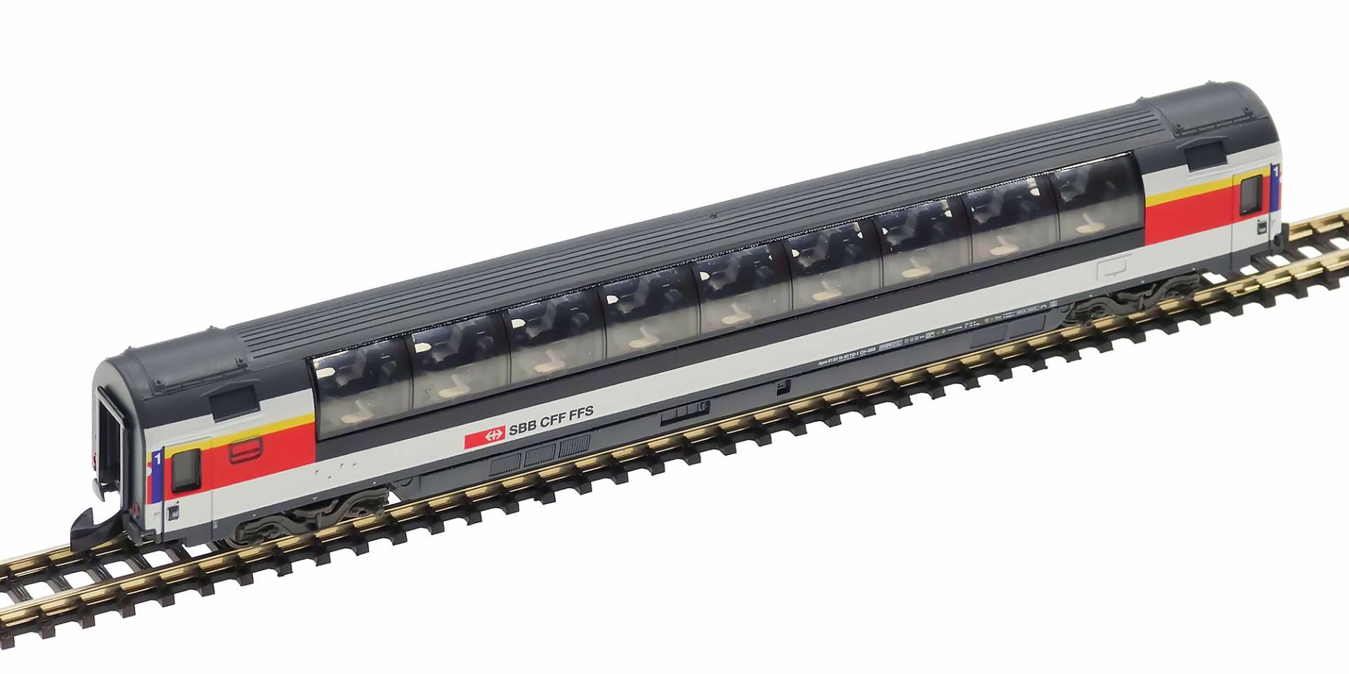

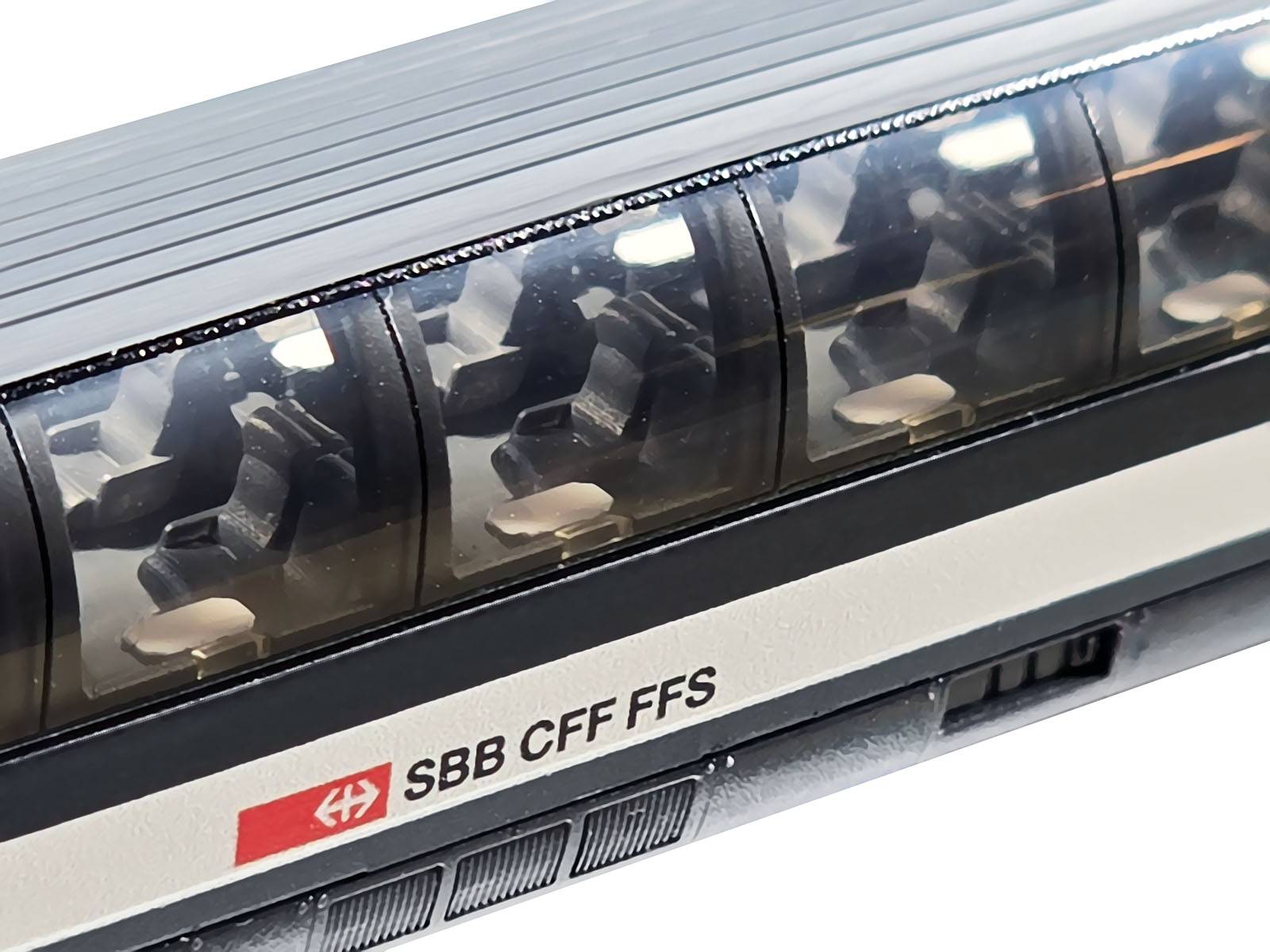

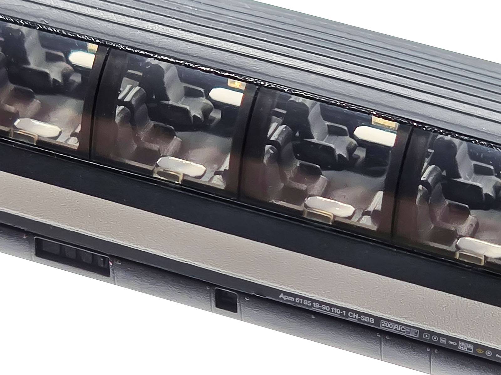

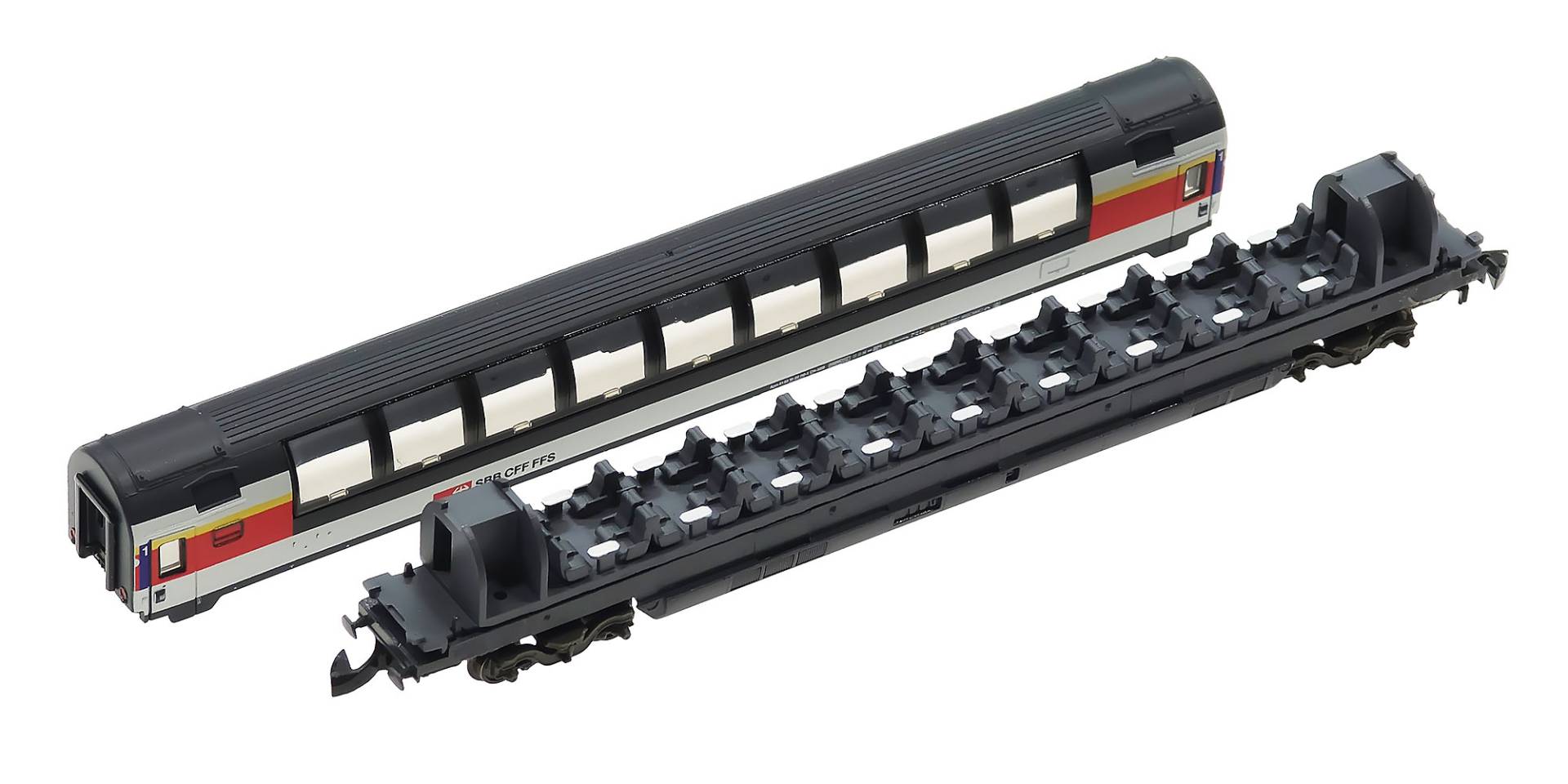

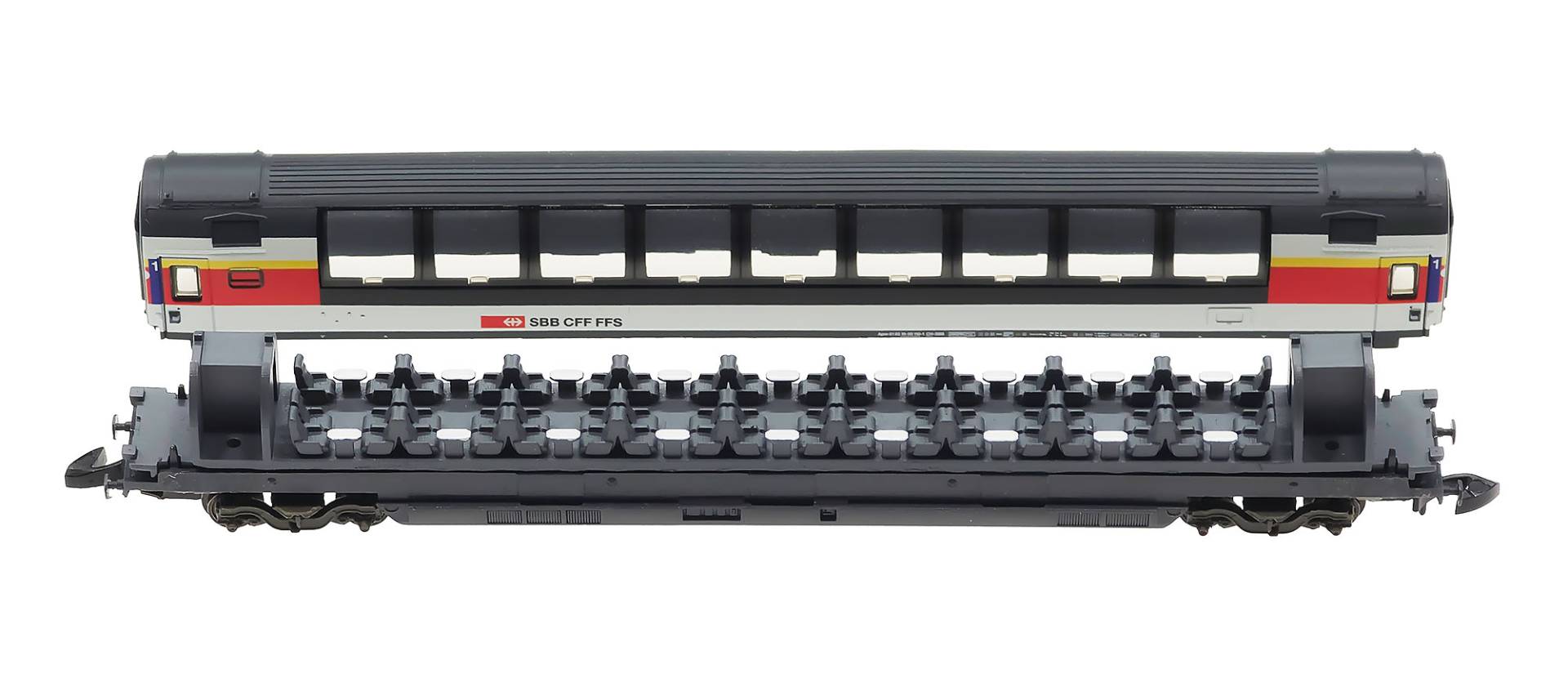

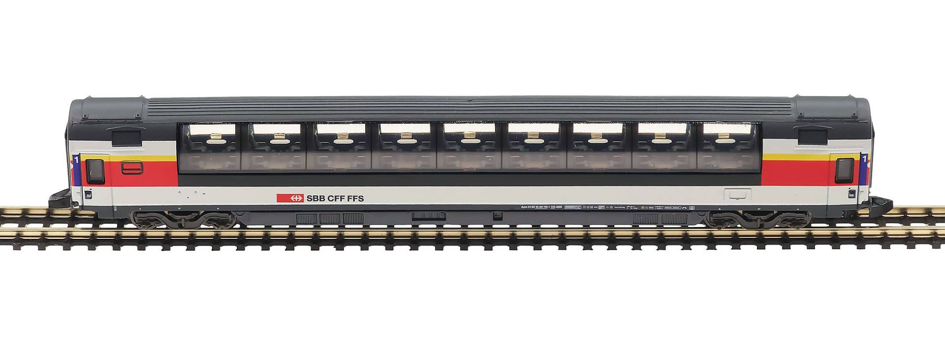

Here is how the interior details look when installed onto the chassis of the panorama car:
Of course, the part does not require removal of the metal weight insert. The fully assembled car looks absolutely stunning – we don’t see a gaping emptiness through the big panoramic windows anymore:

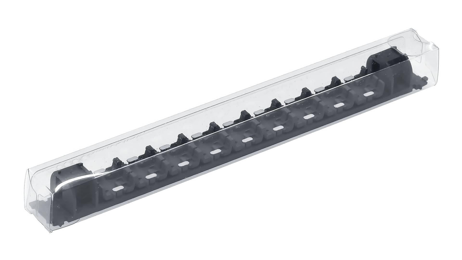

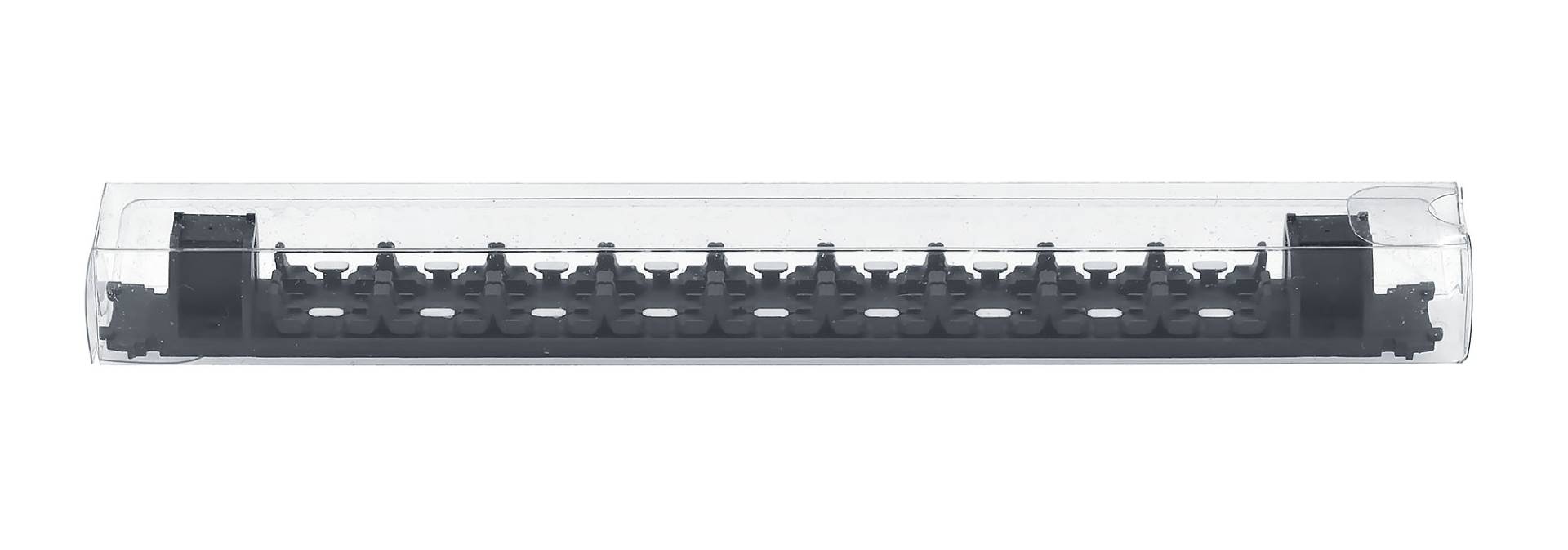

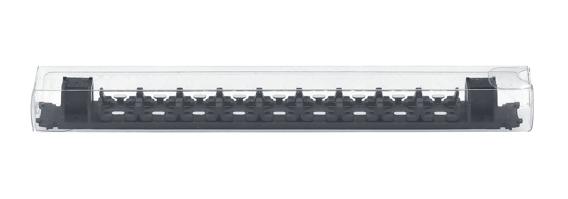

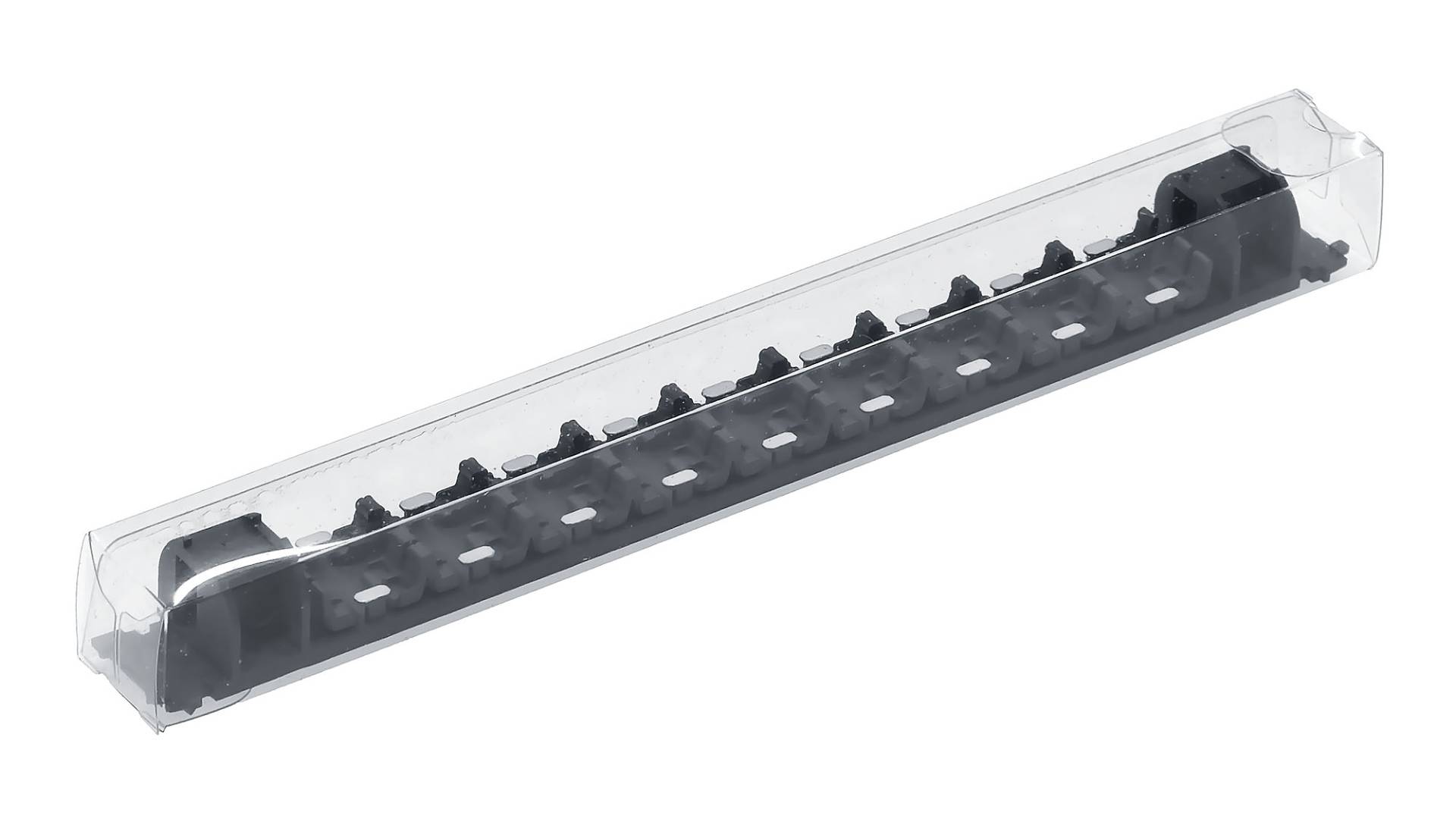

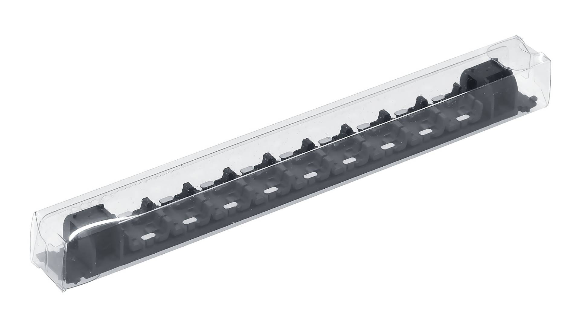

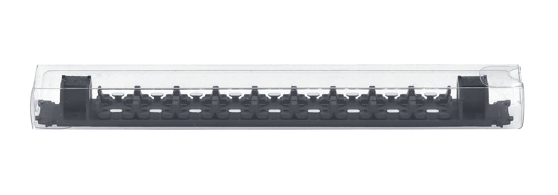

I decided to take additional care about the security of the item during handling and shipping. I developed a special box with a custom size that perfectly matches the dimensions of the item and cut it out from thick clear PVC film:
Such additional measure protects the part from accidental damage. Of course, the item is shipped not only in this box, bus also in a zip-lock bag with cardboard padding and installation instructions.

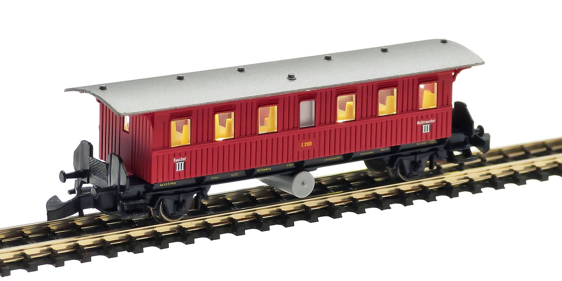

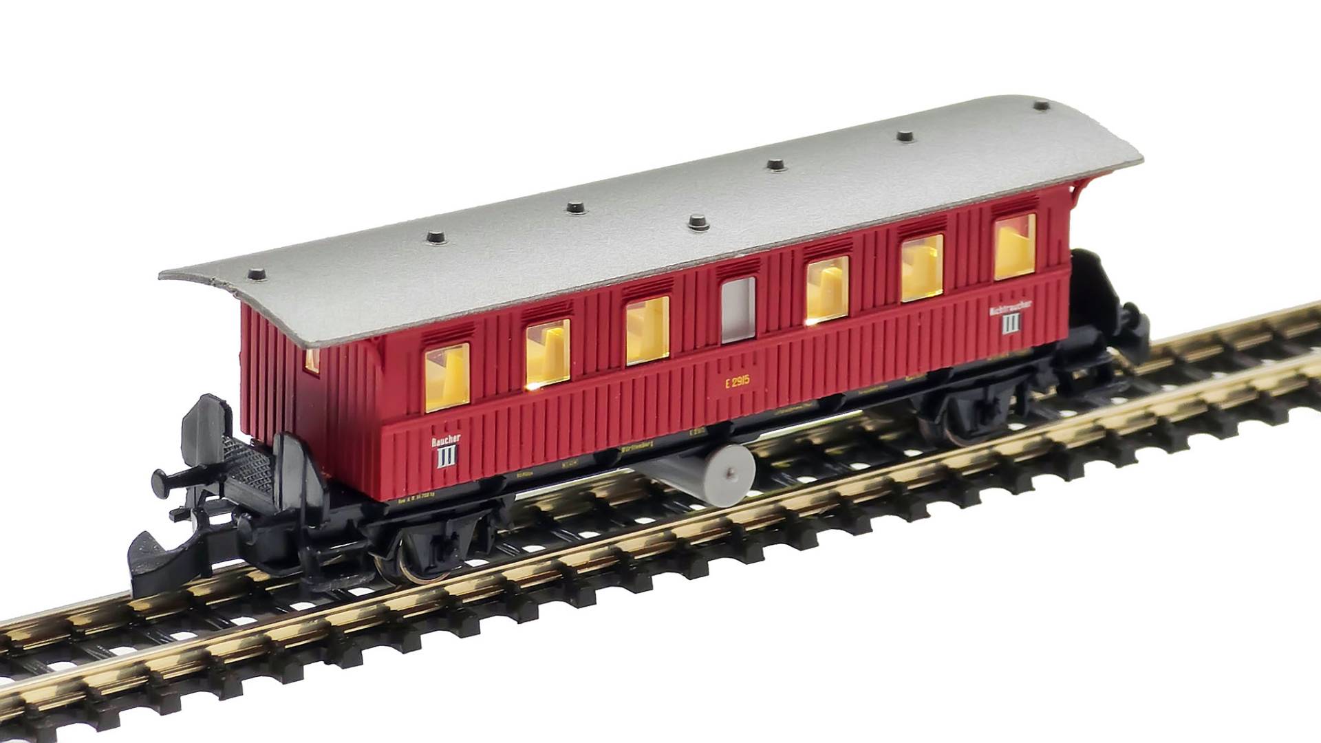

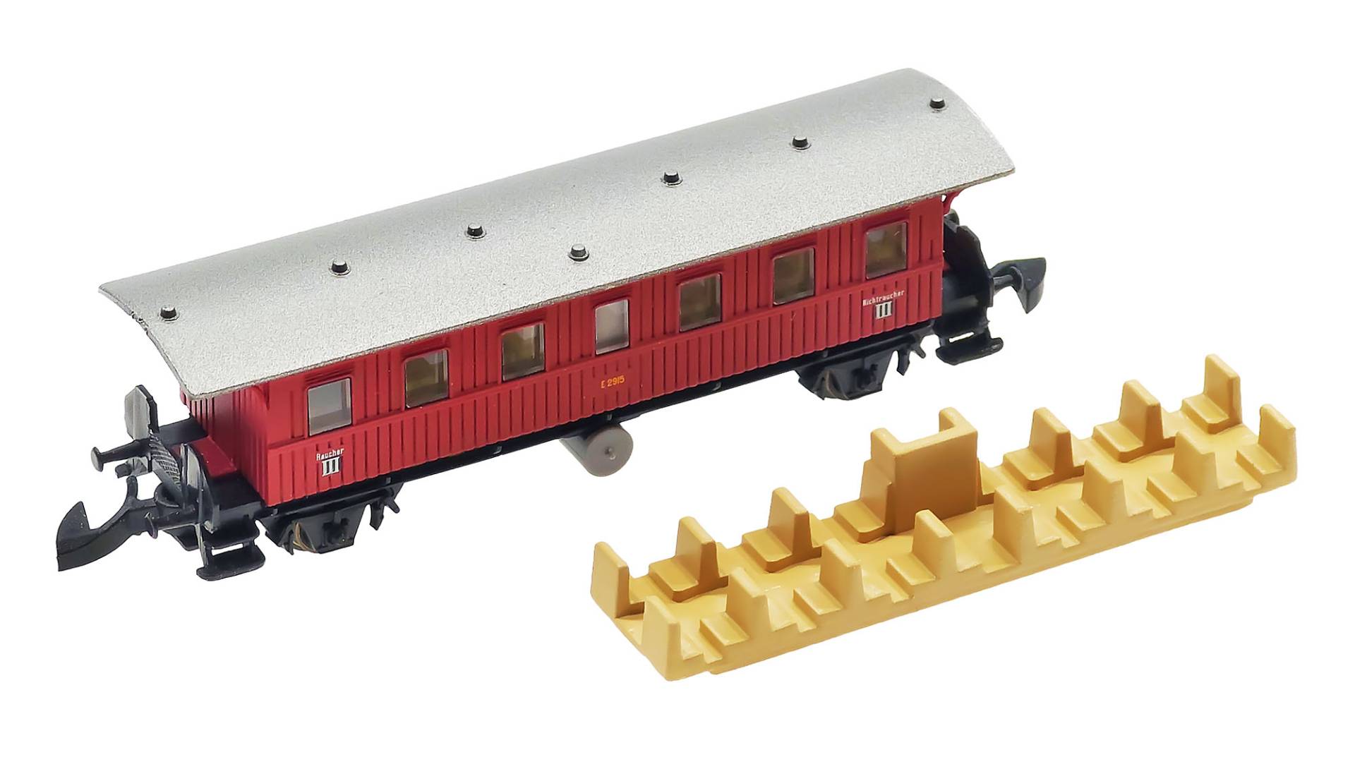

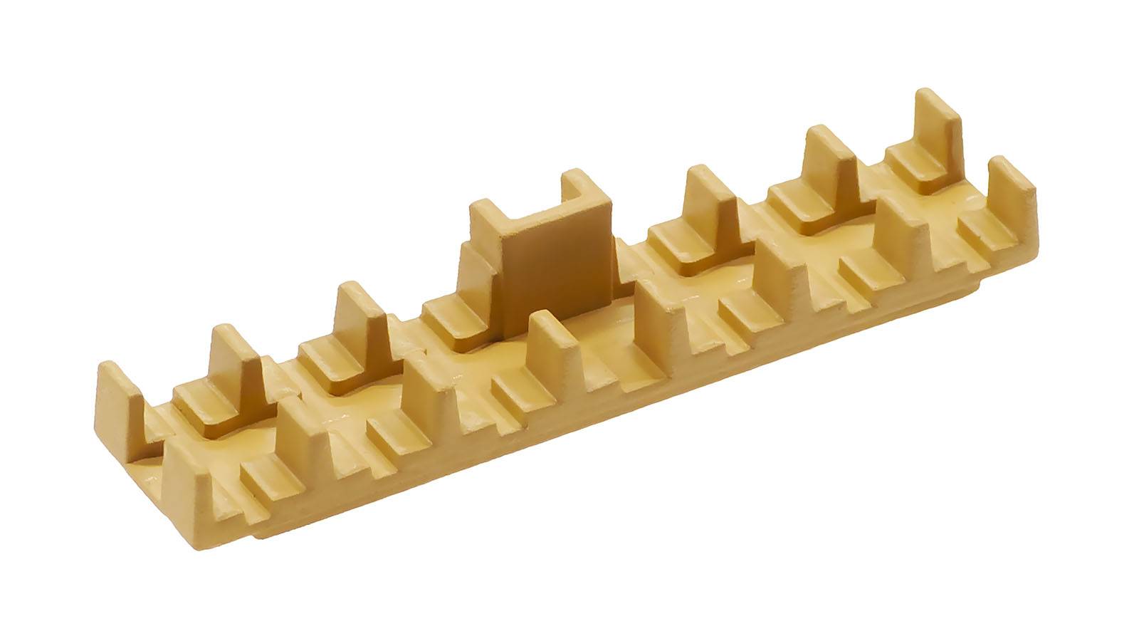

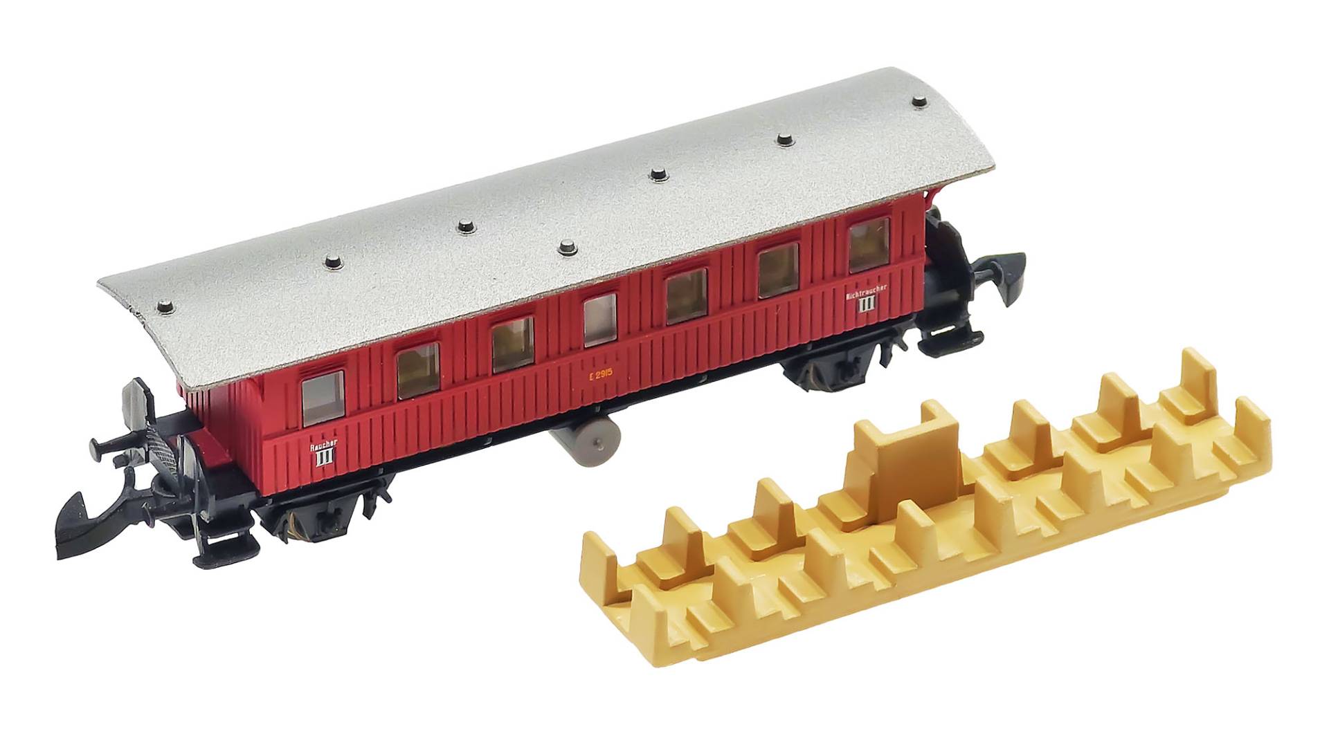

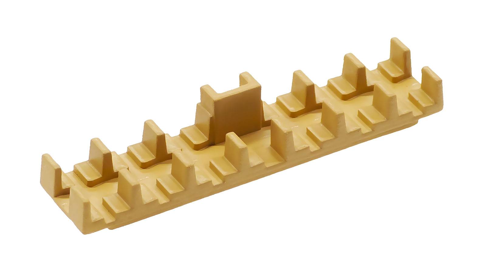

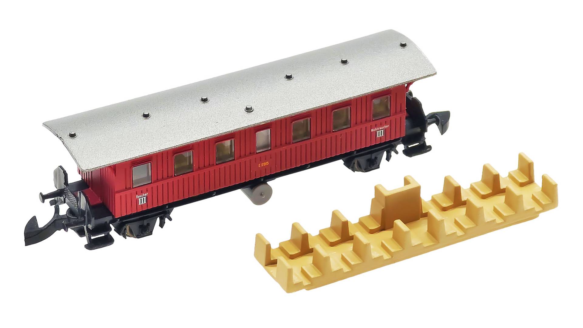

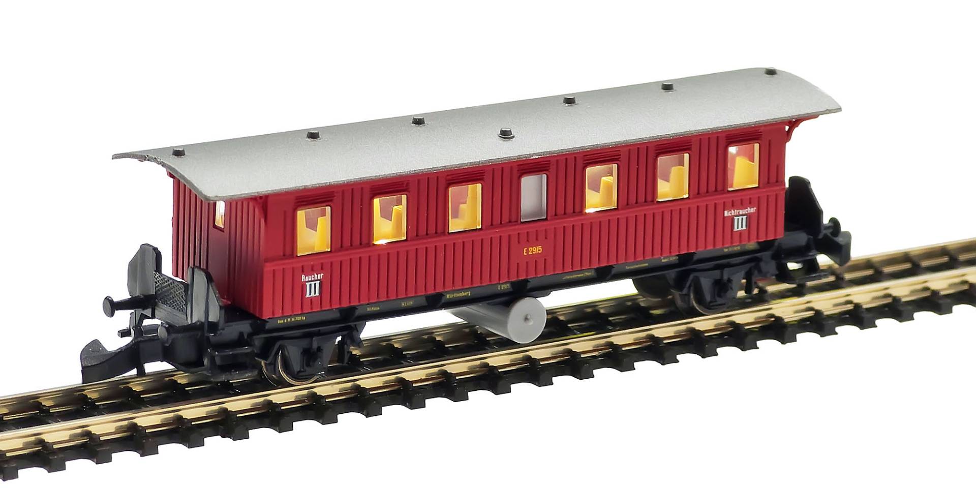

ZM-INT-WU – Interior details for Württemberg design 2-axle passenger cars
Here is one more addition to the new category of my products – interior details for Württemberg design 2-axle passenger cars –the oldest model in the whole Märklin range, available from the very beginning of Z scale, 1972. Although this type of coach was already fitted with interior details in latest editions (for example, 87009), this item can be used for retrofitting older variants like 8700, 8701 and others:
The part comes already sprayed with prototypical color that resembles the light wood. It is compatible with my sliding contacts ZM-SC-006 (https://www.1zu220-shop.de/Zmodell/Zube ... 40771.html) and does not require removal of the metal weight insert.
Here is a detailed report about the disassembly and fitting this type of passenger cars with digital interior lighting, sliding contacts and interior details – I published it six years ago, too:
viewtopic.php?p=187923
The passenger car fitted with interior details and digital interior lighting looks like this:
Here is the list of compatible Märklin products: 8103, 8700, 8701, 8739, 80634, 80911, 81390, 81420, 81563, 81845, 82101, 87001, 87002, 87003, 87009, 98031, 98181

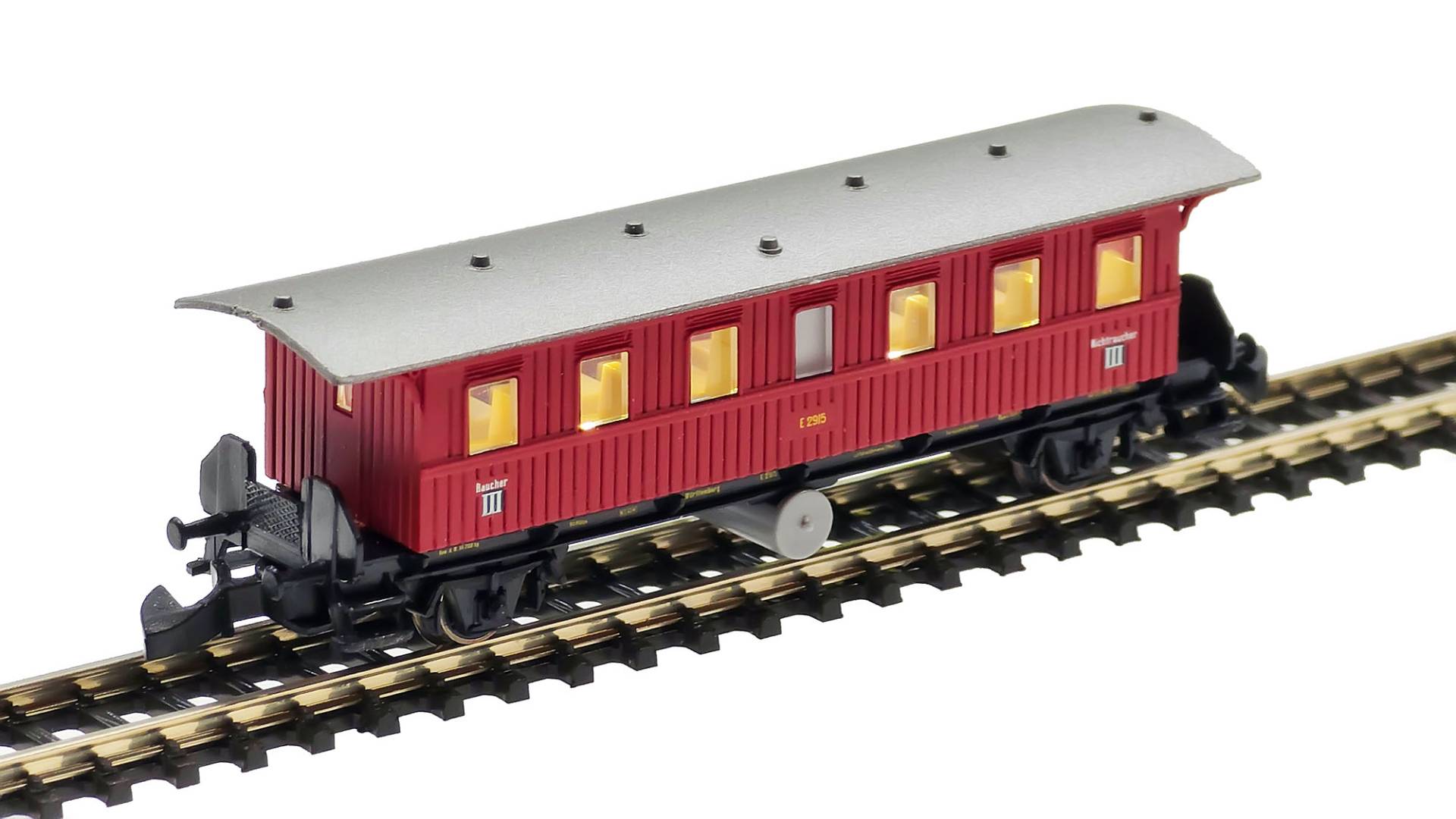

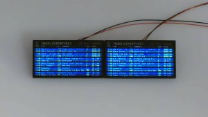

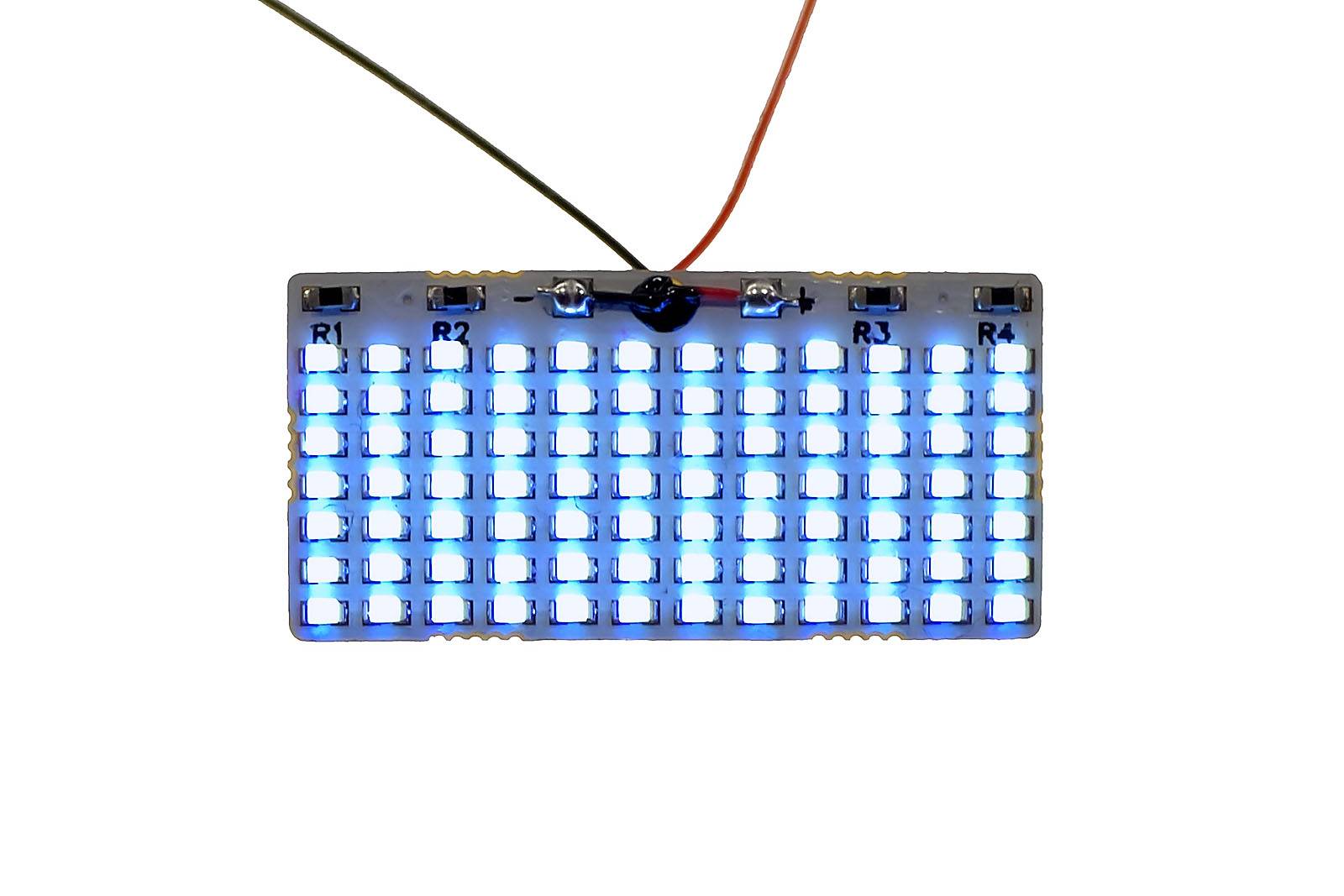

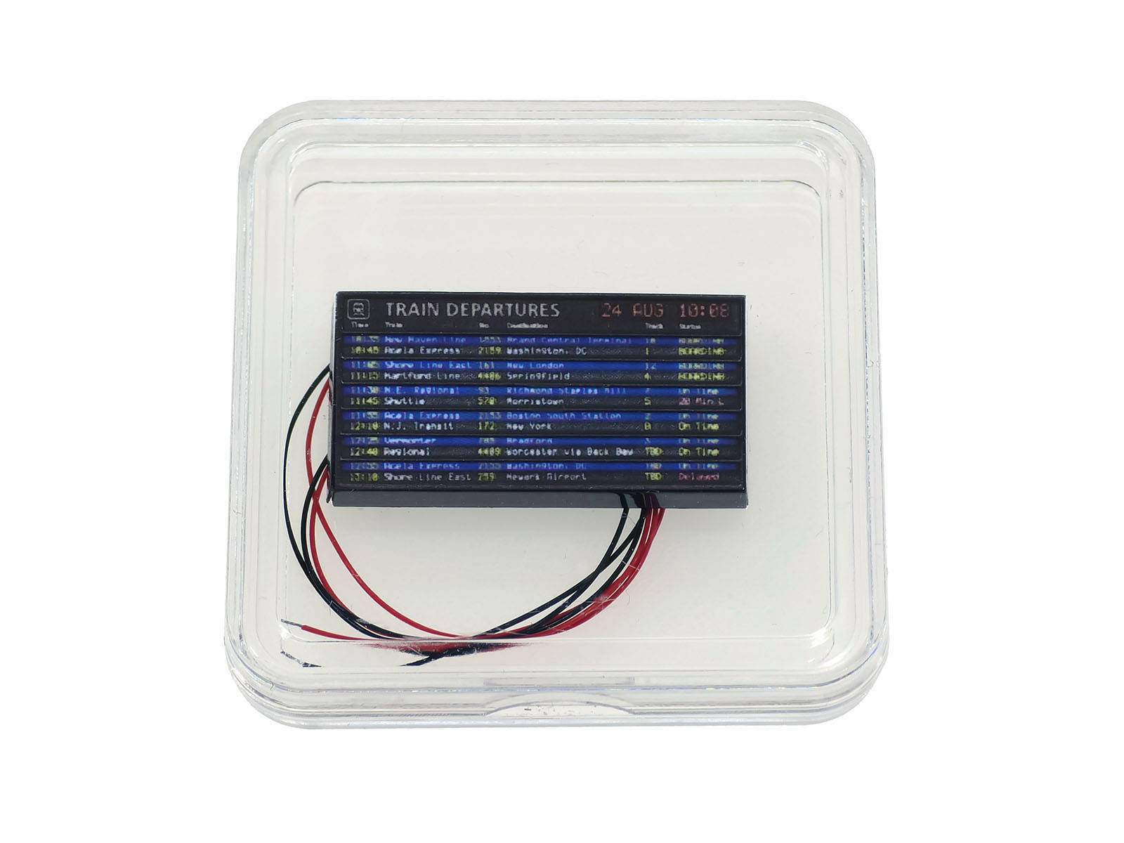

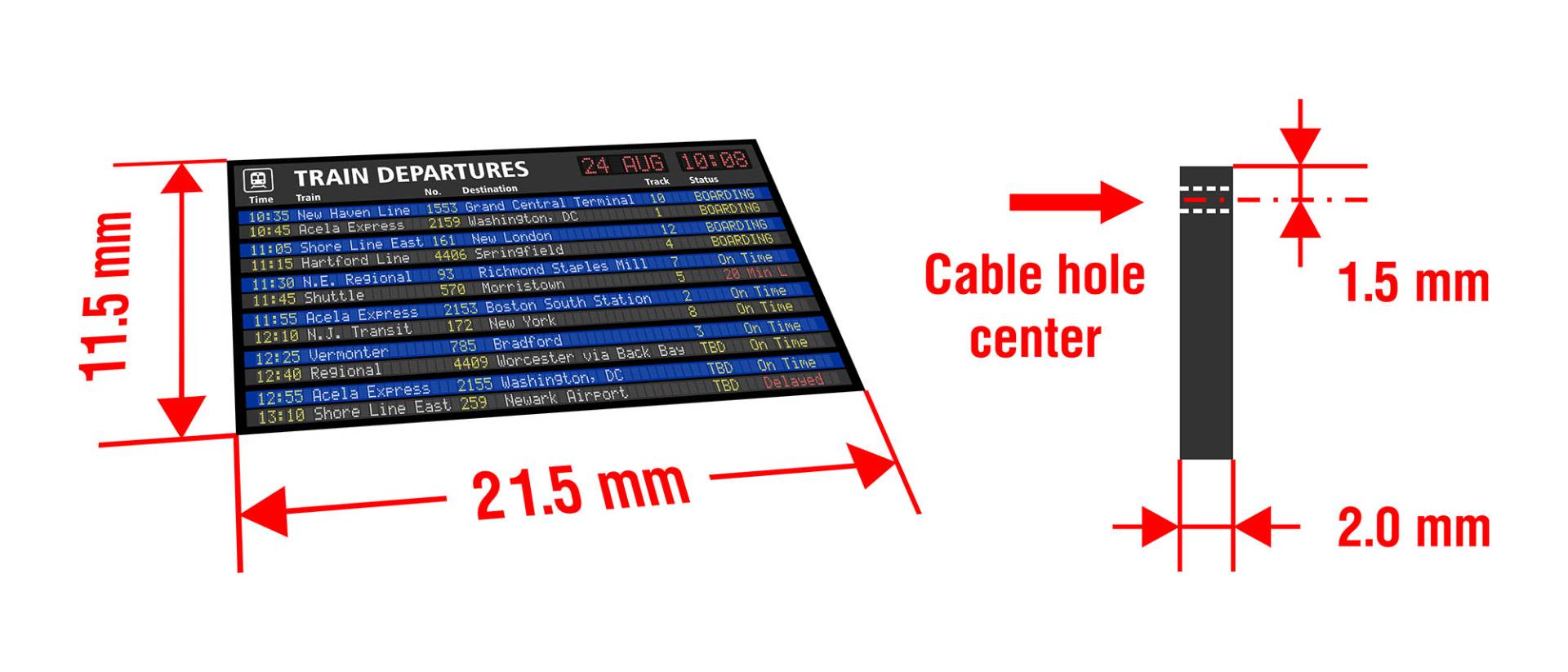

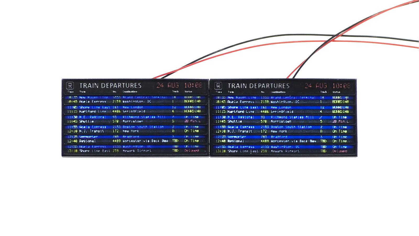

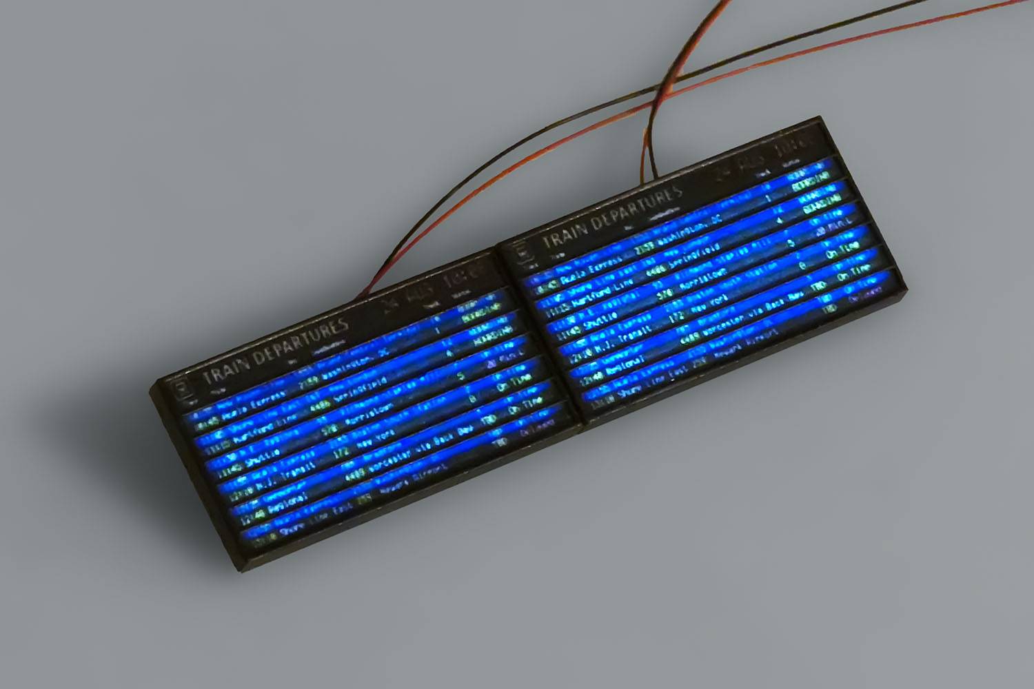

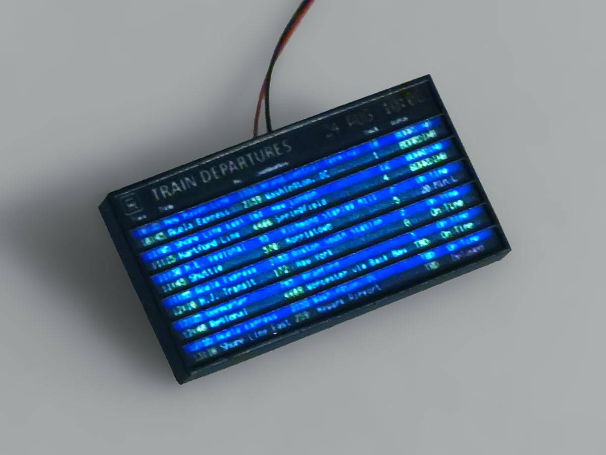

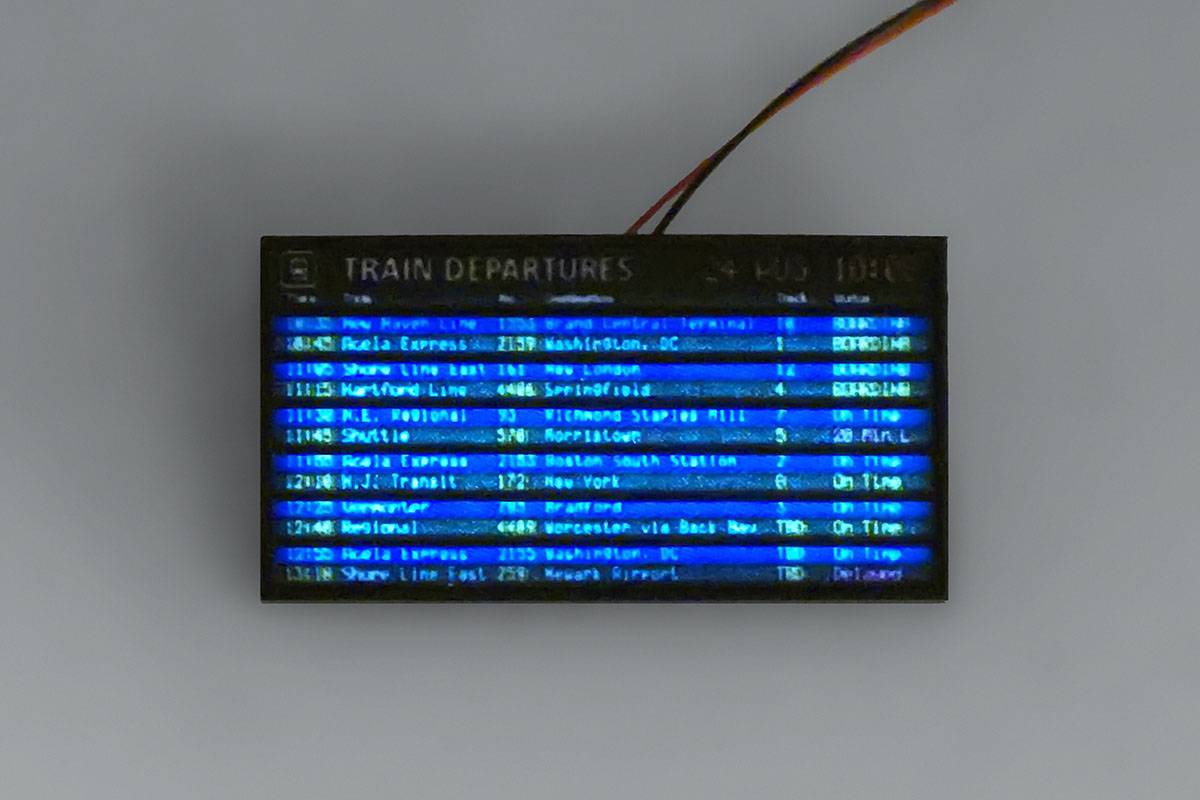

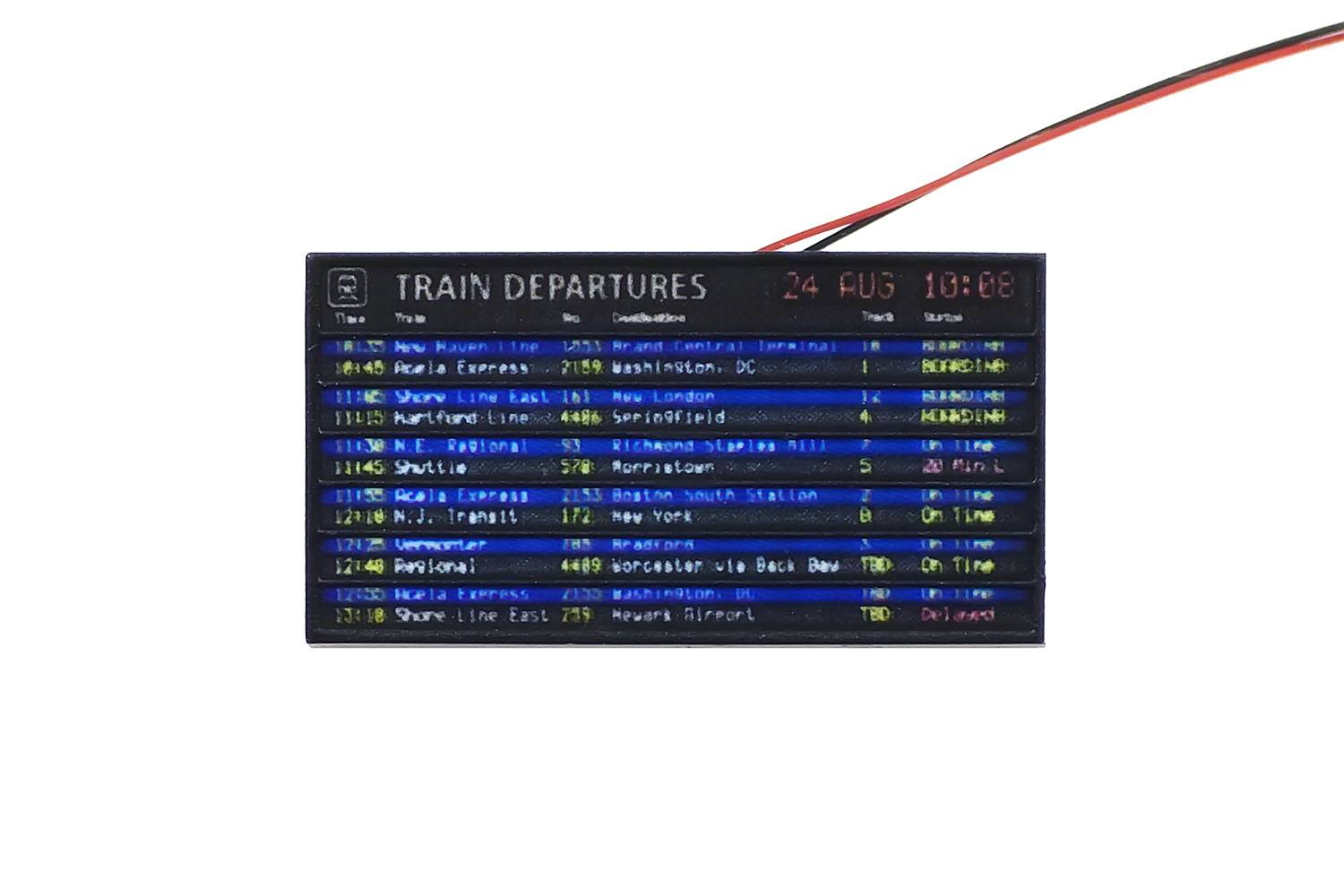

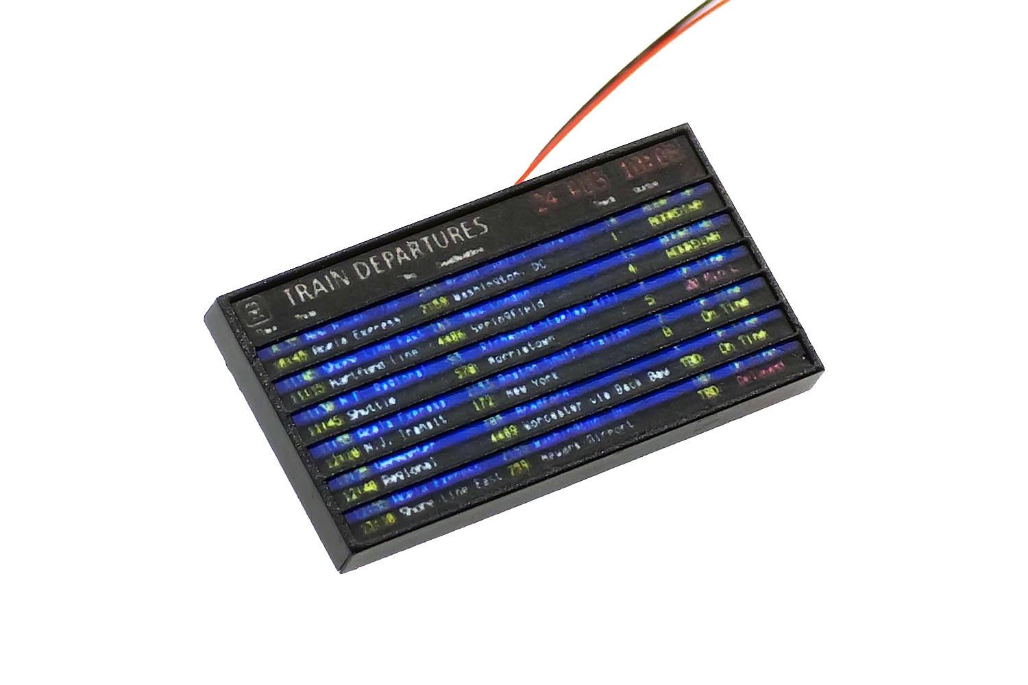

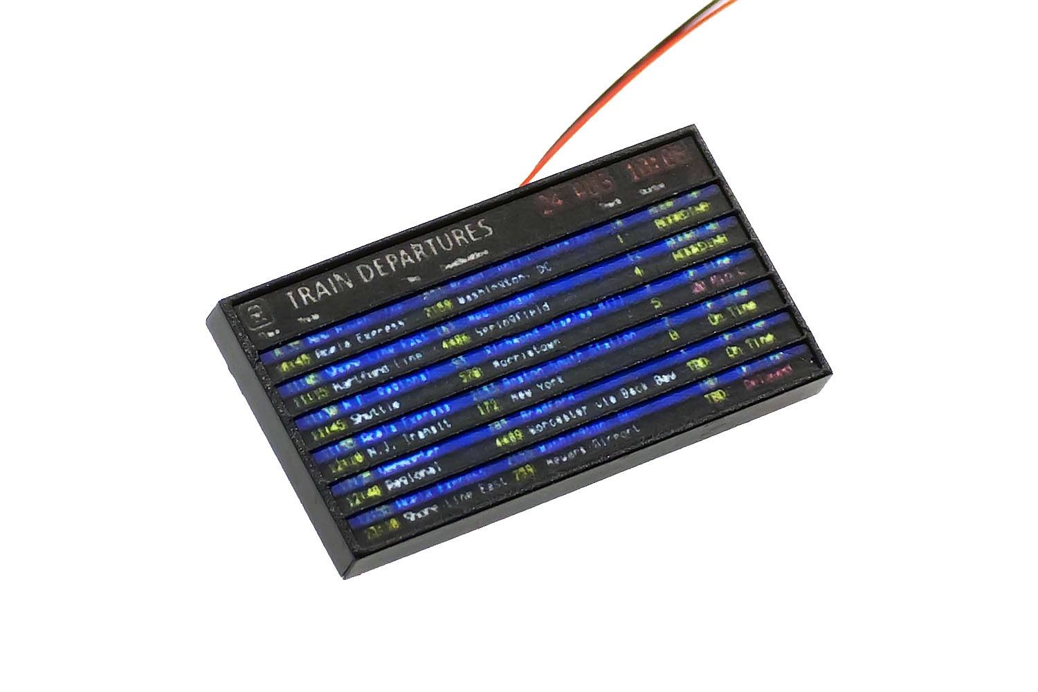

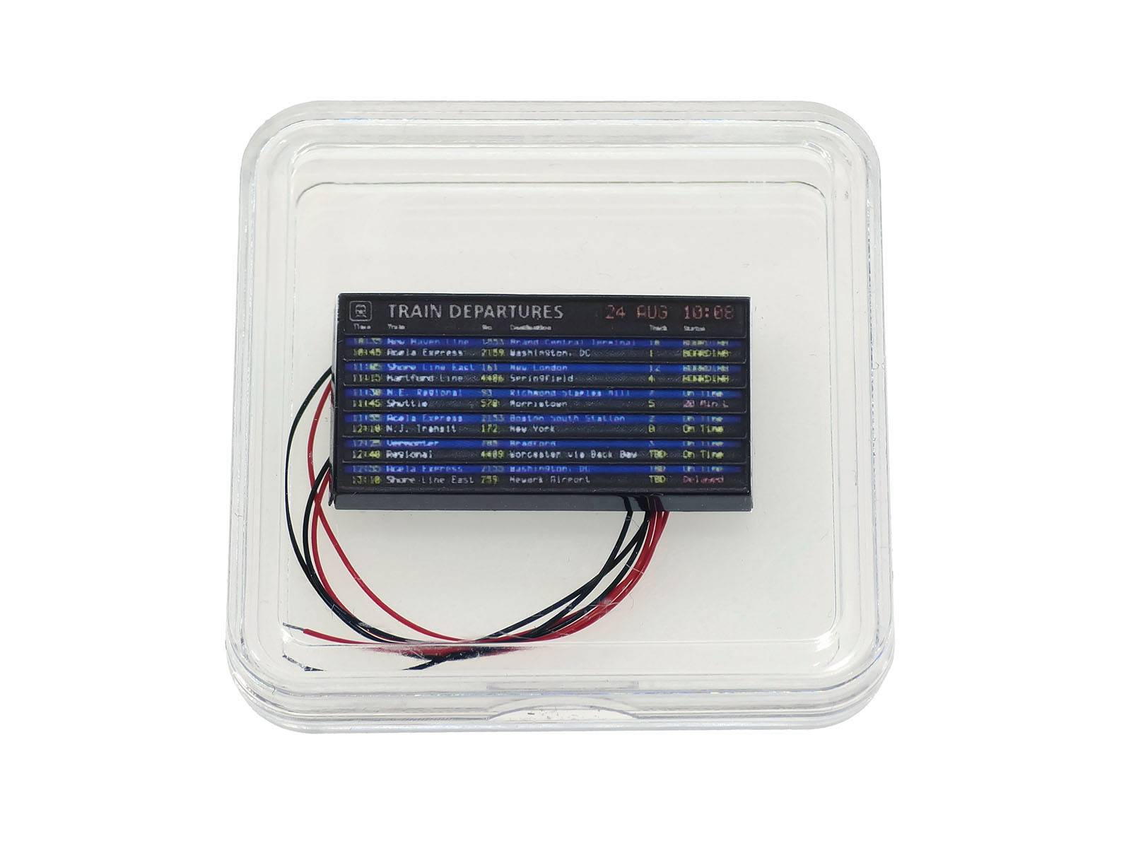

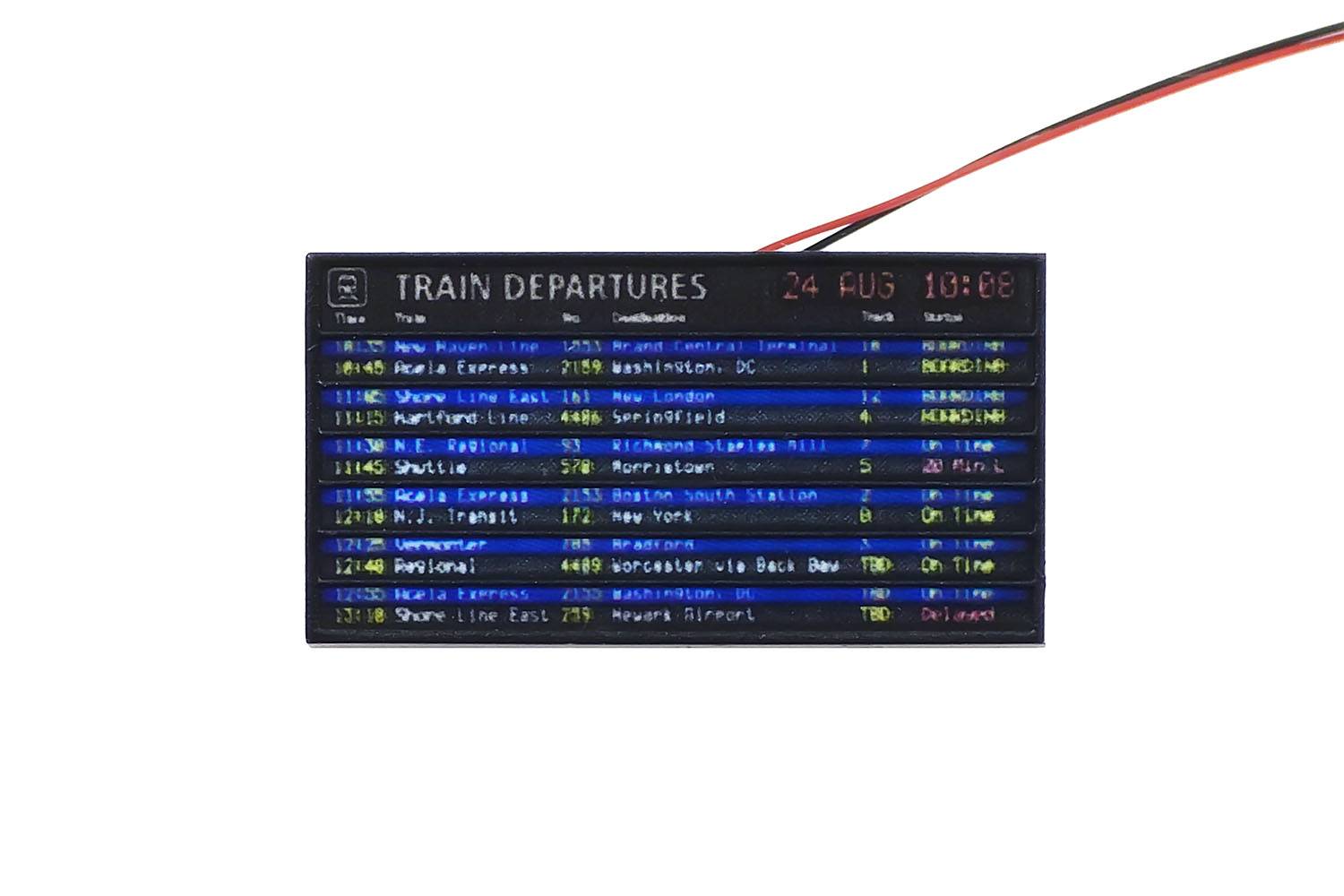

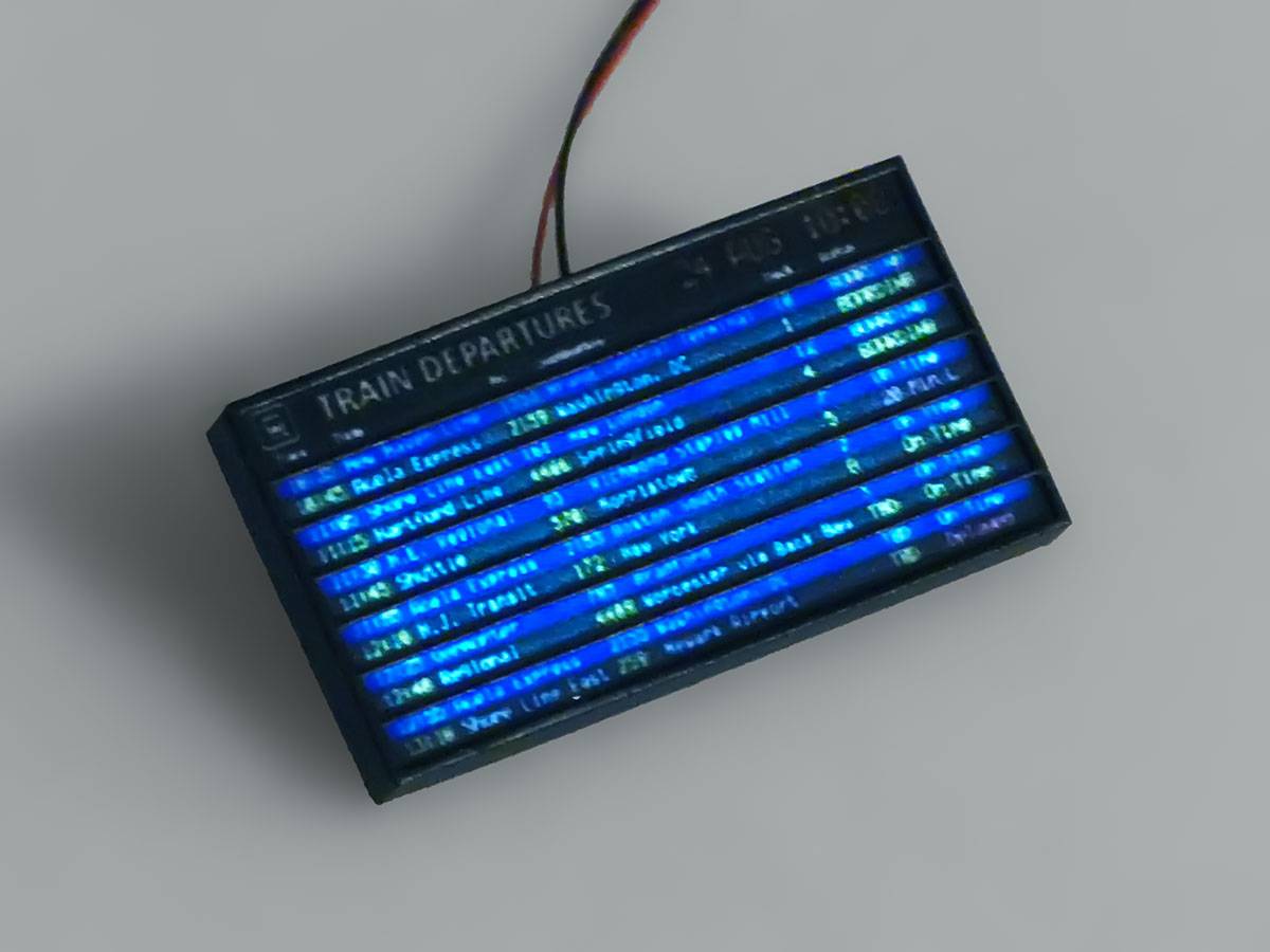

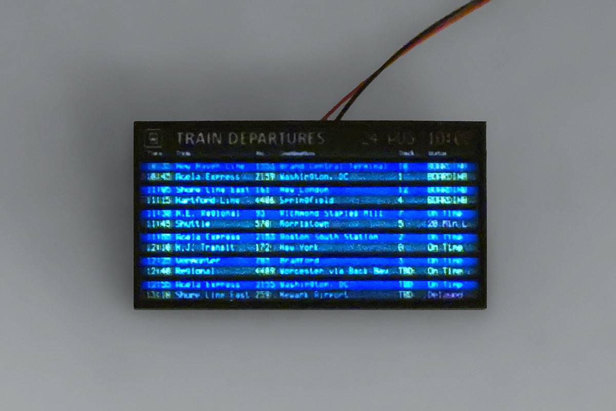

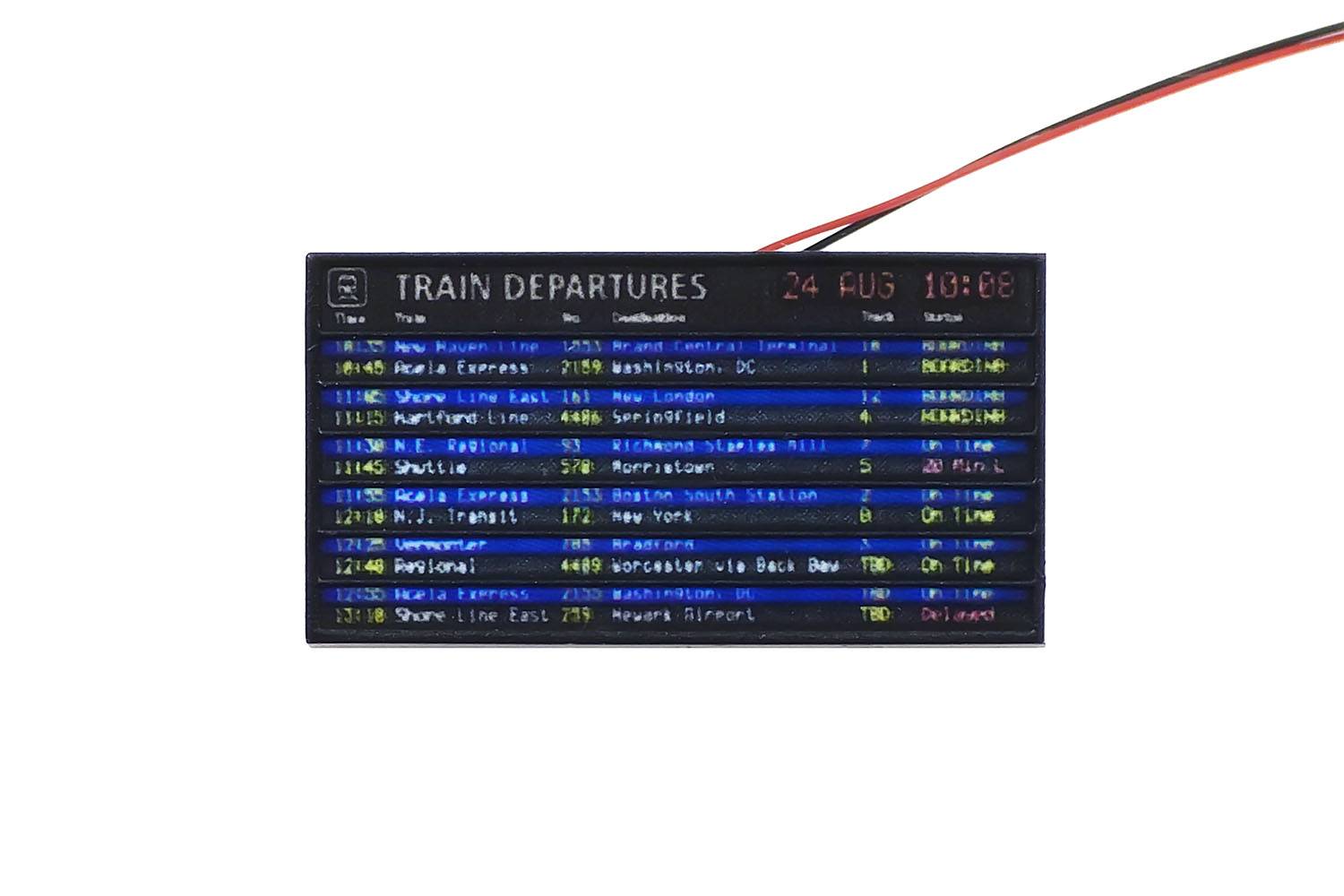

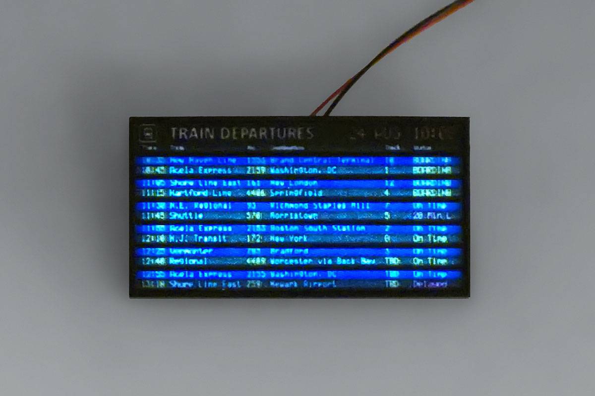

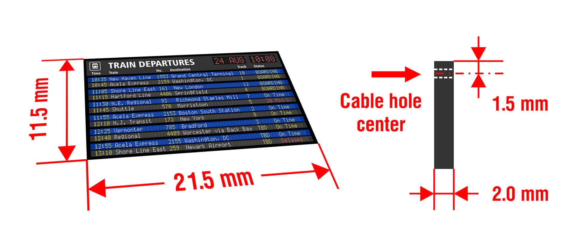

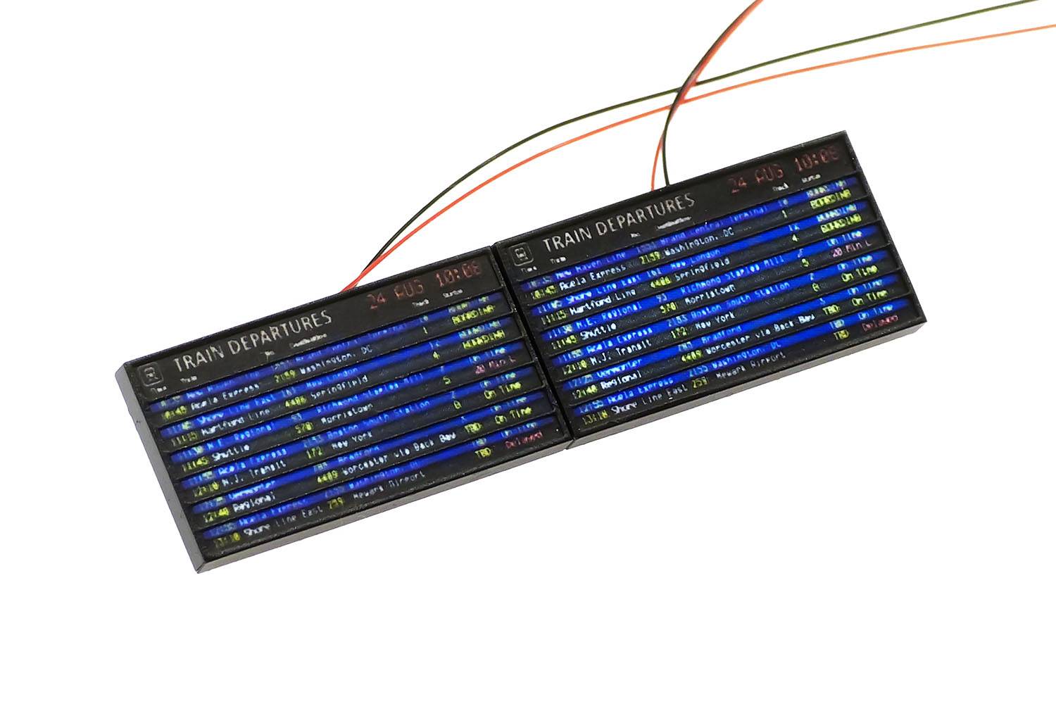

ZM-TDB-01US – Train departure board, United States version
After introducing the modern DB train departure board last year (viewtopic.php?p=323692), I was inquired by my American friends about a possibility of making the same item, but in the US style – the DB departure board has quite a specific look and therefore can hardly be used for another countries. I accepted this request and developed another variant – featuring different outer color, design of the display, train numbers and destinations. I decided to offer the new item in Europe, too. Mechanically, the new item is based on the previous design:

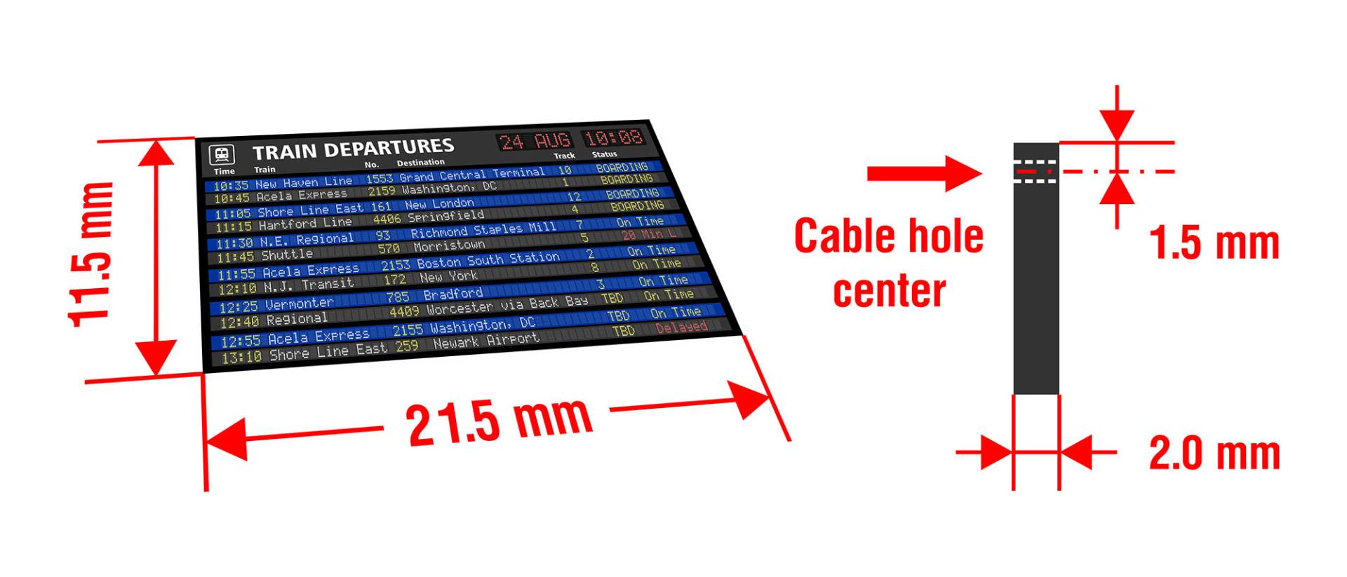

The departure board is very small – only 21.5 x 11.5 x 2 mm:

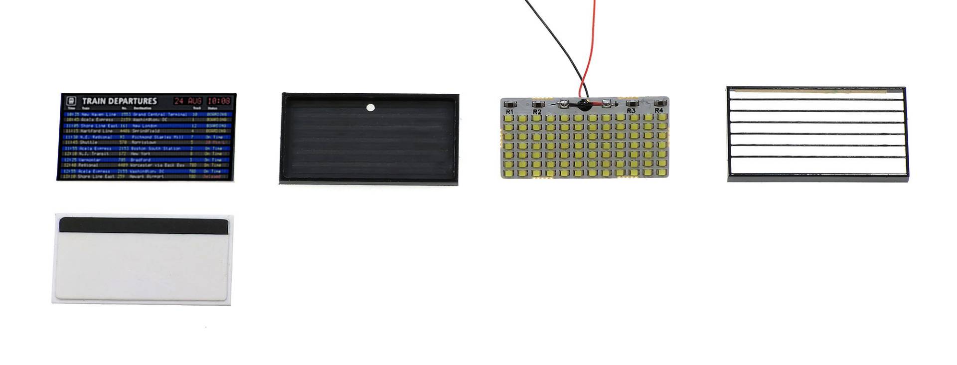

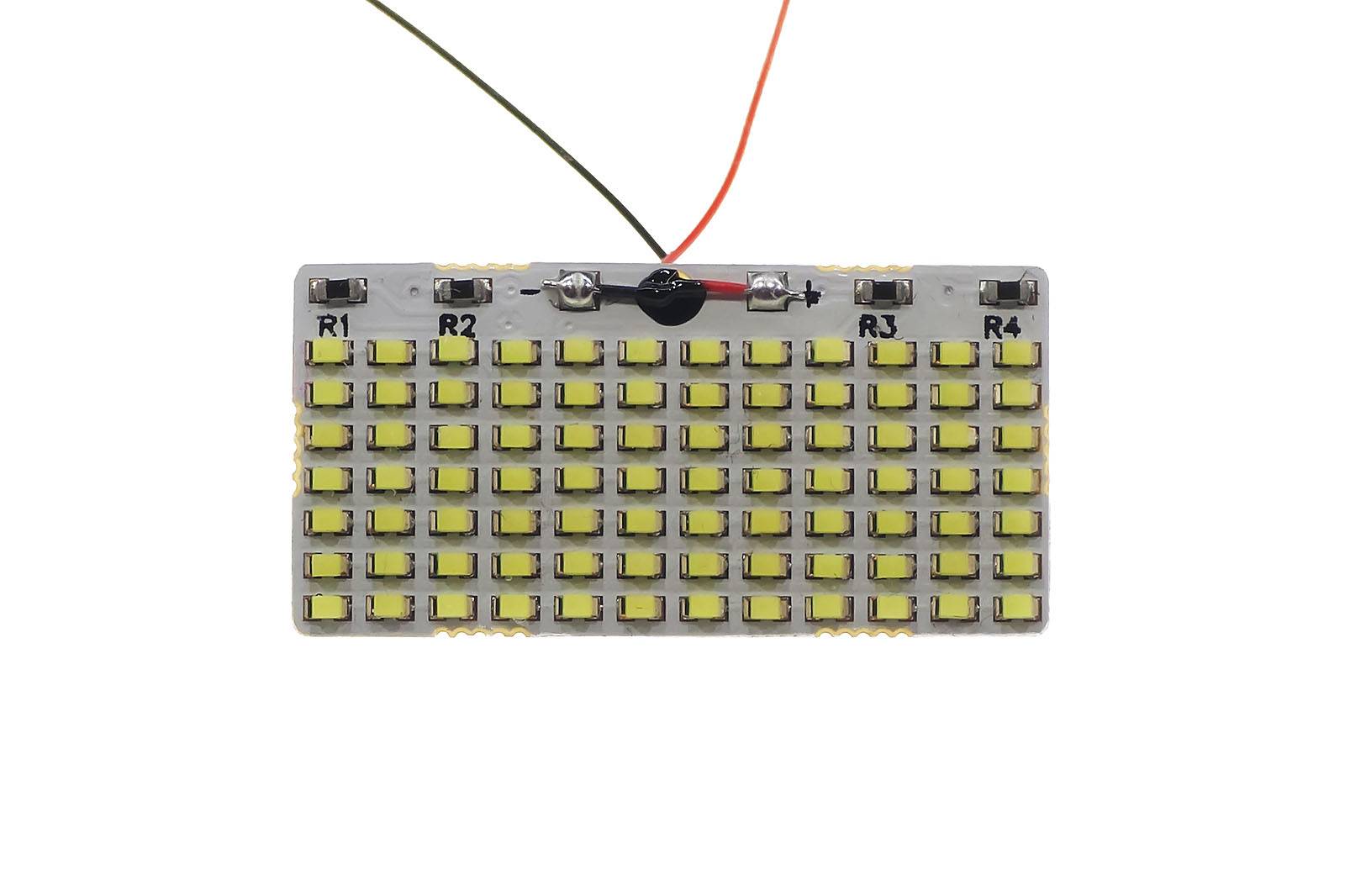

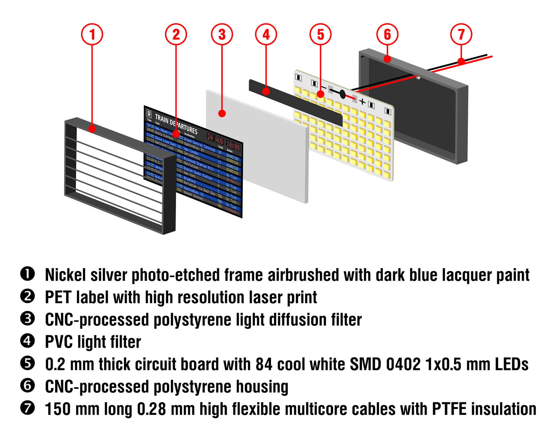

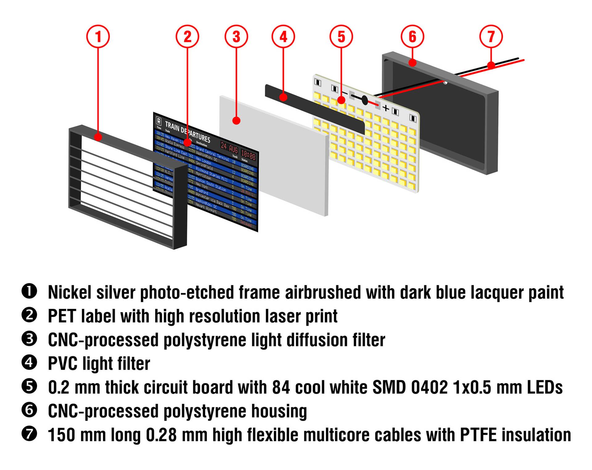

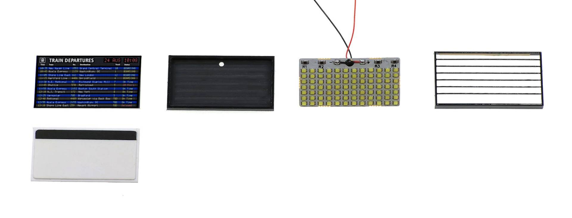

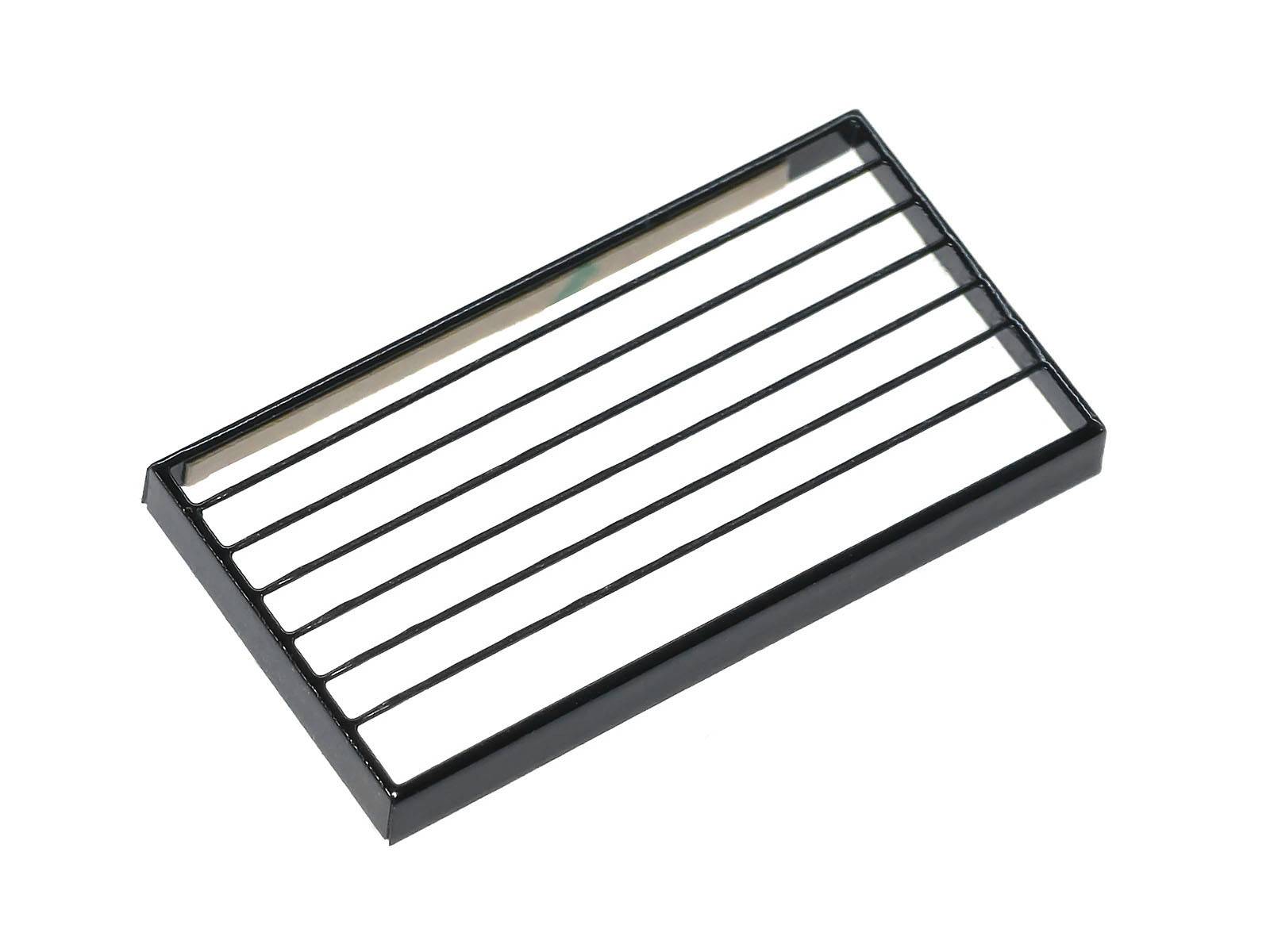

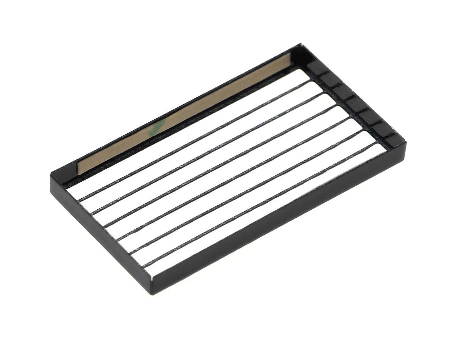

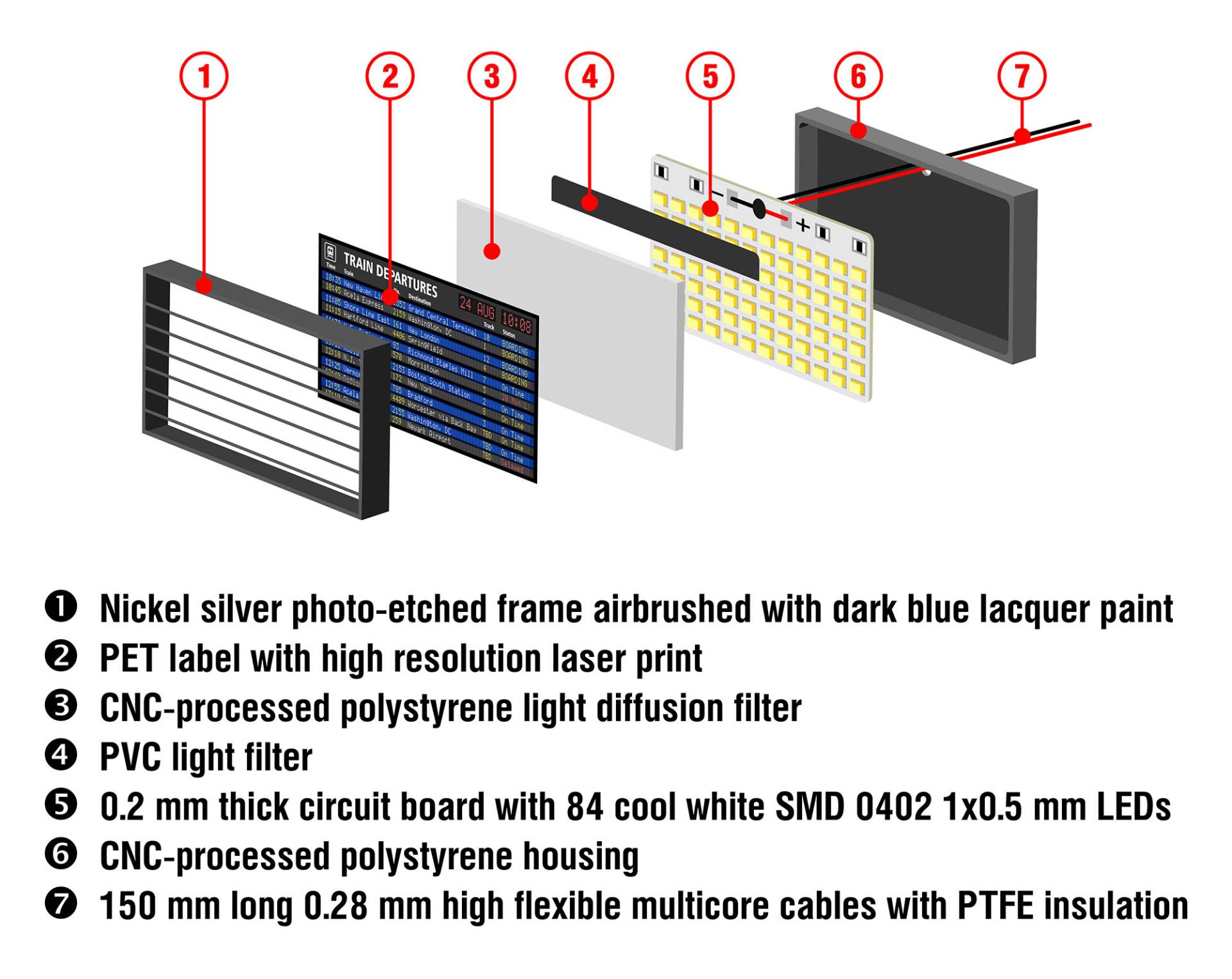

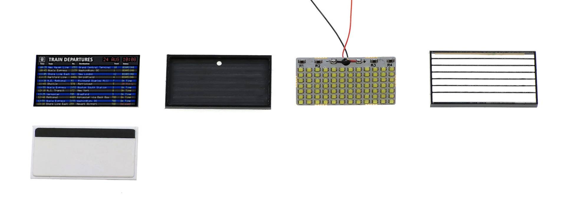

Like in previous case, the article consists of a number of different parts:

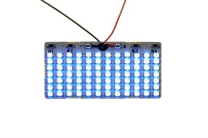

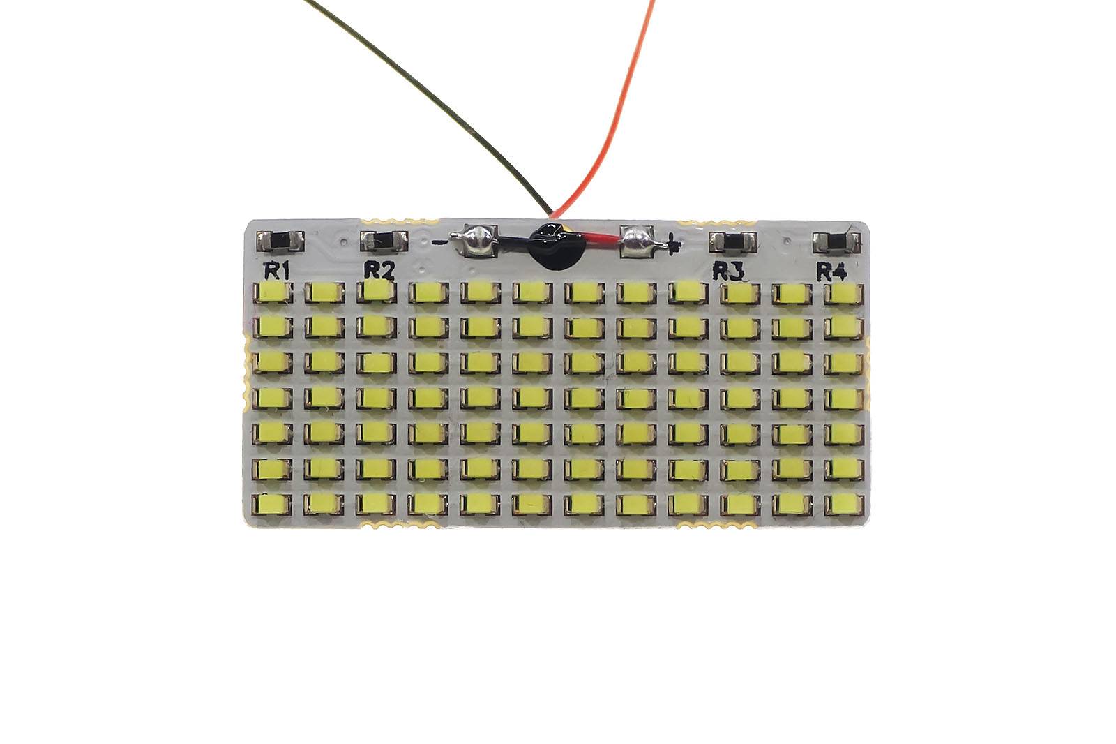

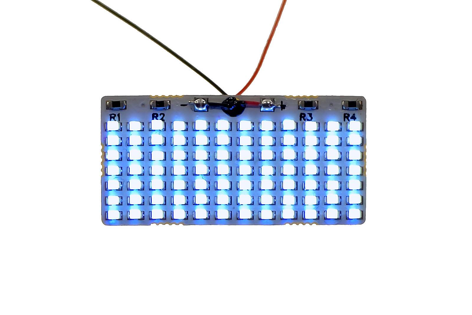

The main part is a tiny thin circuit board with 84 white LEDs:

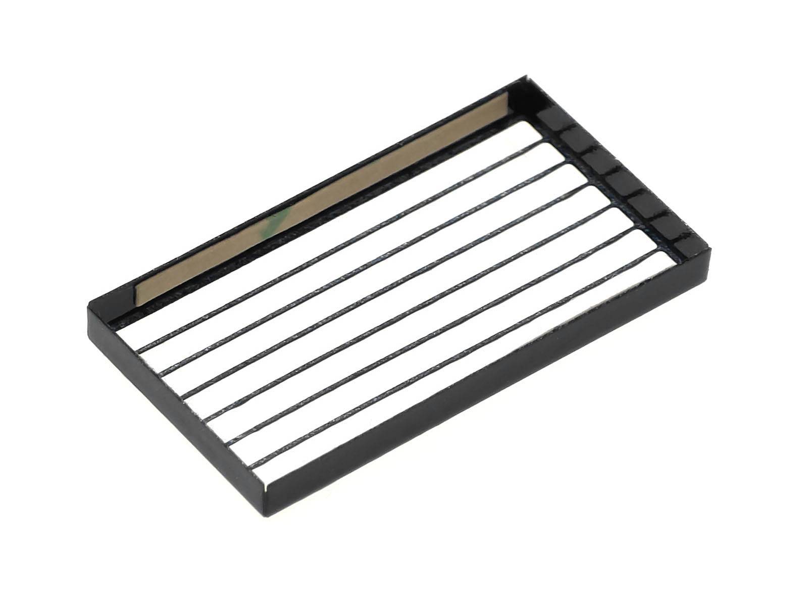

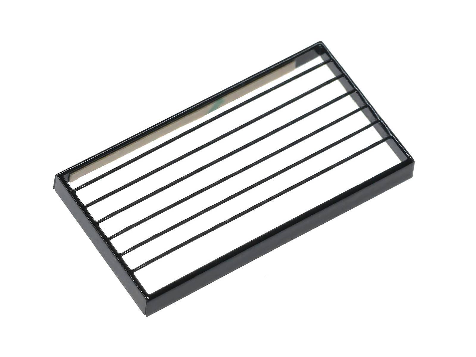

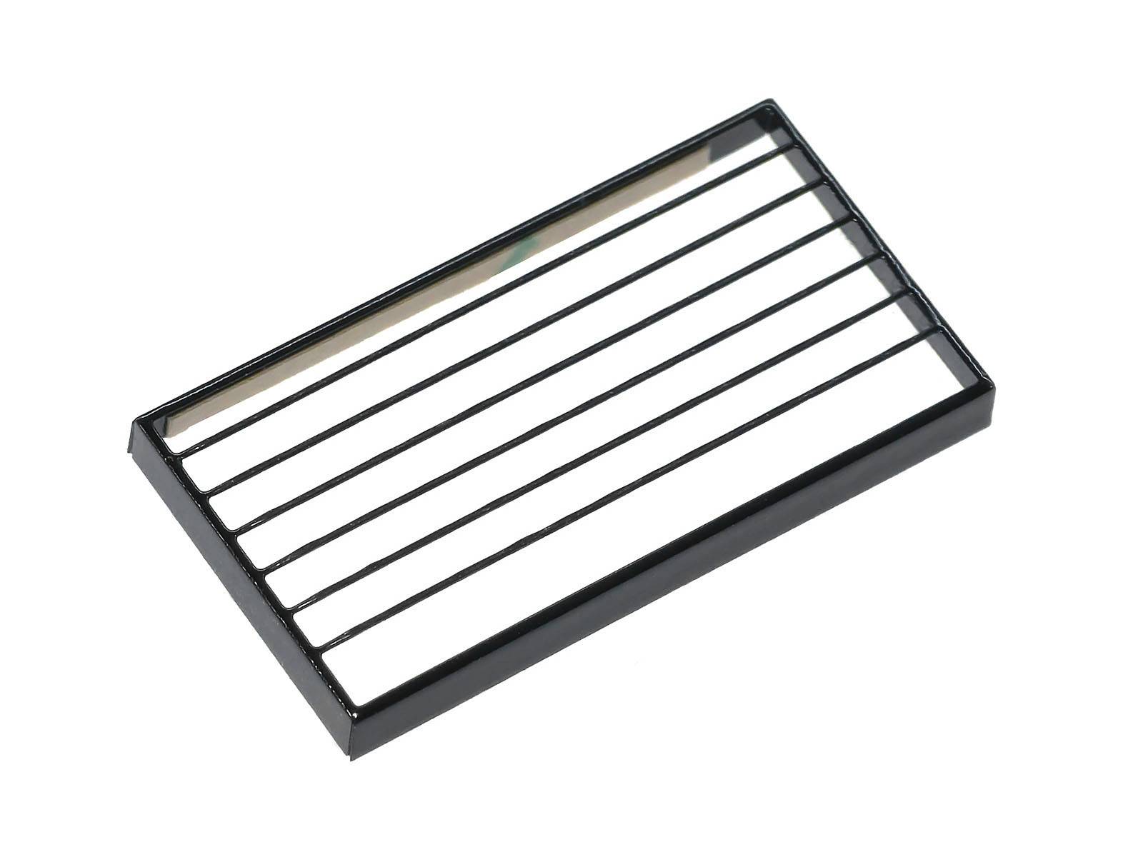

The outer frame is made of 0.1 mm etched metal and sprayed with black lacquer paint. It features ultra-thin double-sided stickers on inner sides:

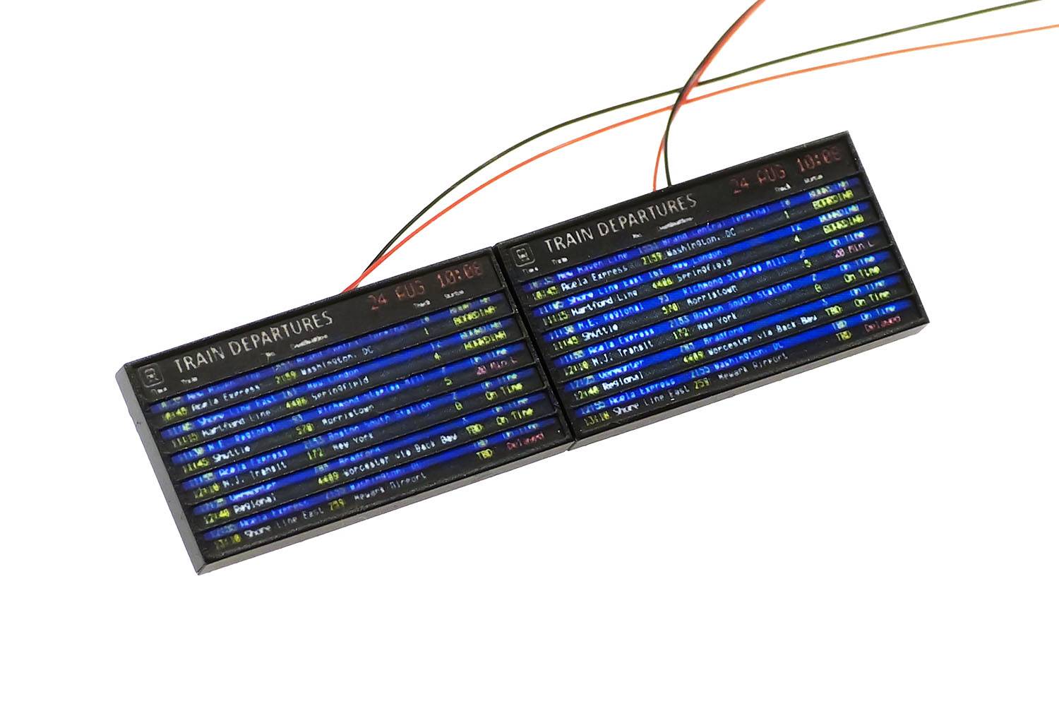

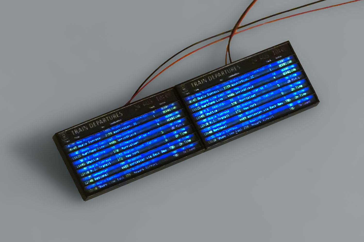

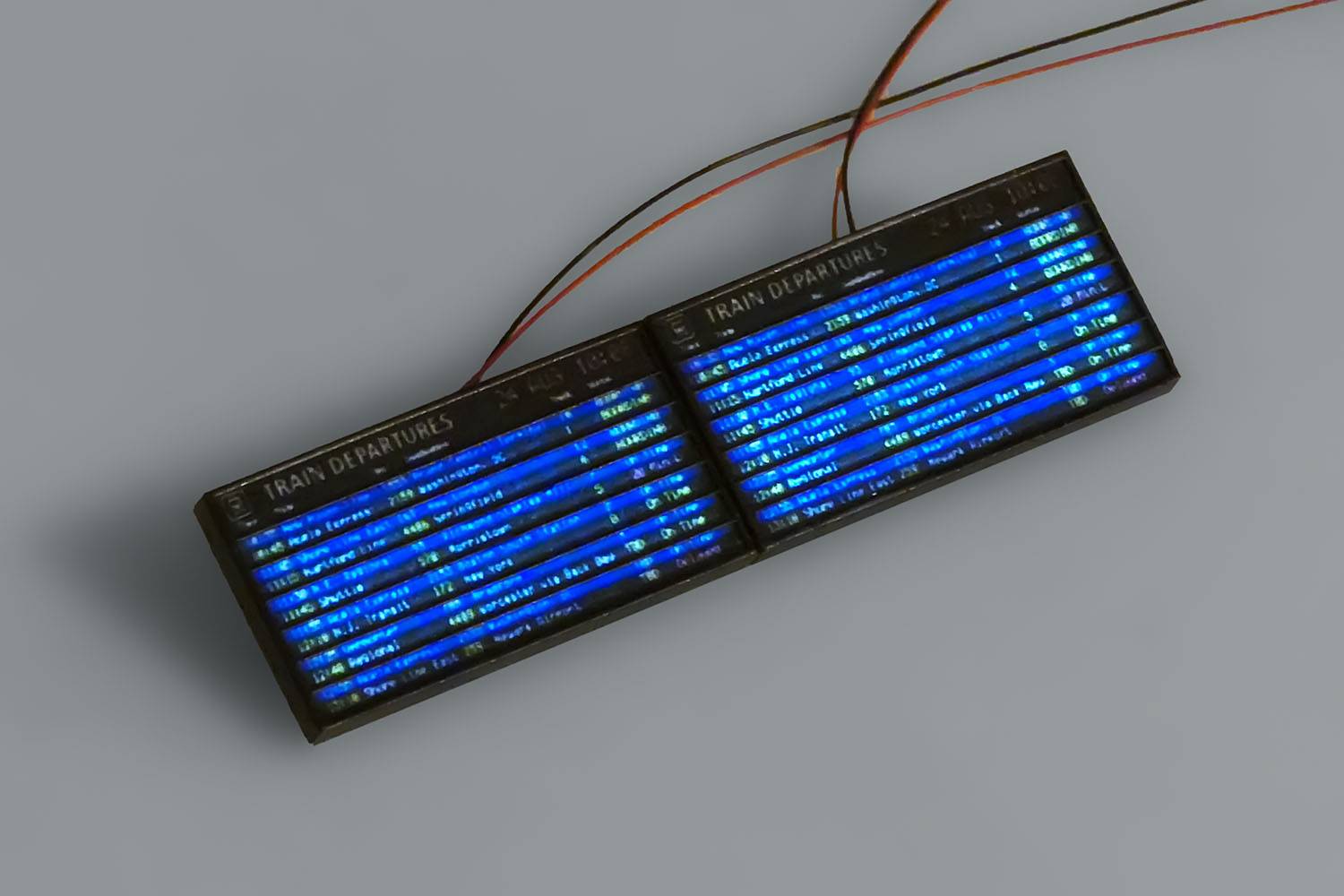

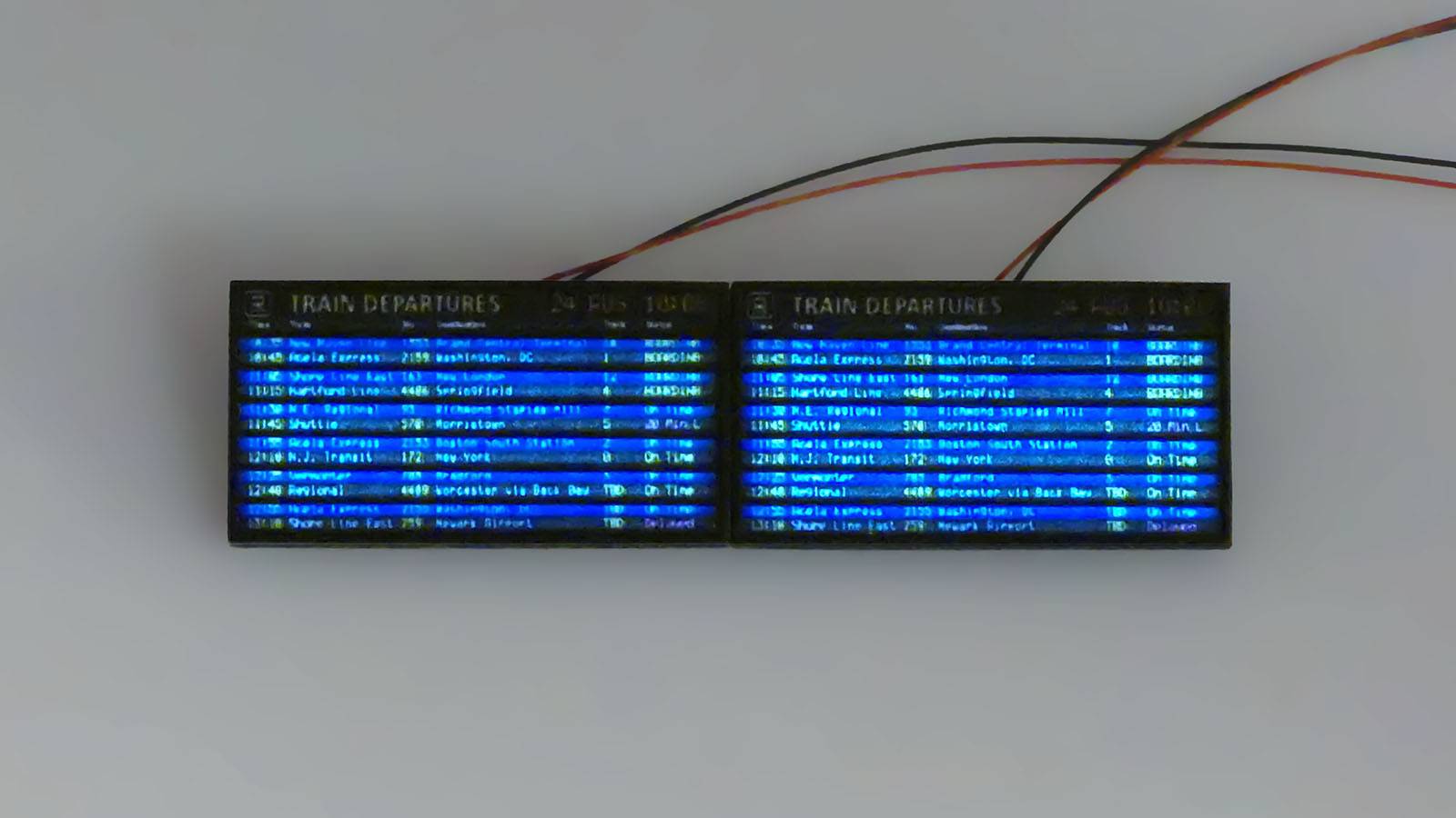

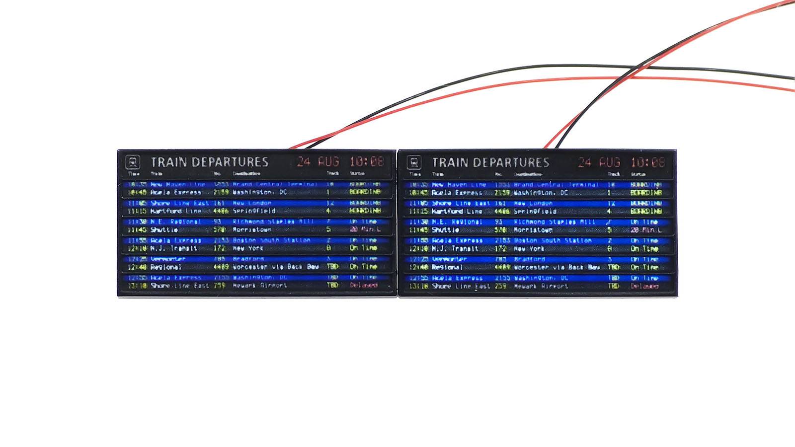

The destination boards can be used in pairs if necessary:

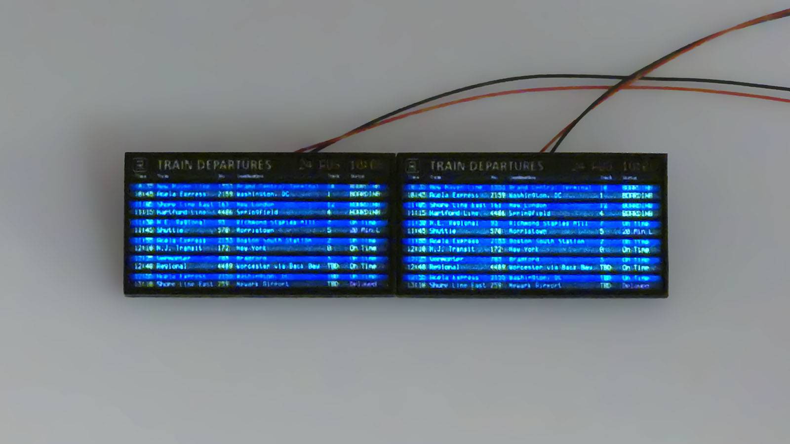

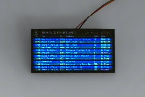

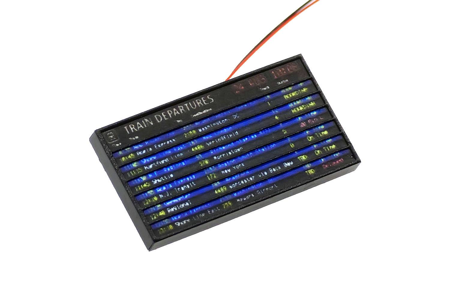

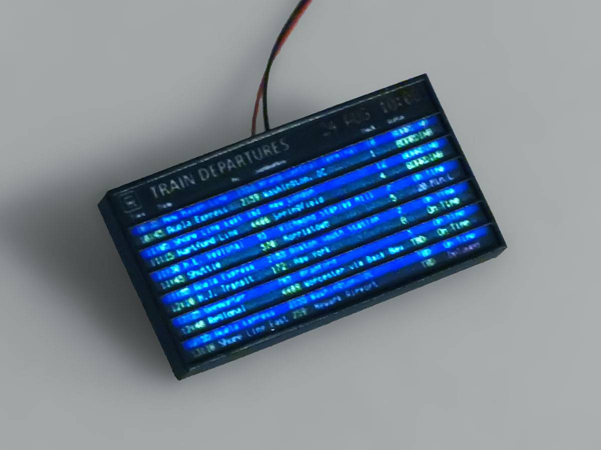

Here are some more pictures taken in low light conditions:

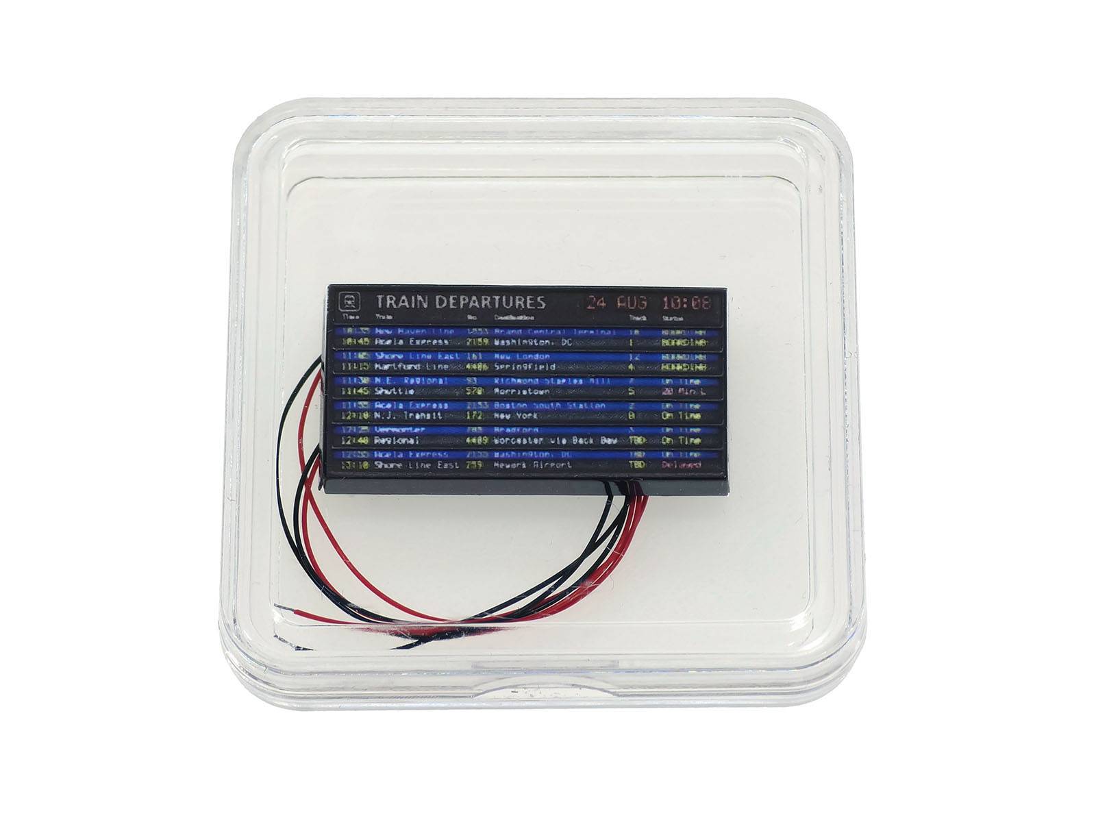

The article comes in the additional small protective box:
The user manual in PDF format is available for download here:

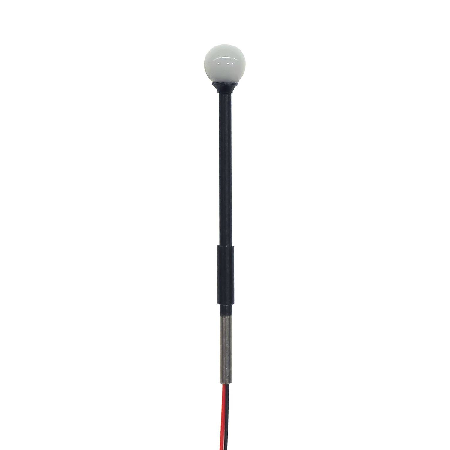

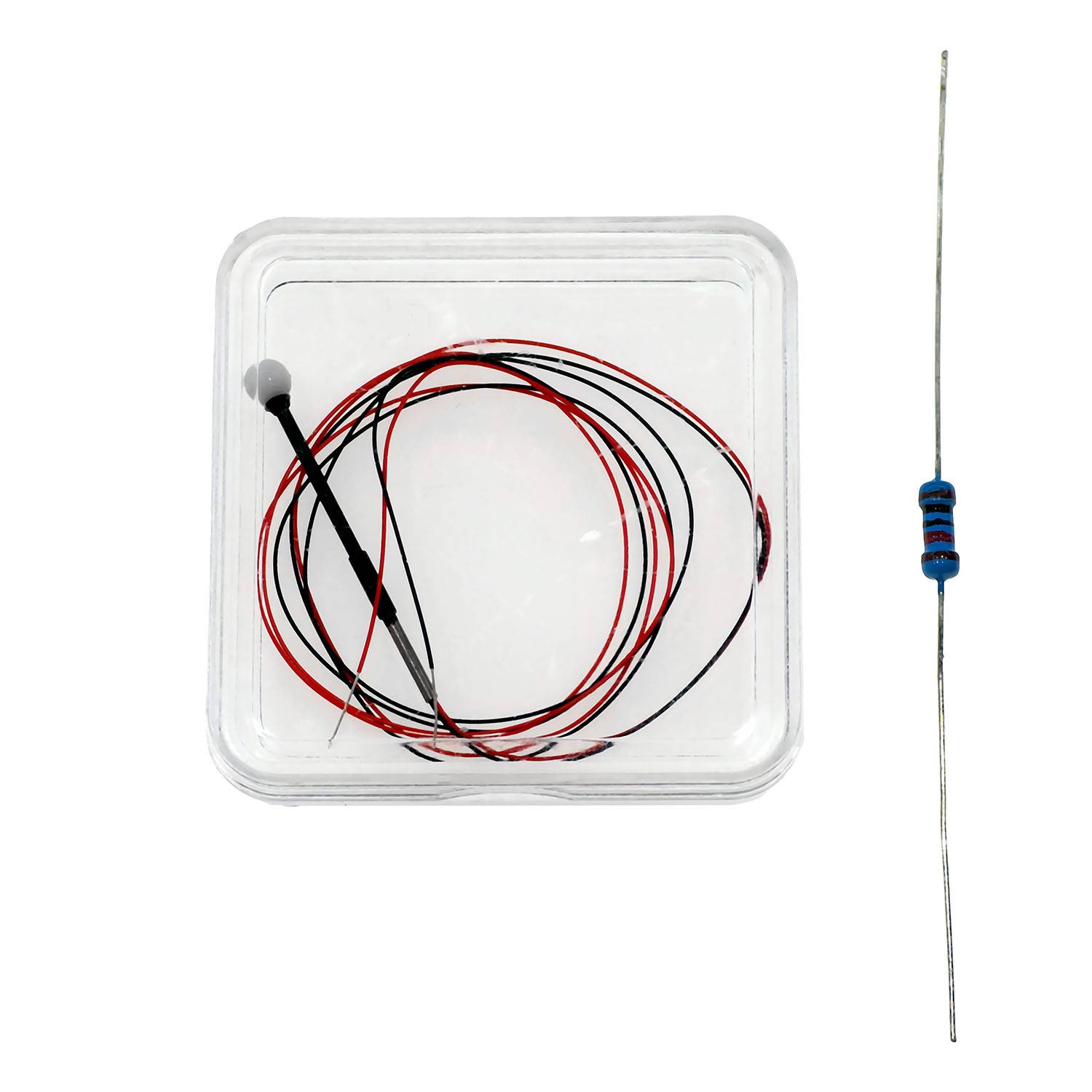

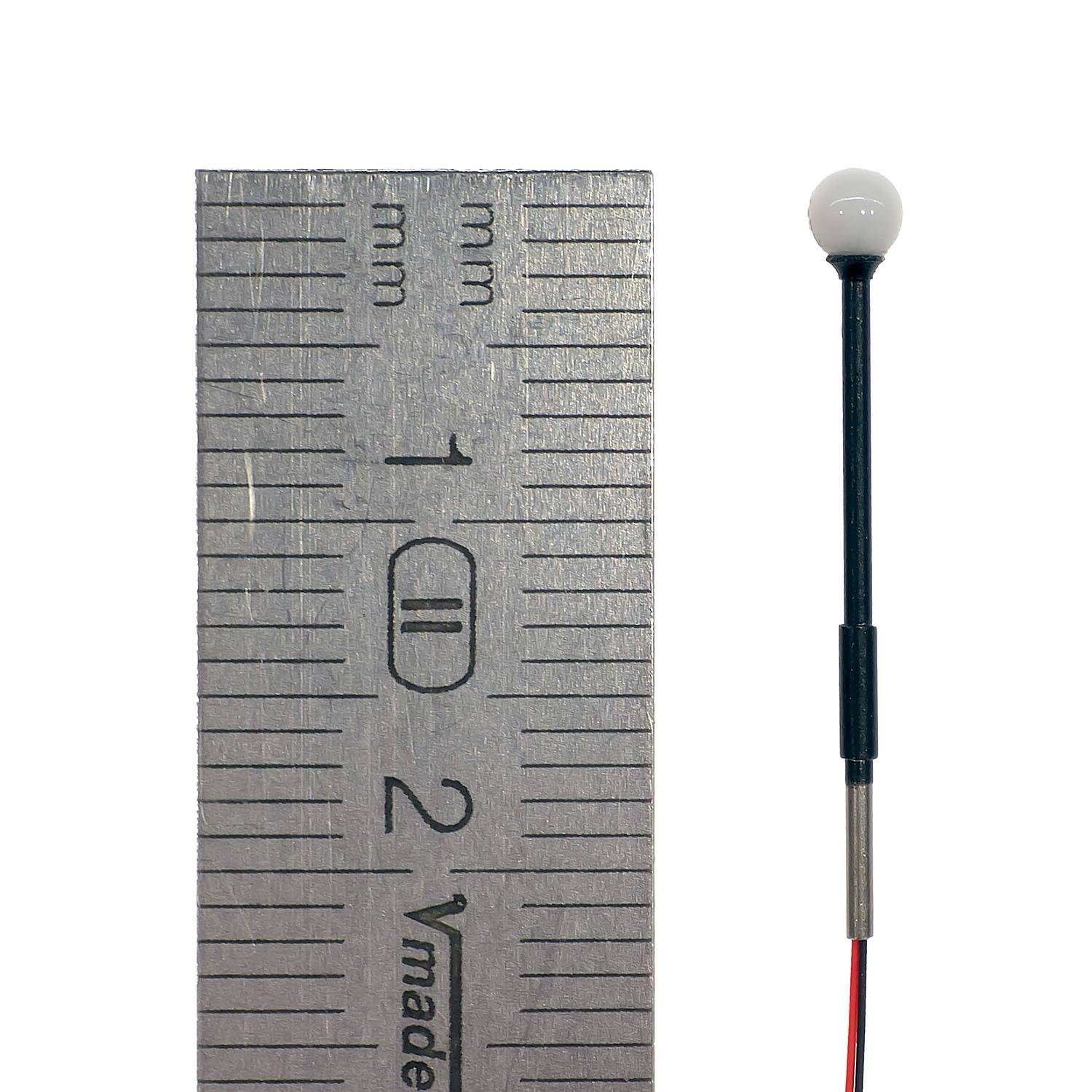

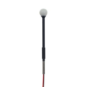

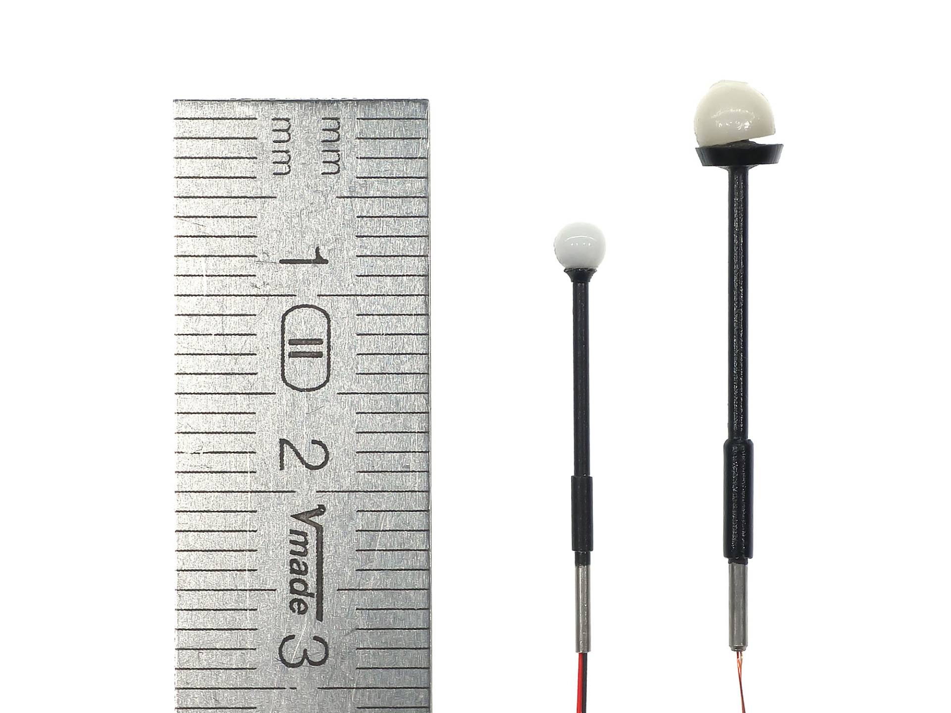

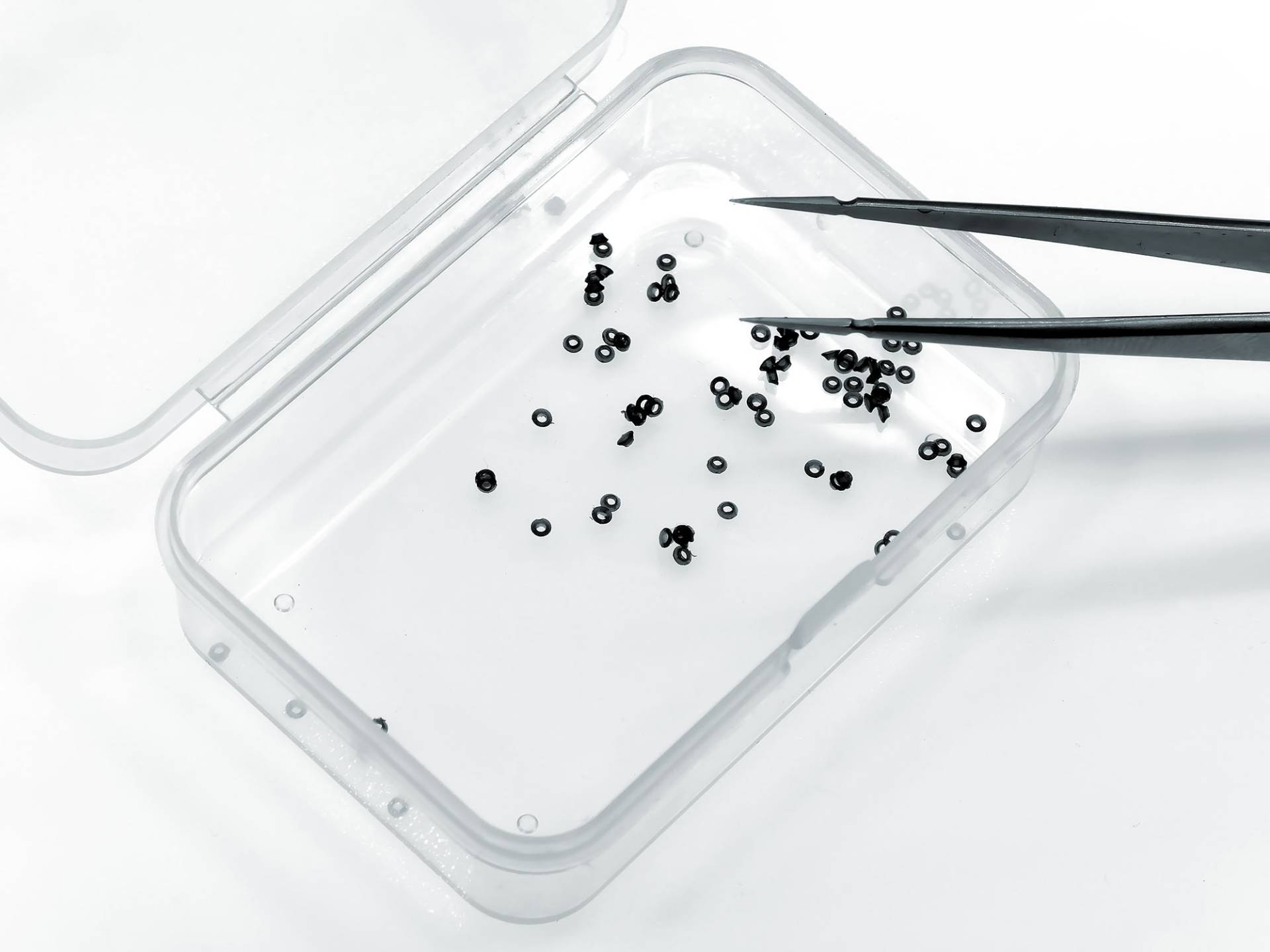

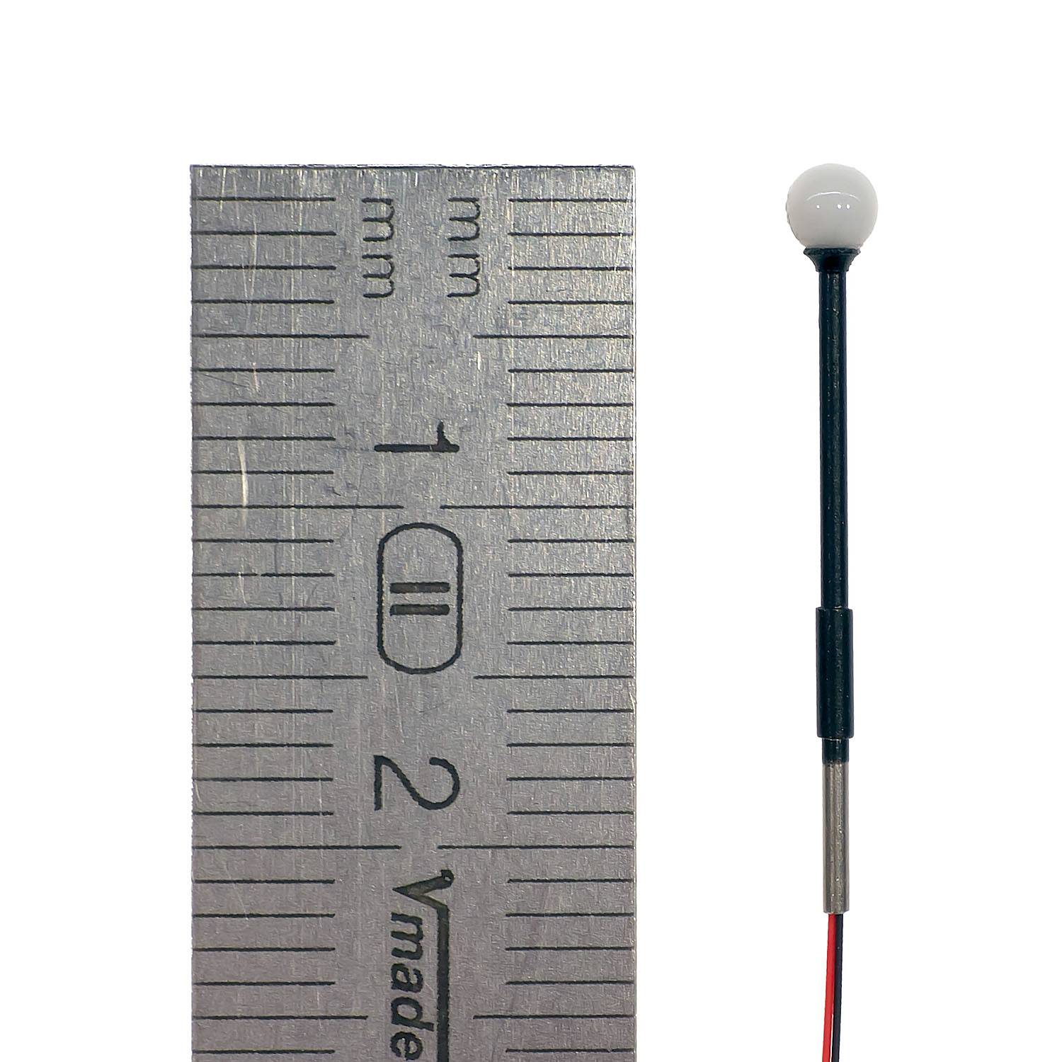

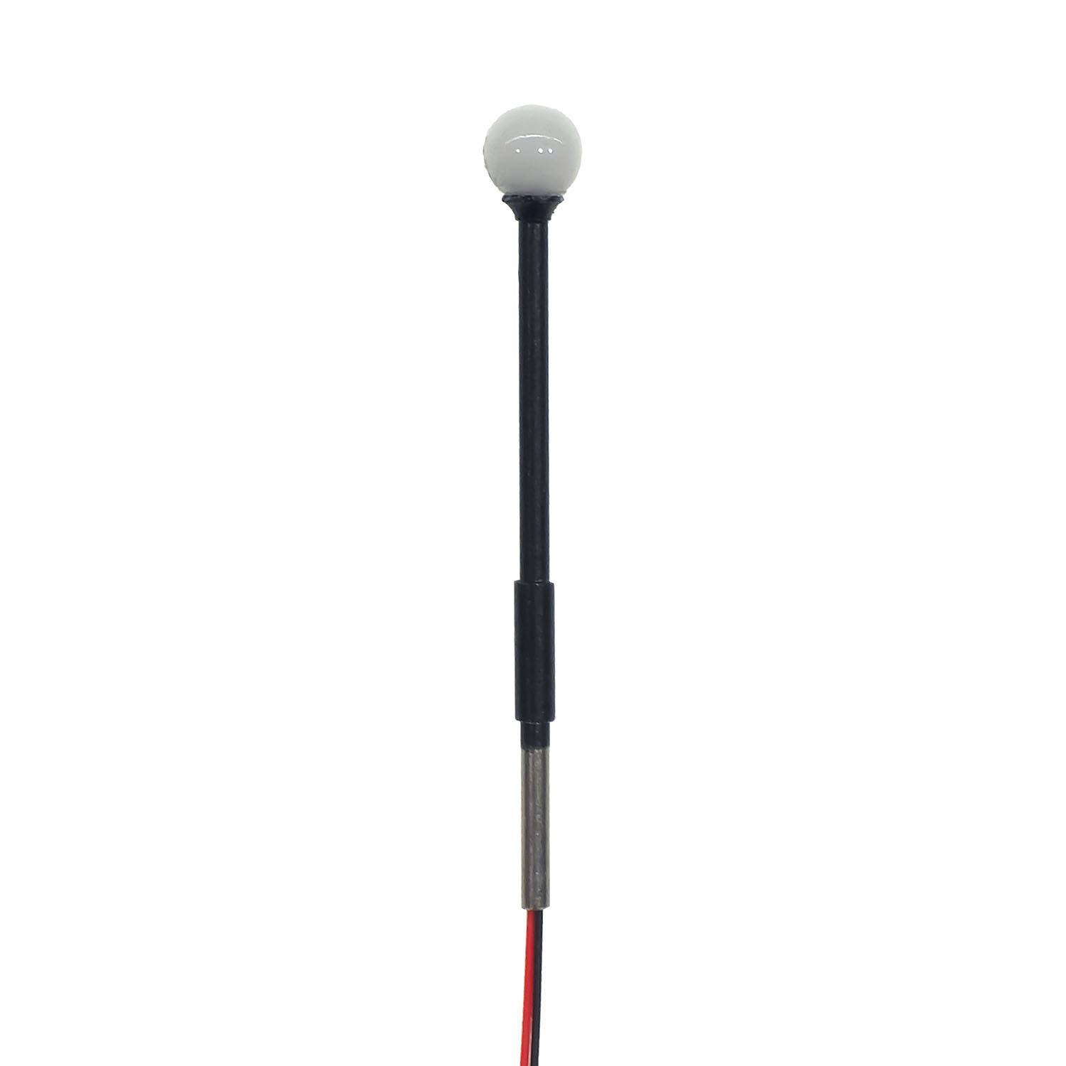

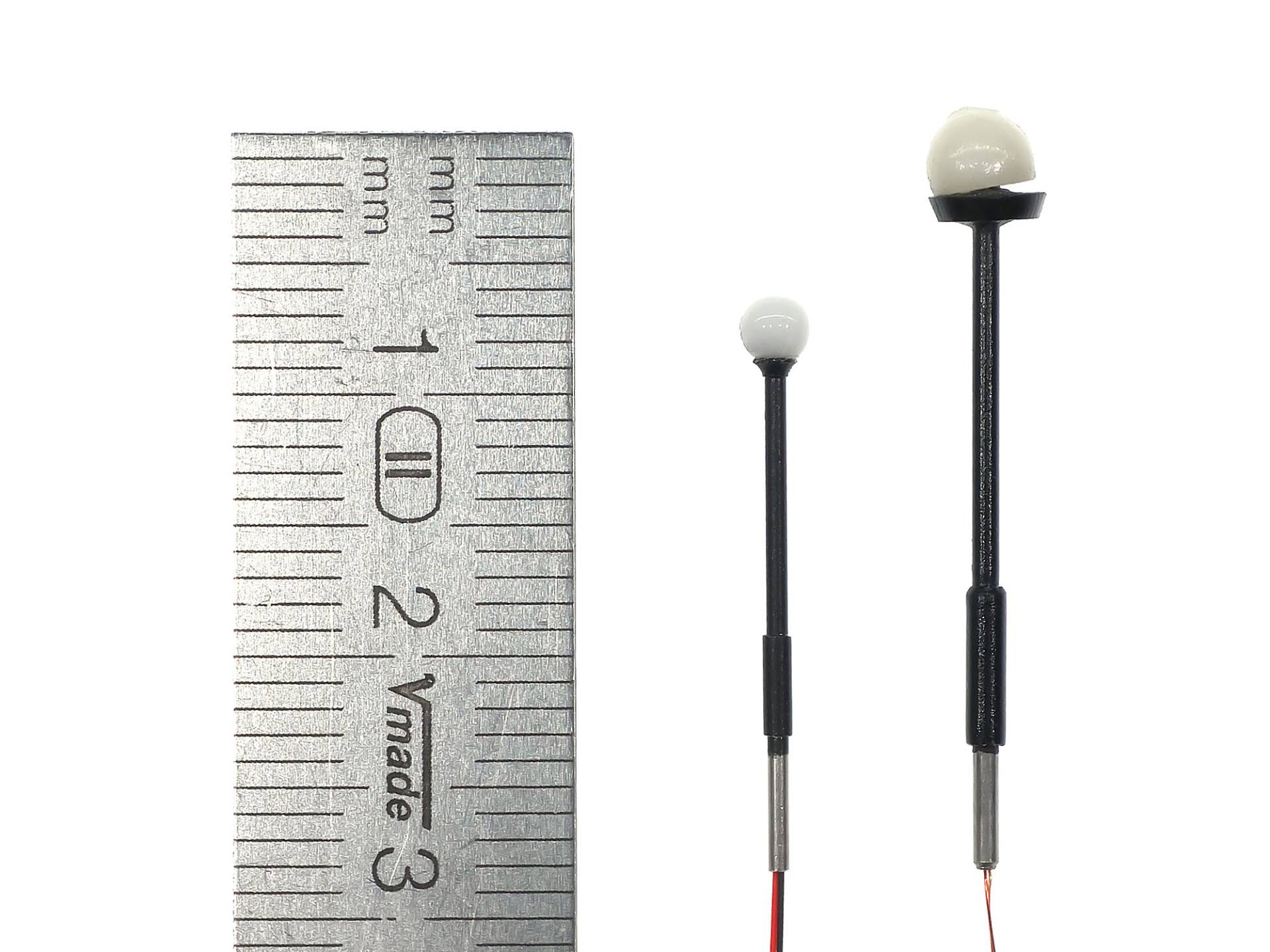

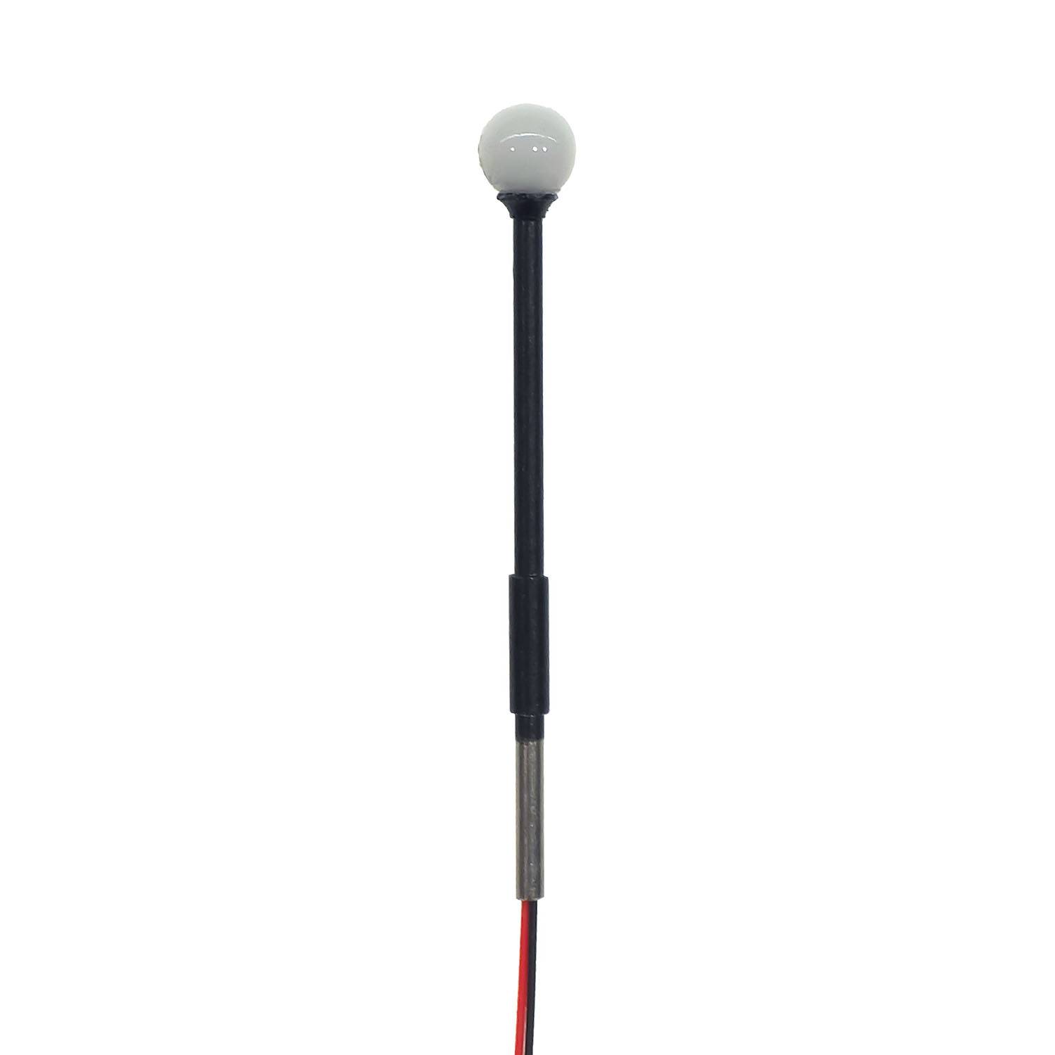

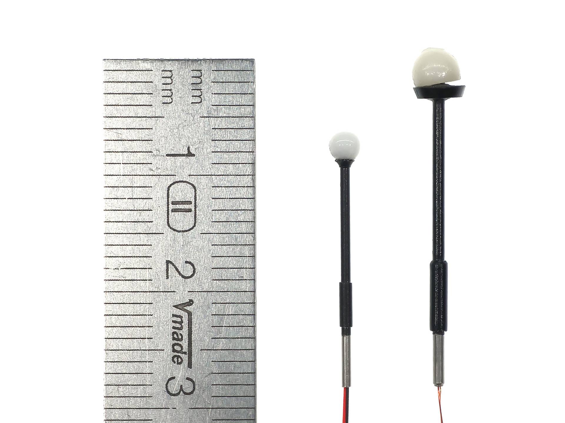

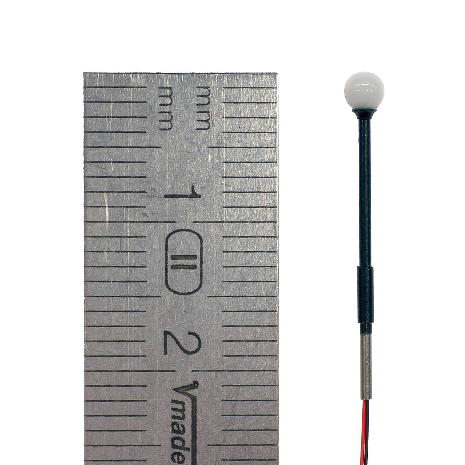

ZM-LP-01W – Park light post, Era III-VI
One of my old and long-awaiting ideas was to create prototypical-size lights for my own layout. Unfortunately, a selection of fine scale lights Märklin was offering in the past is no longer produced, while the variety of model lights from China features mediocre quality and the worst part is, it's completely out of scale. Basically, attractive prices is the only advantage of Chinese model lights. You can easily use their “Z scale” lights on N scale or even bigger scales layouts and so on.
During last months, I finally managed to find some time to realize this project. I decided to start from park light poles. Expectedly, the most challenging part was to find a way to make the light as close to prototypical dimensions as possible. At the same time, I kept in mind desired model rigidity and ease of installation that is also important to customers. Here is the first model from the new series:
The light is 17 mm high (without underground section) that corresponds to 3.74 meters in 1:1 scale – quite a typical light pole used in parks and other recreational areas along alleys and pathways:
The diameter of the thin part of the pole is 0.8 mm. The pole is made of precisely cut stainless steel tubes with different diameters. The size of the ball is 2.5 mm. During designing the light, I came to conclusion that adding one small element greatly increases the realism of the product – I developed pedestals for the light balls and 3D printed them – it is the smallest parts I ever made at all:
Zuletzt geändert von Alex_dn am Di 24. Mär 2026, 01:37, insgesamt 4-mal geändert.
Alex_dn
- Beiträge: 1395
- Hat sich bedankt: 49 Mal
- Danksagung erhalten: 933 Mal
Re: Zmodell novelties 2026

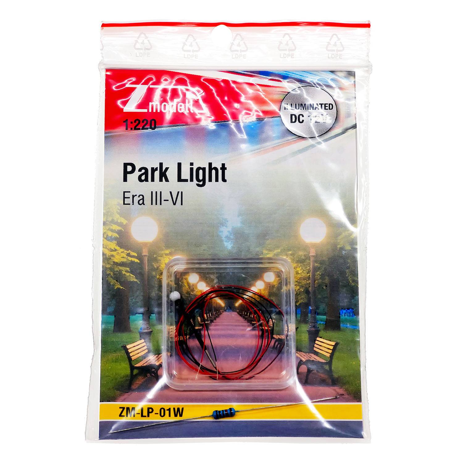

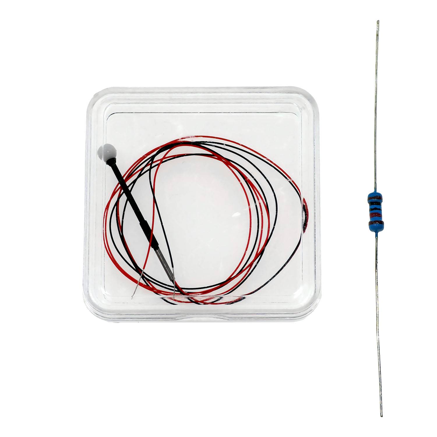

The underground part is 5 mm long. The light is equipped with warm white 0402 LED that has a special color tone that resembles the light of energy saving or fluorescent lamps – predecessors of modern LED lighting. White glossy opaque acrylic ball evenly diffuses the light around.

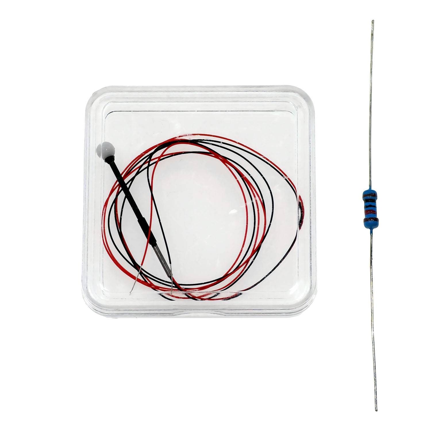

The light is equipped with 28 cm color cables with PTFE insulation. They are thick and strong enough; they do not look like human hair that is too easy to tear.

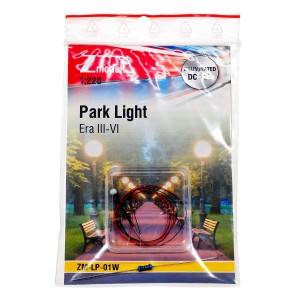

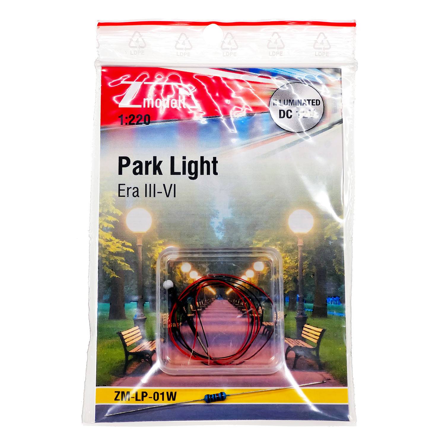

Each light comes in a small protective plastic box and supplied with 10 kΩ current-limiting resistor:
Here is a comparison of my park light with the typical product from China (claimed as “Z scale”):
I hope it is clear now why I decided to create something on my own.
Important: Do not connect the lights to AC or digital sources; please use only stabilized DC power supply. The voltage range is 8-16V DC; 12V is recommended. In case of higher power supply voltage (for example, 16-24V DC), resistor with higher value is needed (20-22 kΩ). A useful tool for calculating resistor values for LEDs is available here:
https://ledcalculator.net
Important: Please observe polarity and never connect the light directly to the power supply – it will destroy the LED immediately and void the warranty. Always use current-limiting resistor.

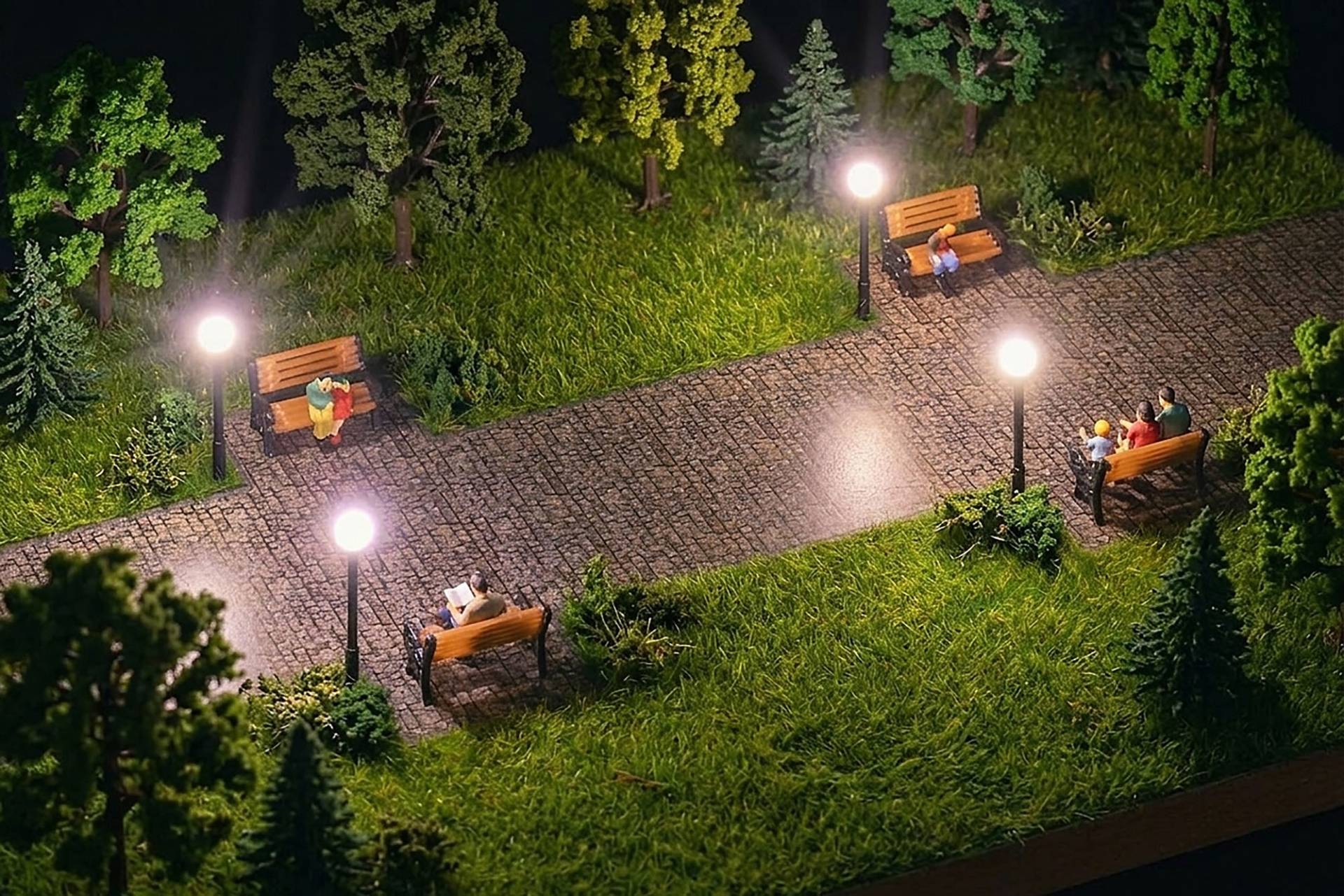

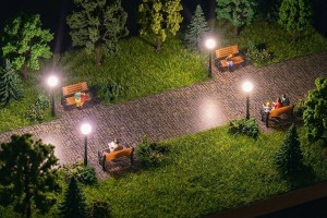

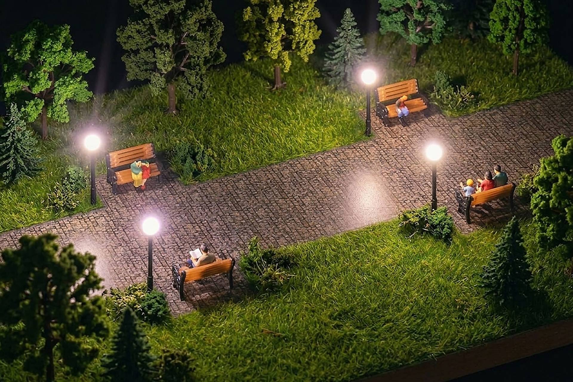

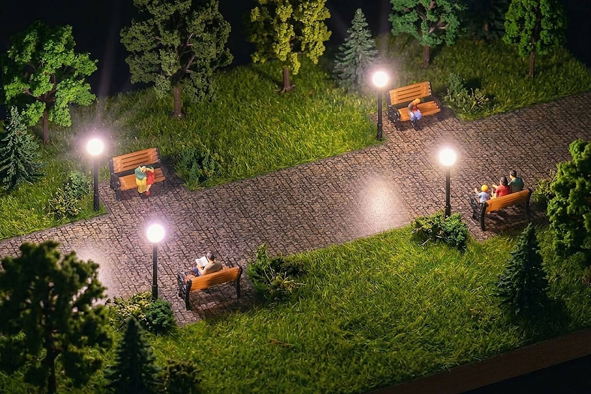

I created the small diorama to show how the new park lights look on Z scale layouts – what a cozy atmosphere is here!
Please only note that the benches are in 1:200 scale – for this reason, they may look a little bit too big.

Bahnsteigleuchten fehlen echt, seit es bei Rolfs Laedchen keine mehr gibt. Habe mir in Dortmund die von Beli-Beco fuer Spur N angesehen. Puhhh sind die riesig, also fuer Z nicht zu gebrauchen.

@Alex. Bahnsteigleuchten wären ein Traum. Wenn Du welche planen solltest, sag bitte rechtzeitg Bescheid. Bevor ich demnächst welche kaufe und mich dann ärgere, dass Du welche bringst. Dann warte ich lieber.
