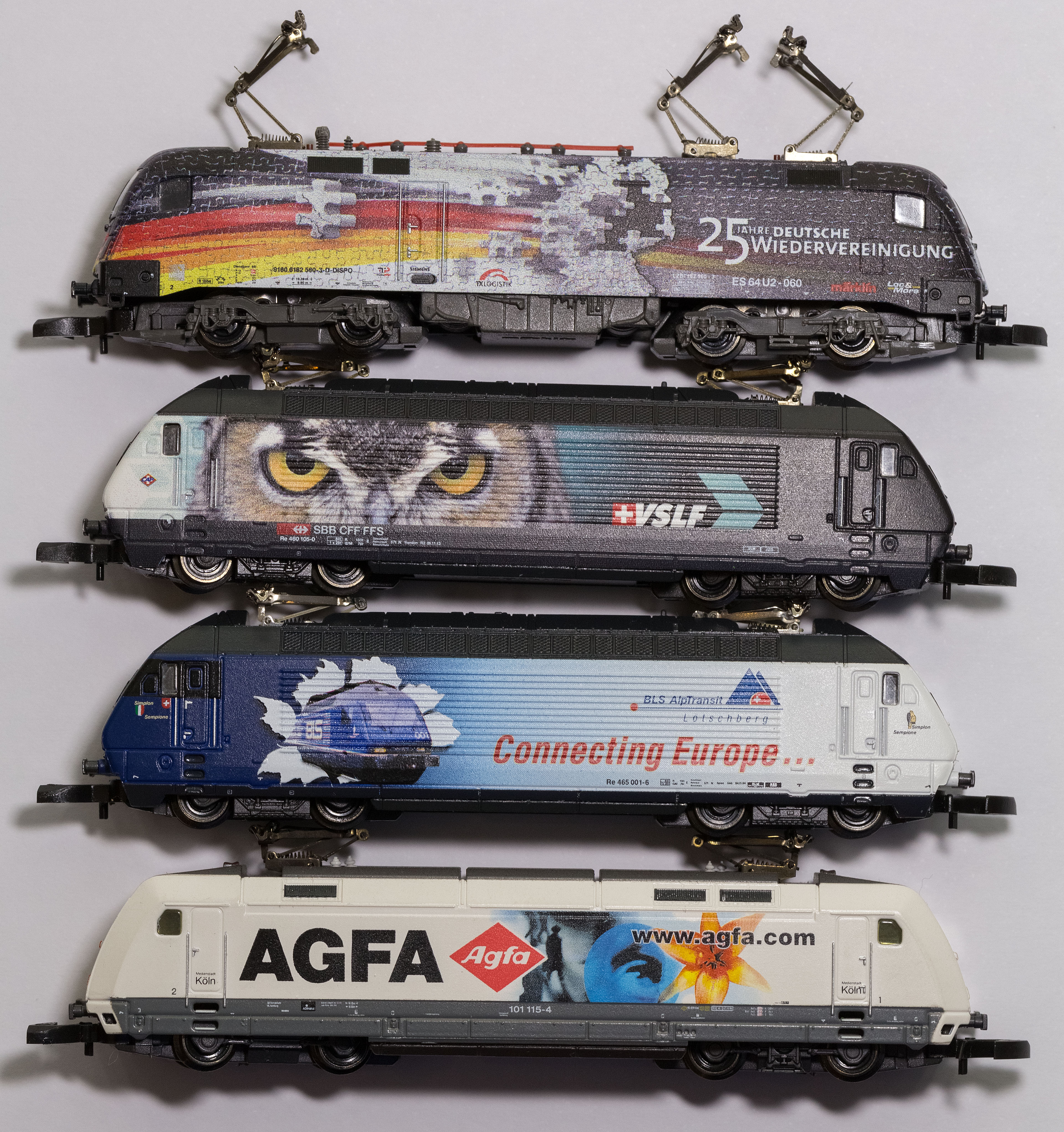

Hi all,
I will try to answer to everyone: decal foil is acceptable, however it is not the best that current technology can offer. I used decals at the very beginning for Kibri trucks that I built about 5 years ago (not that trucks that I presented here recently). I printed them on decal paper (transparent or white, depending on usage scenario) using color laser printer. Models with decals looked nice, however it was not something that is offered by major manufacturers, and I tried to find a better technology that will be affordable for small series manufacturing.
By the way, Märklin also used decals (!) for imprints on the frond cabin of their old US EMD F7 locomotives, and even for earlier versions of BR 103 (thin dark red strip around the cabin). Later they switched to a more advanced technology.
Some time ago I have found local companies that offer high resolution pad printing and UV-printing on any surface for affordable prices. My first BR 155 locomotive was printed using pad printing technology - that is what used by all manufacturers to print micro lettering on all models. BR 155 in DB Cargo color scheme was printed only with white color. Pad printing in full color becomes very expensive and potentially very complex, because you need to make for this up to five stencils for transferring dyes to the pad (CMYK + White). Making only a single stencil is quite expensive too, but still affordable. Five stencils will cost extreme money (especially considering that you have to prepare different sets of stencils for each side of the model).
Even after all stencils produced, there is another problem: to align all pad printouts very precisely at the each stage of printing (number of print stages equal to the number of colors needed). Even a smallest misalignment can spoil the whole model (which, in addition, was primed and painted before printing, which, in turn, also took a lot of time and efforts). The whole process is almost automatic at the factories like Märklin, and due to a large run each single model does not cost too much. But, as you can see, it is very expensive for home use or even for small series. Therefore, it is clear for me why, for example, models from Freudenreich and SMZ cost much more than mass produced models from Märklin (along with other price-determining factors).
There is another very interesting technology that can be used for printing models - it is UV technology. It is widely used in printing various souvenir items - pens, lighters, plastic packages and so on. It can be used in printing model trains very successfully. UV printer is actually an inkjet printer with a printing pad that can be adjusted by height, and it prints using liquid ink that is instantly cured by UV light source. UV printer also usually has two additional ink colors - white (for printing a substrate before applying color inks if color image is being printed on non-white surface), and transparent, that is used as a primer to increase adhesion of inks on complex surfaces, for example, metal.
UV printing has a number of significant advantages - ability to print on convex surfaces (with certain limitations in height), and significantly lower price of a single printout (in comparison with pad printing) that does not depend on a number of colors or the nature of what is being printed (text, graphics or photos). You don't need to etch stencils for each color, as well as there is no risk that the model will be spoiled due to a misalignment errors.
Märklin (and Trix) widely uses UV printing in their manufacturing, including Z scale. These printers can be noticed even in their promo videos. This is exactly the technology that was used to make "Touristik" train sets, as well as many other models - Deutschlandlok (88587), RE460 VSLF (88467) etc. The whole locomotive body is "unwrapped" into separate surfaces - sides, roof and cabins, and printed separately. The main task of designer and printing operator is to align printable surfaces seamlessly, without visible transitions (some of them are still visible on some models upon careful examination).
For me, obvious downside of UV-printing - is still not sufficient print resolution. It is acceptable for H0, but ink dots are very visible in N and Z scales. I made a high resolution photo of different Z scale locomotives, please download it and view at 100% or higher scale. Two upper locomotives are printed using UV-printing (randomly scattered color dots are visible), while two lower locos (they are older) are printed with high-resolution pad printing (offset raster ornament is visible). Honestly, I like older locomotives more, because they have higher printing quality:
But anyway, each technology described above is definitely way better than any decals. I use both technologies in my own models - pad printing and UV-printing. I use pad printing when I need only one color to be printed (and also for printing on cabins), and UV-printing in most other cases - for printing logos, lettering and graphics in full color without any limits.
As for very interesting Science Train - it is relatively easy to make it in Z scale. What is needed: suitable 110 locomotive (surely exists in current lineup), a donor baggage car, in which doors and windows will be removed and then it will be cast in resin and painted with basic colors (white for sides and gray for roof). Another problem is graphic design. It is very hard to re-draw everything manually, so there are two ways - to find high resolution pictures of each car (preferably, exactly from the side, without geometric distortions), or to contact the company which designed this train and ask them to provide source graphics. As far as I know, many companies collaborate with model train manufacturers for free, however there is also a part of them who want model manufacturers to pay them money and to buy a license.
Greetings,
Alex

Beitrag von Alex_dn »
Gunnar, it is one of major problems. Easy designs are easy to re-draw. Logos of many companies are available for download in vector format (and often provided by the companies itself). Such sophisticated design as one of the Science Train is really hard to re-draw from scratch. It is possible, however it will take too much time and efforts. In this specific case it's critical to get a template from original designer or company. As far as I know, that is exactly the way major train model companies go. But even if they have to pay a certain fee for using a particular design in a model, in many cases companies can afford far more than individuals.
Again, as for the Science Train, the next challenge is making of windowless coach from the baggage car. However, it is not too difficult, since I know exactly what to do and how.
