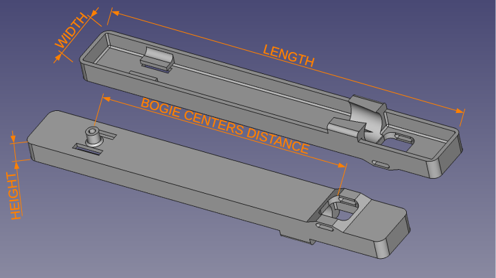

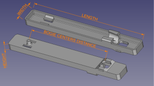

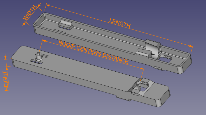

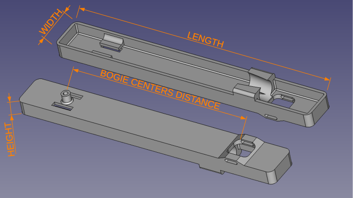

I designed a parametric model for replacing a rokuhan shorty chassis.
Given
A) the distance between bogies
B) the length of the chassis
C) the width of the chassis
D) the height of the chassis
a 3D model of the above characteristics will be generated. Once the model is printed, one has just to extract from a shorty, the motor the two bogies and the PCB and mount everything in the 3D printed chassis.
Siggi, if you send me the values A, B, C and D I can make a digital 3D model for you, which you can print/have printed.

ubiminor hat geschrieben: Di 21. Jul 2026, 00:11 I designed a parametric model for replacing a rokuhan shorty chassis.
Given
That's a really good offer. I'll send you the values.
