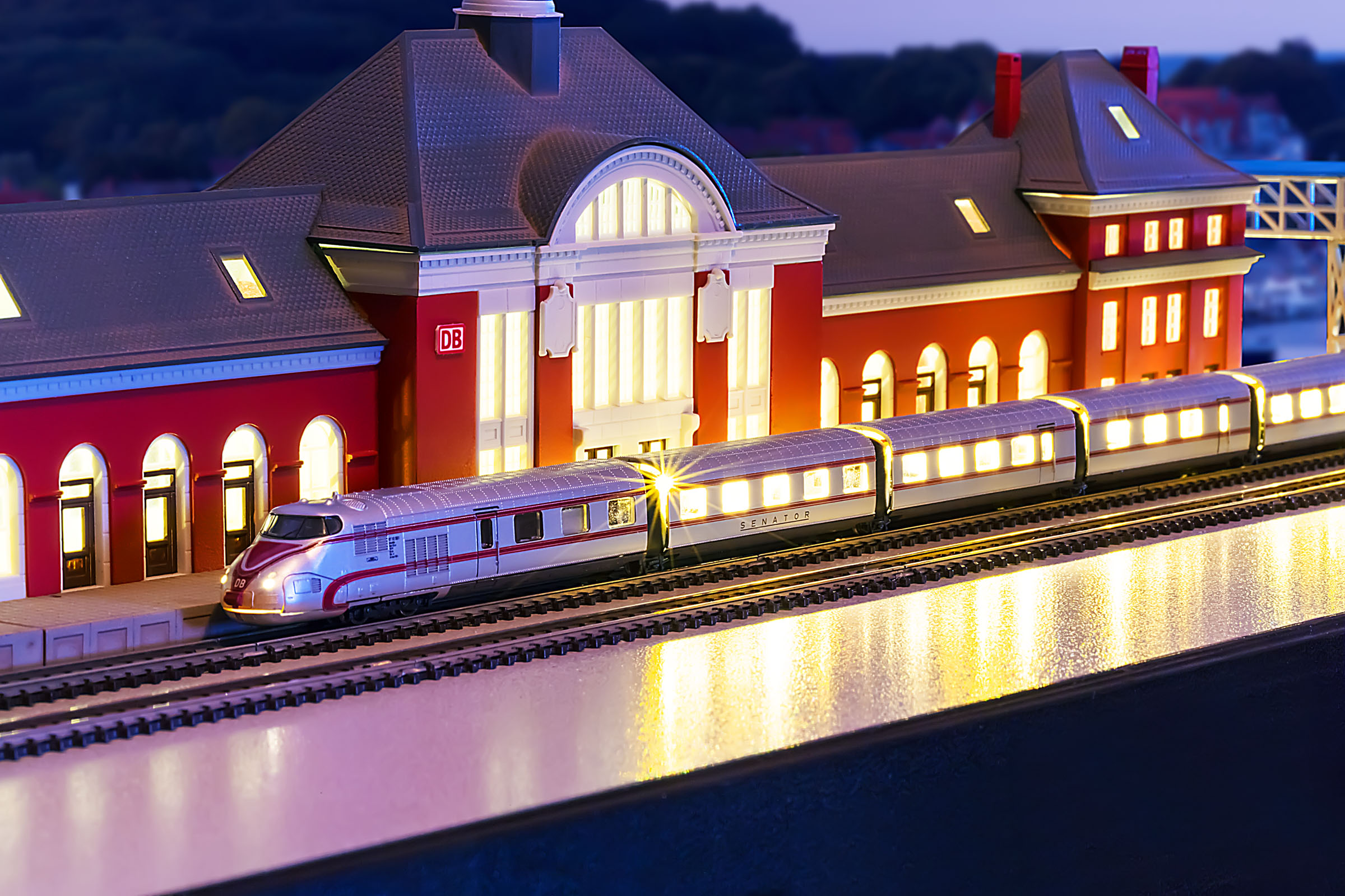

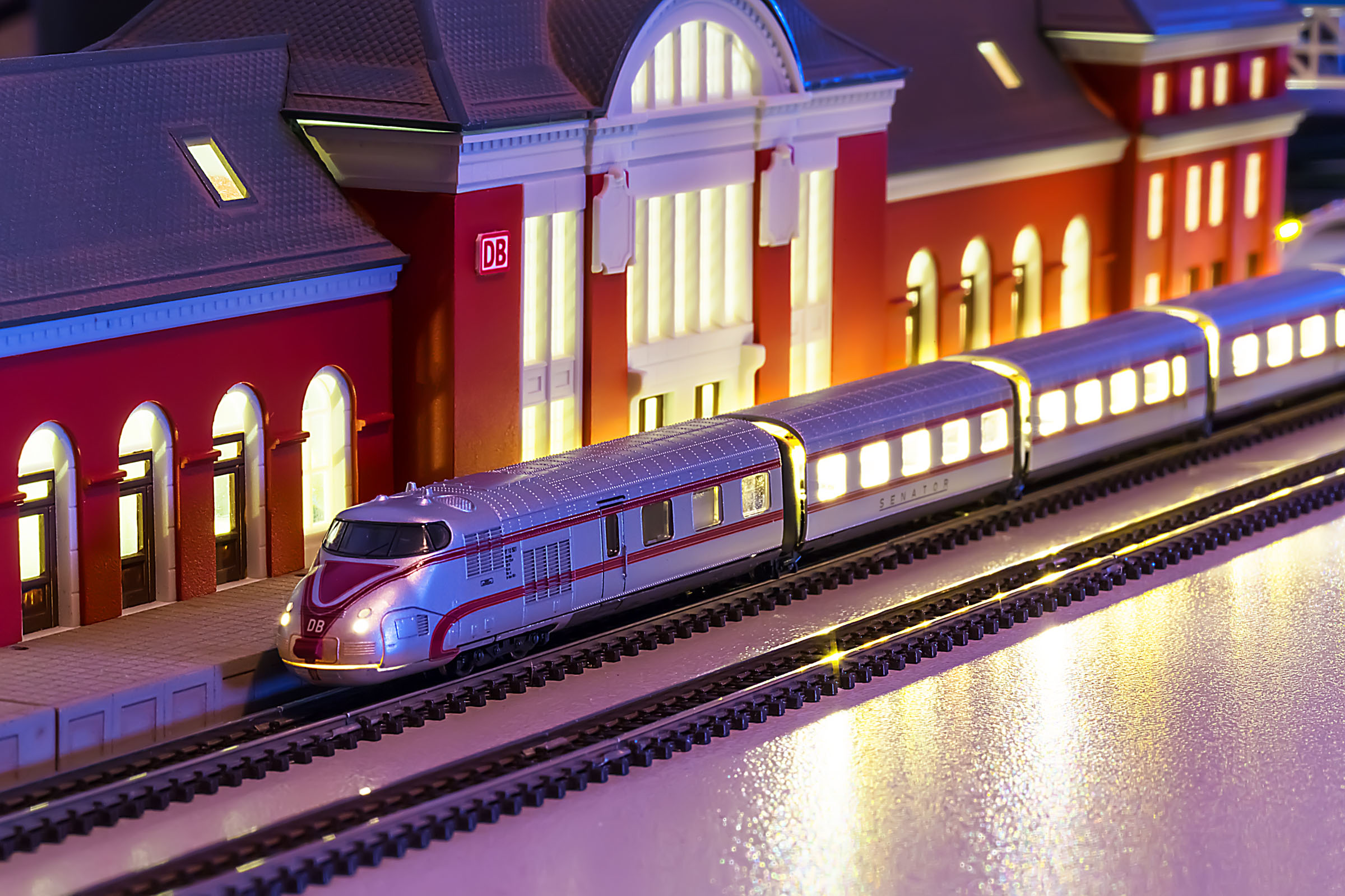

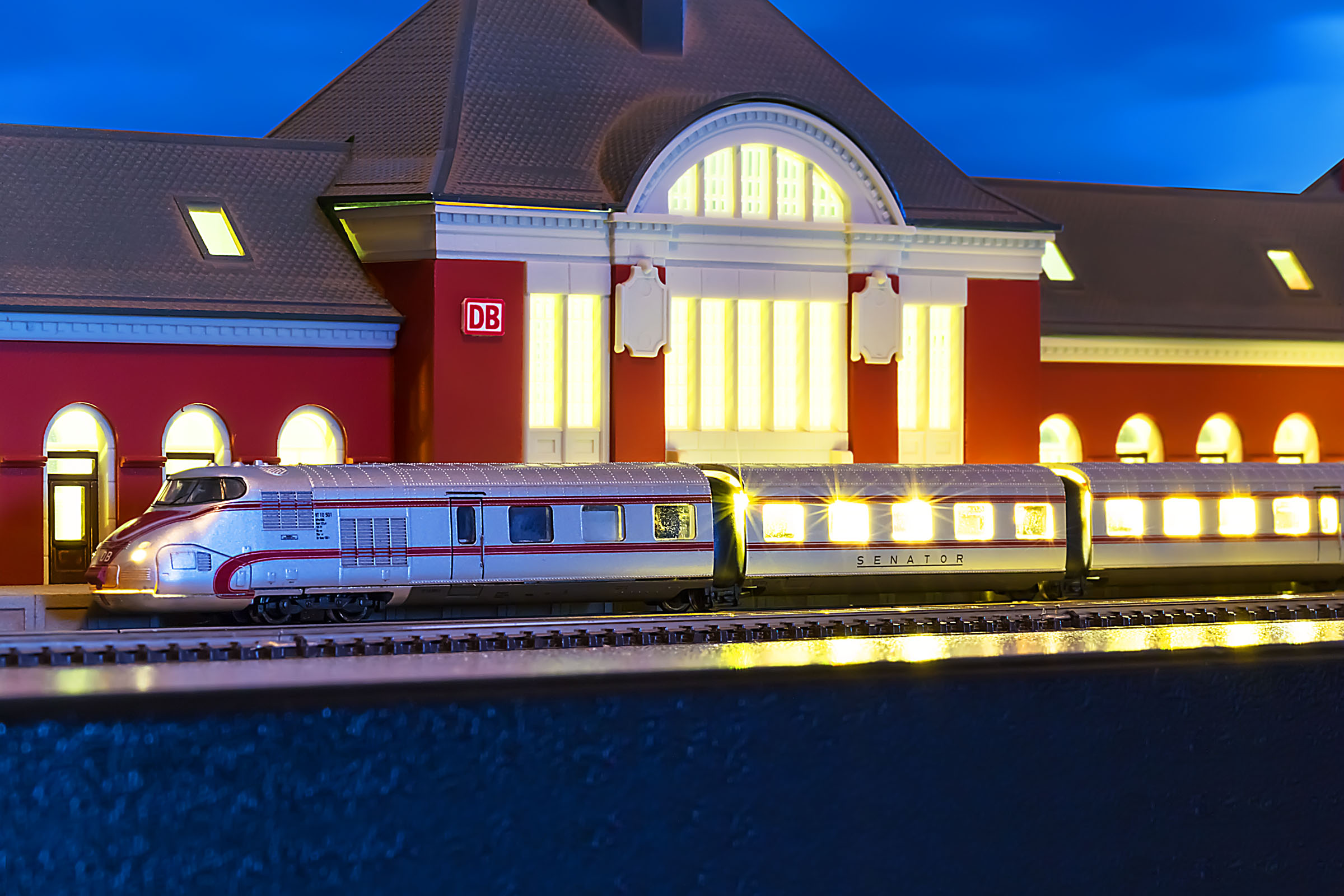

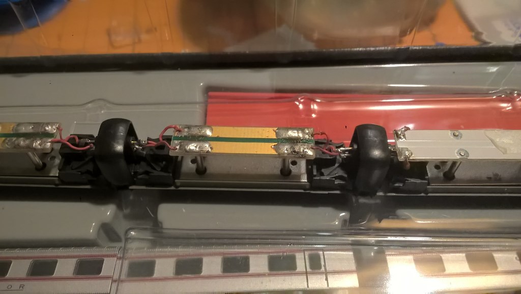

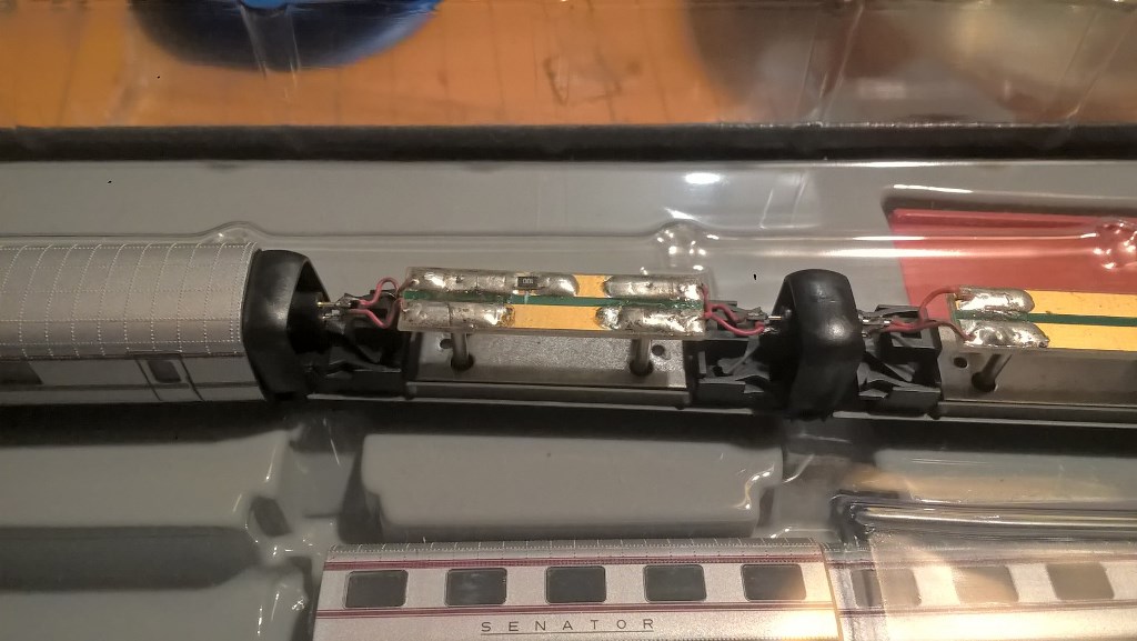

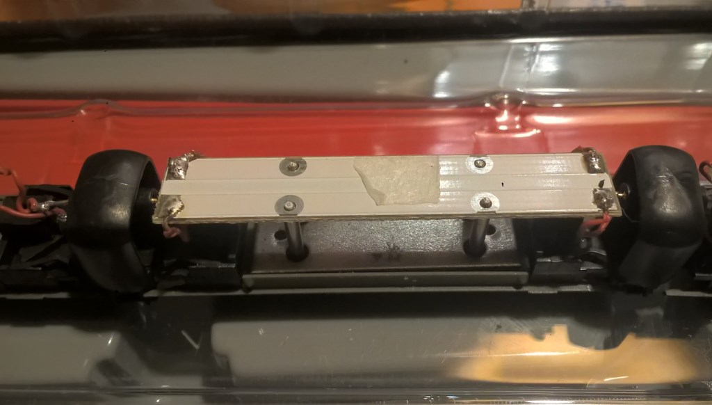

Hello friends,

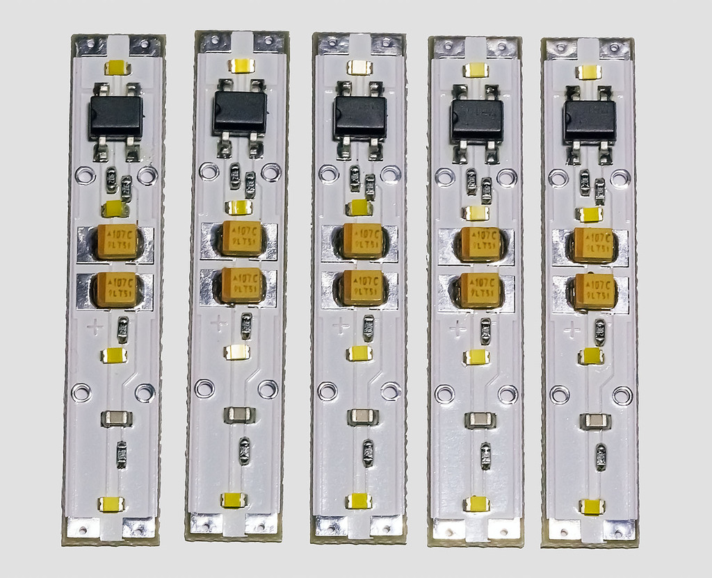

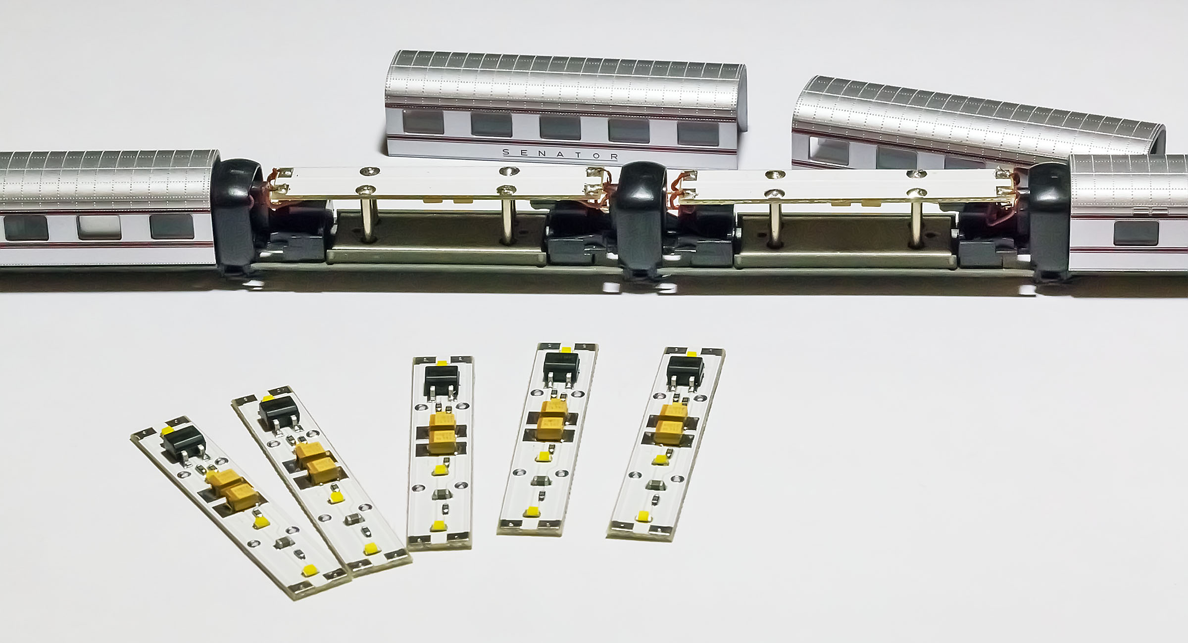

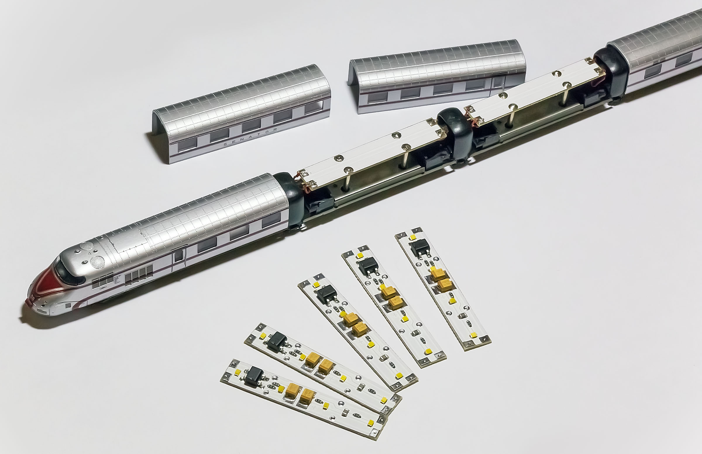

Here is another upgrade kit for Z scale - set of interior lighting boards for Märklin Z 88100 “Senator” train. It is an "exclusive" train, and it’s quite strange that Märklin refused to equip it with interior lighting like their ICE, ICE 3 and BR 601 trains, so I decided to fill this gap on my own.
These lighting boards successfully passed all tests and they work very well and Senator with interior lighting got completely different, much better look. Set of 5 boards is required for one Märklin 88100 set. Lighting boards are equipped with warm white LEDs, and also have reliable flicker-free and soft-off features.
They are also digitally compatible. They don’t have own decoders, but for example, if you want to make Märklin 88100 train set digital (decoder with auxiliary output channel needed) or if someone will make a dedicated drop-in digital decoder for this train set in future, these boards can be easily attached to it. Furthermore, boards can be installed in any direction because they are equipped with a rectifiers.

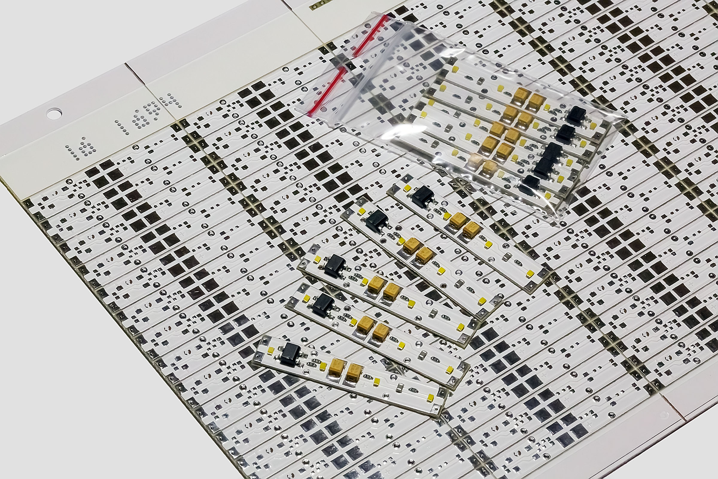

I used white PCB color (instead of “traditional” green) for better light distribution. These boards have factory quality; I’ve ordered PCBs from one of local electronic manufacturers. Some soldering work is required for installation.
Here are some technical specifications:
? Voltage working range - 0-15V AC or DC (at approx. 4-5V LEDs start to ignite)
? Power consumption - 8 mA at 10V AC or DC per one board; total consumption for the set of 5 boards - 40 mA at 10V AC or DC
? Flicker-free function
? Soft-off function
All attached photos are clickable for viewing in full size. Note: I also replaced stock yellow headlight LEDs with warm white ones in the train on these photos.

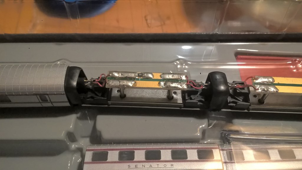

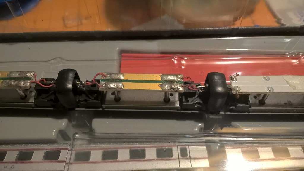

das schöne Angebot von Alex habe ich angenommen und möchte nach der Innenbeleuchtung dann natürlich auch eine Inneneinrichtung nachrüsten :) dazu dann später mal mehr...
Aber mal eine Frage in die Runde: sehen alle Platinen der SENATOR Triebwagen so aus, als hätte man bei Märklin Lötzinn im Übermaß gehabt?
Und welchen Sinn hat dieses Bauteil? Hier wurde scheinbar eine normale Platine manuell unterbrochen, um es in noch viel mehr Lötzinn einlöten zu können:

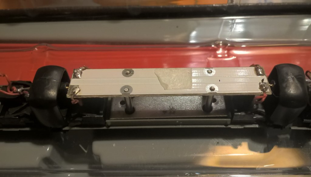

Ich habe die Platinen von Alex erstmal nur auf die Stifte aufgelegt, das hält auch:

Hallo Torsten,
bei meinem Senator sehen die Platinen auch so aus. Der Sinn des Widerstands (?) erschließt sich mir auch nicht.

Torsten83 hat geschrieben: So 13. Mai 2018, 00:38...Aber mal eine Frage in die Runde: sehen alle Platinen der SENATOR Triebwagen so aus, als hätte man bei Märklin Lötzinn im Übermaß gehabt?...
Sollte bestimmt die Fahreigenschaft verbessern...wegen Mehrgewicht. :mrgreen:
Beiträge: 7038
Hat sich bedankt: 556 Mal
Danksagung erhalten: 905 Mal
Re: Zmodell 10100 - Innenbeleuchtung für Märklin Z 88100 "Senator" zug
Danke Klaus. Dachte meiner wäre mal verbastelt wurden, dabei war er angeblich "neu aus Ladenauflösung" und nur äußerst günstig, wegen der schlechten Fahreigenschaften... wenn ich bedenke, was ich da an Ersatzteilen mittlerweile investiert habe, ist das mit dem günstigen Kauf mittlerweile mehr als relativ :?
@ Dirk: Für extra Gewicht hat Märklin überall in allen Wagen auf das eingeschweißte Gewicht noch ein Gewicht nachträglich aufgeklebt. Mehr Lötzinn könnte da wirklich auch noch zur Optimierung gedient haben ;)
Die Beleuchtung von Alex ist wirklich klasse! Das Nachleuchten ist recht kurz, aber es reicht vollkommen aus, um flackerfrei zu fahren 8-)
