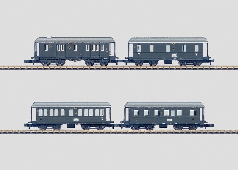

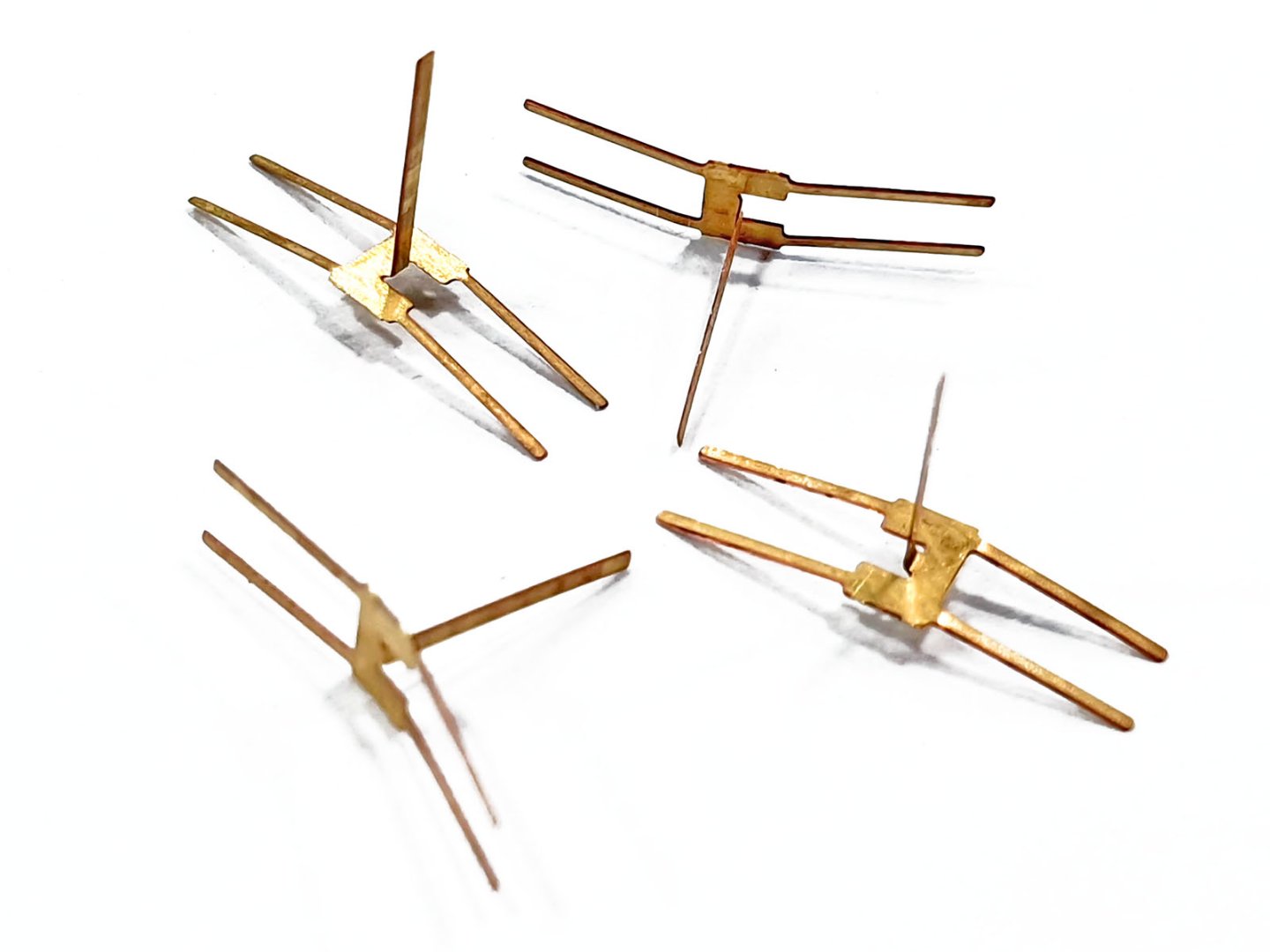

One more accessory is available now - ZM-SC-011 - sliding contacts for Märklin® 4-axle "Langenschwalbach" design passenger cars. It is the smallest 4-axle passenger cars in the whole Z scale range:
As no other kinds of wipers are suitable to such small trucks installed in these cars, I decided to develop a separate variant. Just like other wipers, these ones are made of 0.05 mm thick high-flexible photo-etched brass.
Compatible trains sets are the following - Märklin® 8119, 8768, 87681. They are available here:
https://www.1zu220-shop.de/Zmodell/Zube ... 42609.html

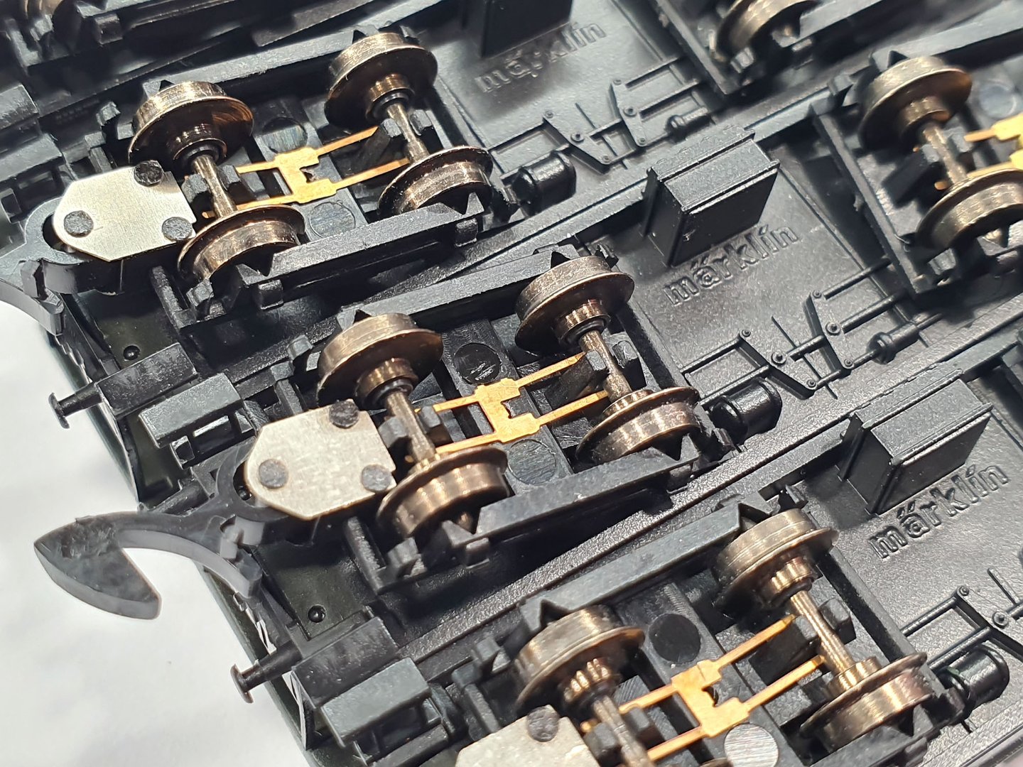

Here is a comparison of Langenschwalbach wipers with ones for standard long 4-axle passenger cars (ZM-SC-001):

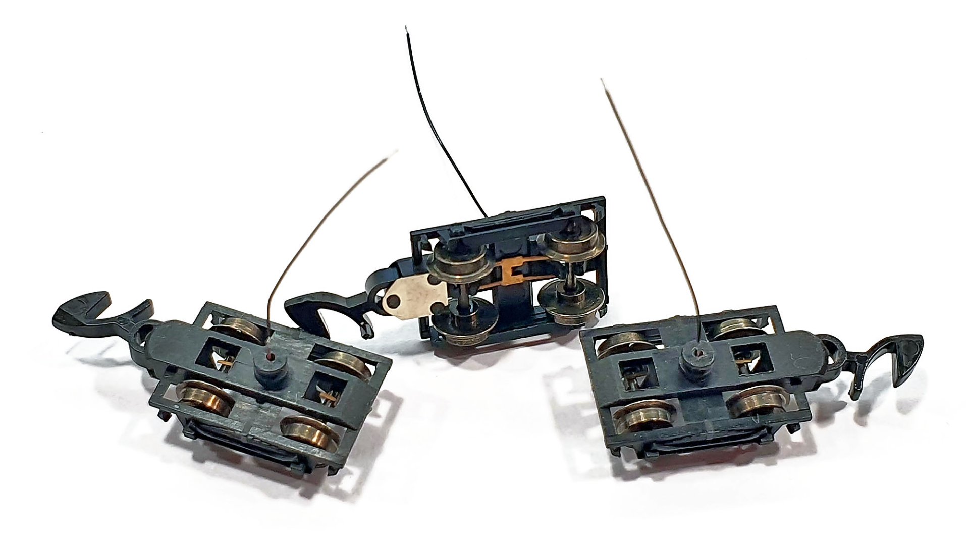

Here are some pictures with installation tips. Holes in the truck pivots should be drilled using 0.8 mm drill bit. It is important to align the hole precisely in the center:
Note: for installation of sliding contacts, metal weight insert should be carefully removed and partially isolated with pieces of adhesive tape before re-installing back again:
