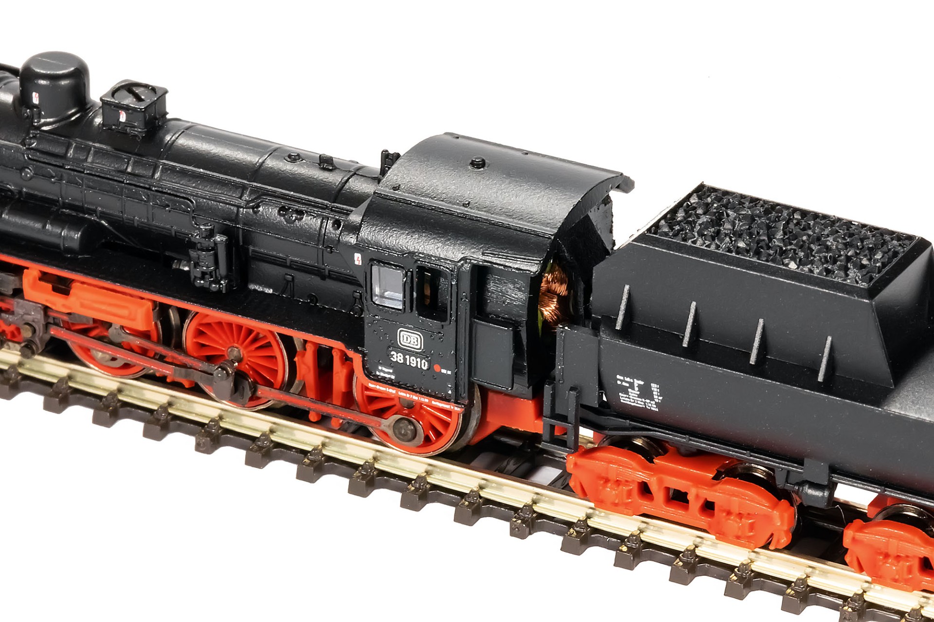

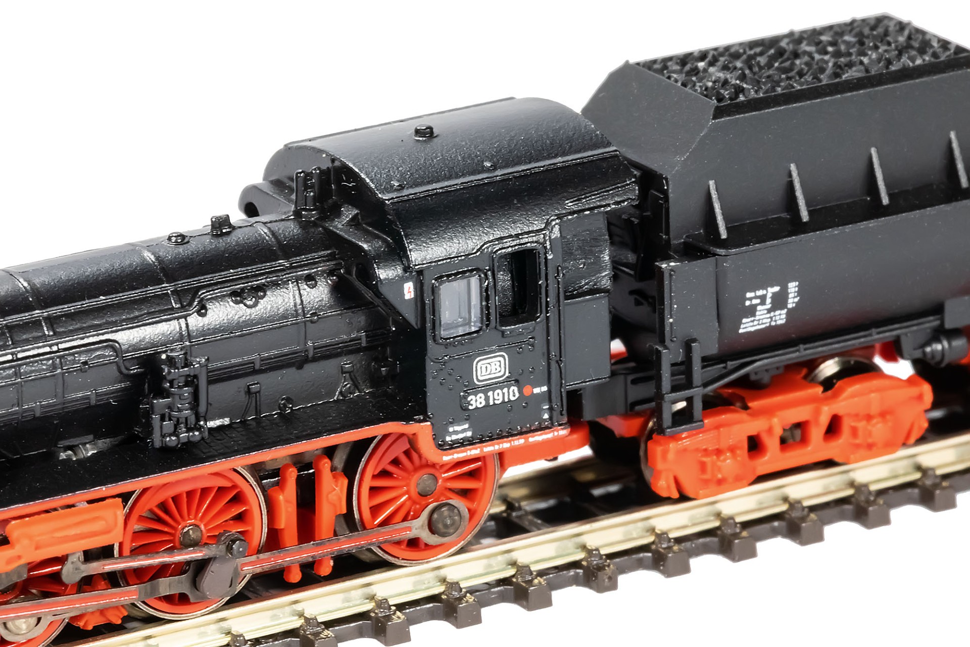

I would like to introduce a couple of new accessories that can be useful to many. For of all, I added one more variant of windows inserts - now for BR 38/P 8 steam locomotive. I don't actually know Märklin's principle which steam locomotives should feature windows glazing and which not, but in any case, I decided to fill this gap somehow.
Like similar product for BR 78 locomotive, these windows are produced on precise CNC cutter from 1.5 mm acrylic glass:
These windows inserts are compatible with the following models, equipped with both 3/5-pole motors and coreless motors: Märklin 8130, 8899, 81302, 81428, 81437, 88991, 88993, 88994, 88997, 88998 and 88999.
Installation is very easy: disassemble the locomotive and remove the metal body, pick the parts with sharp tweezers and insert them into the cab windows openings. Then fix them in place with a very small drop of glue, wait until it dries completely and then reassemble the locomotive. It is better to pick up a drop of glue with a toothpick.
I recommend using lasercut (PVA) glue due to the number of reasons: it cannot destroy plastic and paint coating. Even if something goes wrong, it can be easily removed and any time. Once it dries, it will hold these small parts very reliably.
Important note about Märklin 88993 steam locomotive: This model is manufactured using different technology that has higher dimensional tolerances. Therefore, installation of these windows inserts into this locomotive in some cases can be more difficult and may require more complex efforts and/or minor rework.
Results of this small but useful upgrade just speak for themselves:

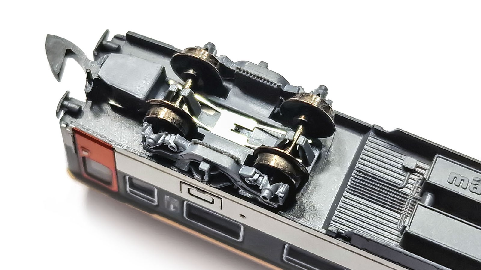

Once again, it is worth noting that photo-etching still takes place in Kiev, Ukraine - at the industrial facility with appropriate photo-etching equipment. I decided to start from the most popular variant - sliding contacts for Märklin standard IV-VI Era 4-axle passenger cars. This is a 3D illustration of the new sliding contacts:
As soon as I received new parts, I immediately decided to try them out with some of the passenger cars from my own collection. First of all, I have to say that new material is very strong and hard to cut, despite that it is very flexible at the same time. I recommend using only very sharp and strong manicure scissors for this; otherwise, the part can be accidentally "chewed up".
After cutting and very careful bending of these parts, I installed them into the bogies of SNCF passenger cars from 87408/87409 sets. Rolling tests showed absolutely wonderful results - the cars were running so freely as if there were no any sliding contacts installed at all! And of course, reliability of electric contact with the wheelsets was increased noticeably:
And here is a comparison of the new sliding contacts with previous variant made of 0.05 mm brass:
Now I have to add probably the most important point: for soldering these sliding contacts, you need a special chemically reactive flux. It is impossible to solder stainless steel with rosin or any other basic fluxes. The best flux for this purpose is phosphoric acid, also known as "soldering acid". Stainless steel is soldered with this substance just like a normal copper of brass with rosin. Soldering acid can be easily found on eBay, Amazon or anywhere else on the net.
But there is one more, also very important point: it is absolutely imperative to clean residues of the flux after soldering in order to prevent further corrosion of metal and plastic parts. Tap water either 100% IPA (Isopropyl Alcohol) can be used for this. Also, soldering acid should not be used to solder other joints like connecting cables with pads on the circuit boards etc., it should be used only for soldering stainless steel.
Although all described precautions are absolutely important and should be considered in any case, there is nothing to worry about: phosphoric acid is not strong, it is absolutely safe to use it - everything just needs to be done carefully, precisely and quickly.
